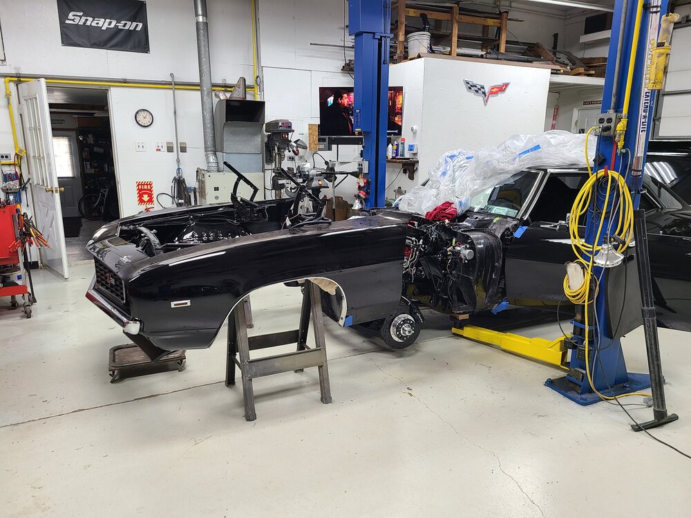

jft69z Posted August 9, 2022 Author Posted August 9, 2022 Moving along slowly, but hope to get it looking like a car again at some point soon. Tied up a bunch of loose ends recently. Had the gas tank in and out multiple times for a bad sending unit signal. Had to pull the tank apart because Aeromotive doesn't have any to send as a warranty replacement. They did send new gaskets, screws & seals pretty quickly though. Still not amused though. Loaded up the base tune, set the fuel pressure, synced the electronic distributor, ran the heater hoses (with Gates shrink wrap hose clamps as usual), put the seats inside, played with the Dakota Digital displays a bit more, & numerous other details. Tried to get as much done while I have open access, but know there will be a bunch of other things to tie up after it's together. 5 Quote
jft69z Posted August 9, 2022 Author Posted August 9, 2022 Good thing I hooked up the cherry picker. Removal was a lot easier, because the front suspension was completely removed at the time. I was going to try installing it myself, before my buddies came over, but no way it would have worked. Even with the rigging, it was still a puzzle to get it over the suspension and around the cowl with 3 of us. It took a few different attempts at sliding it in there different ways, and certainly would have ended in disaster if we didn't have the crane taking most of the awkward weight. Removing one of the inner fender wells was the next option, but not high on the list of things I wanted to do. 5 Quote
