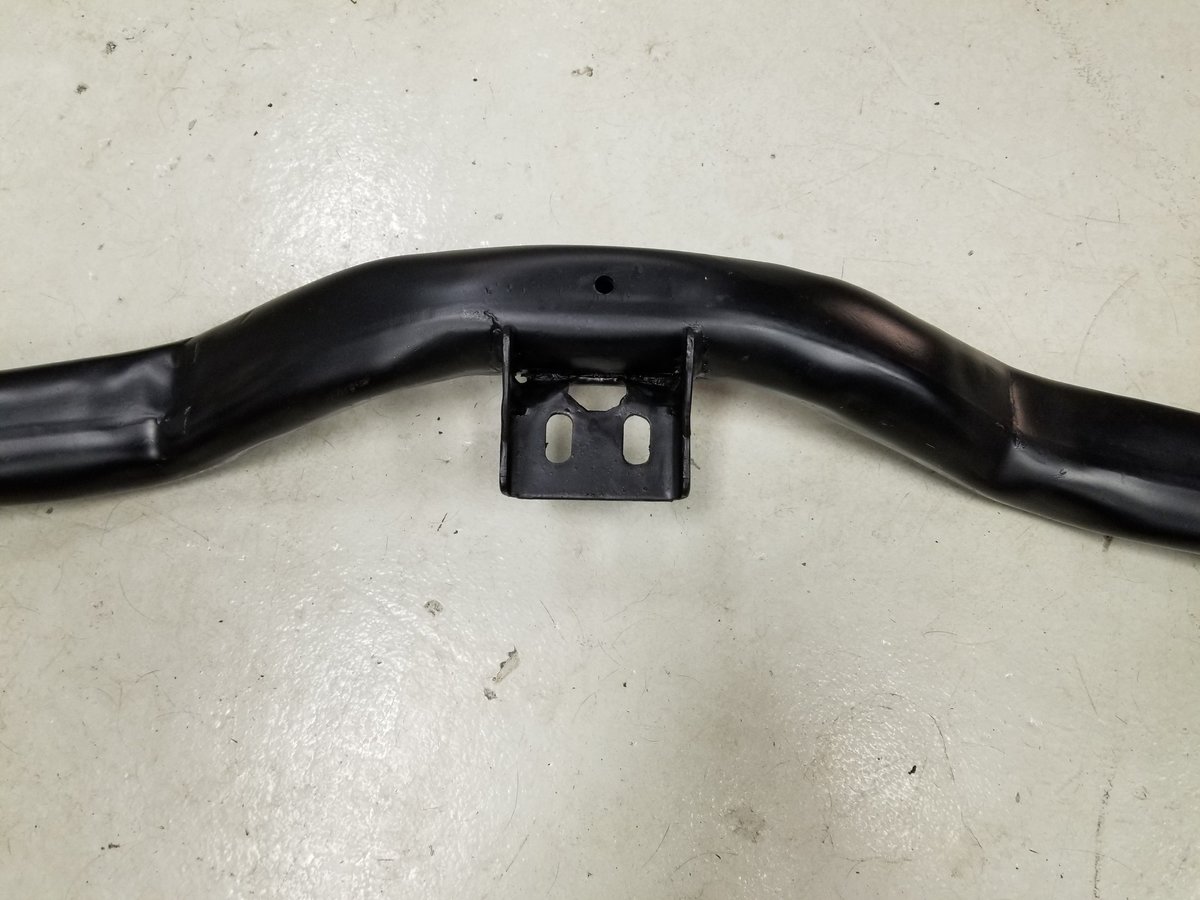

Getting ready to start figuring out the rear crossmember situation. A few quick measurements looks like the 4L85E may just barely work with the stock crossmember with just a minor cut/paste of the mount tab. Will know more when I get it in place. That big orange ugly machine in the background is why it wasn't going to happen tonight. Snowed a bunch today and supposed to go all night. I'll be up at 3:30 AM plowing snow before work (good thing I got the plow blade out of the shed last week). 7-11 inches of snow....why did I not move out west when I got out of the USAF years ago....

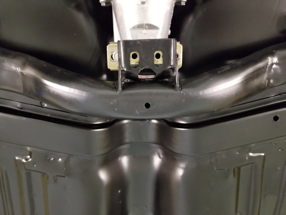

Popped the body on the frame real quick to see how the actual transmission is going to fit in the car.  Did a lot of research, seems the popular answer to putting one in an A-body is to use the G-Force RCAE-4 crossmember, plus a 'short' urethane trans mount, compared to a taller/stock height one. Kept looking at the pics of their part and it just seemed like it drops the trans down a lot. Took a bunch of measurements with an angle gauge the other night & it really would have made for a poor pinion angle I think (I pulled the rear springs out so I could manipulate the rear diff thru its full range of motion too).
So I called them up, turns out their member drops the back of the trans approx. 11/16" compared to a stock crossmember. Add to that the difference between a T400 vs 4L85E trans mount to centerline of output shaft of approx. 3/8" (4L85 distance is shorter, dropping the trans down even more). That drops the trans over an inch, plus the shorter trans mount they suggest, no way that would work & still have an acceptable drive angle for the U-joints.
I think I'm going to use the stock crossmember, add a little metal to slot the mounting grooves a bit more towards the back, and use the stock sized rear mount plus shim it up to make up the difference between the mount pads. So far, with it in the car mocked up like that, it clears the floor & puts the driveline angles where they're supposed to be. Just something to consider if someone is thinking about this swap. I'll take pics of the crossmember down the road after I modify it (you can see where I already cut the pad a little to add a square piece so I can elongate the bolt slots).

Spent a little time after work adjusting the crossmember mount to fit properly. Cut about an inch out of it just behind the slots. This also provided just enough clearance to allow removal of the crossmember when needed. It's a tight fit otherwise, and would hit the trans oil pan and not let you remove it easily.
Also added a couple of tabs on the ends because with this trans, the crossmember needs to go to the furthest rear holes on the frame. Didn't want to use just 1 bolt on each side, so the added tabs will let me use 4 bolts total with the existing frame holes.

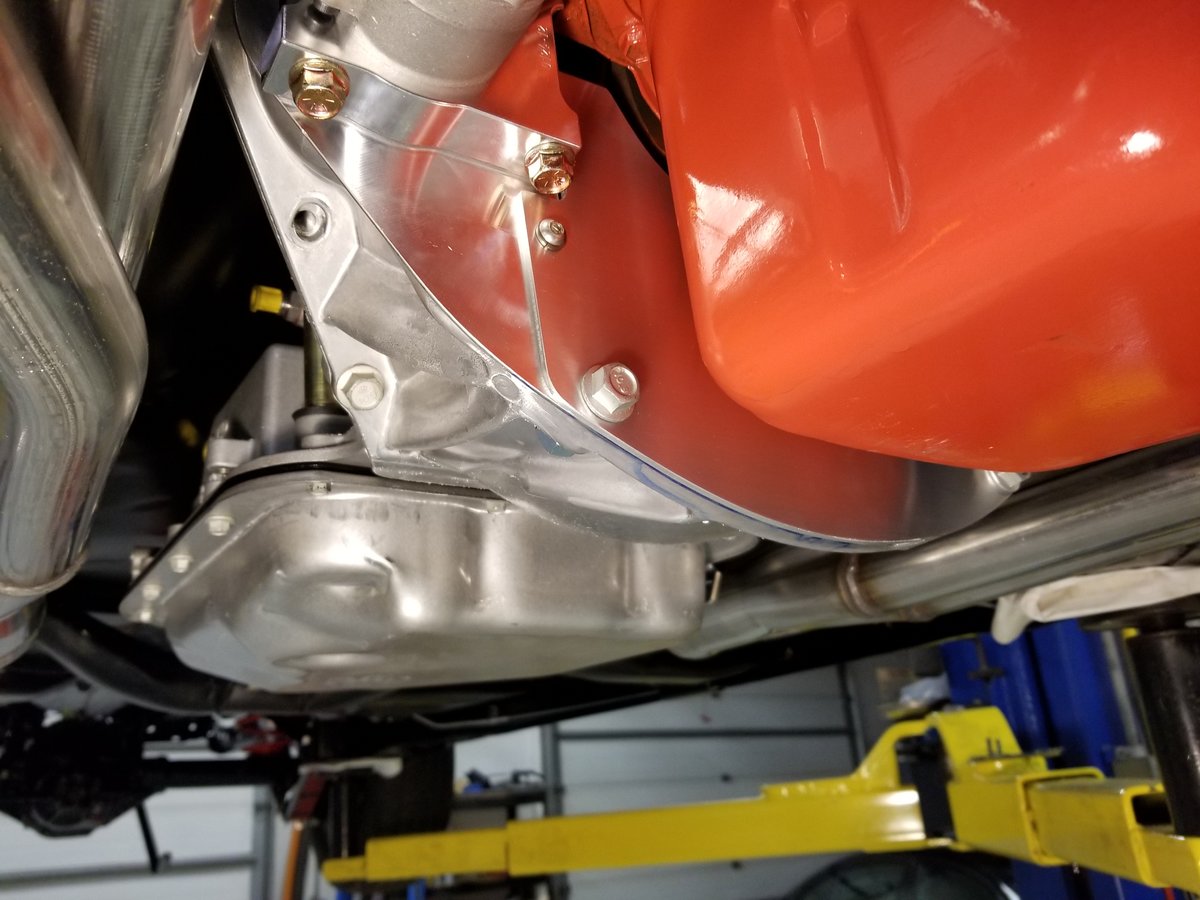

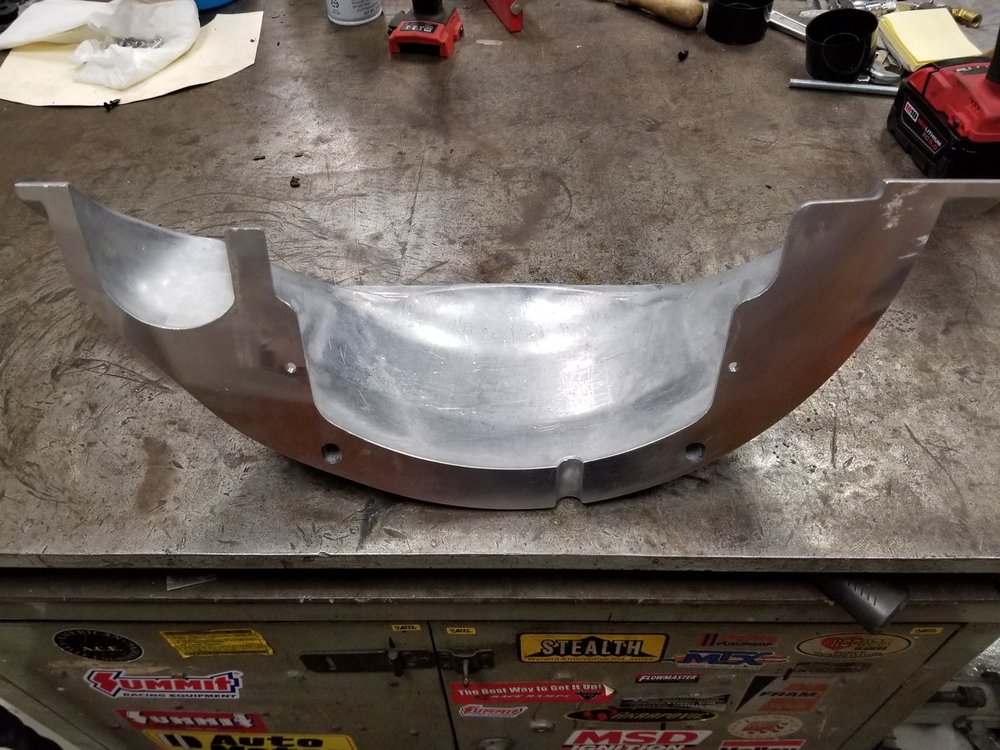

Since then it's been small stuff, but things I wanted to do before wiring the car. First was finishing the trans related stuff like making a plate for the torque converter. The cast piece GM makes for the 4L85 has no provision to cover the big hole up, basically leaving the flexplate very exposed, so I made a cover real quick with 1/8" aluminum plate.

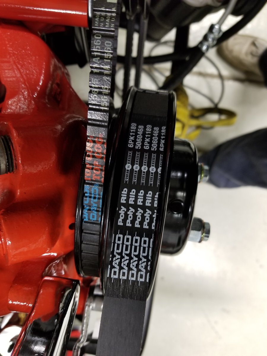

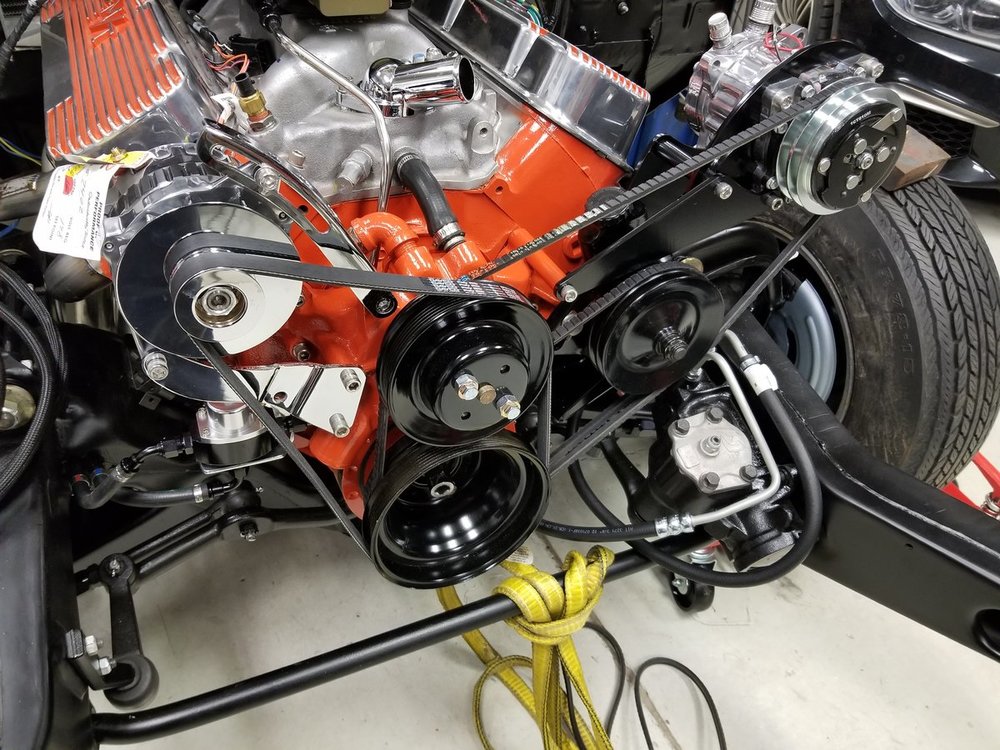

- Next was figuring out the fan belt situation for the Alt, WP & A/C. I have the mid-80's GM 454 pulleys that are a combination "V" and Ribbed (serpentine) belt. I have these pulleys on my Camaro and they stopped the tossed alternator belt problem dead in it's tracks. Also have the "Classic Auto Air" stage 3 A/C system so needed to figure that all out as far as belts. Went with the Dayco 'Top Cog' belts as they seemed to work good in the past to keep belts on, when others wouldn't stay put. The GM part numbers for the crank & WP pulleys are: 14087537 & 14087536 if anyone is interested. Hard to find though, ebay is the best bet.

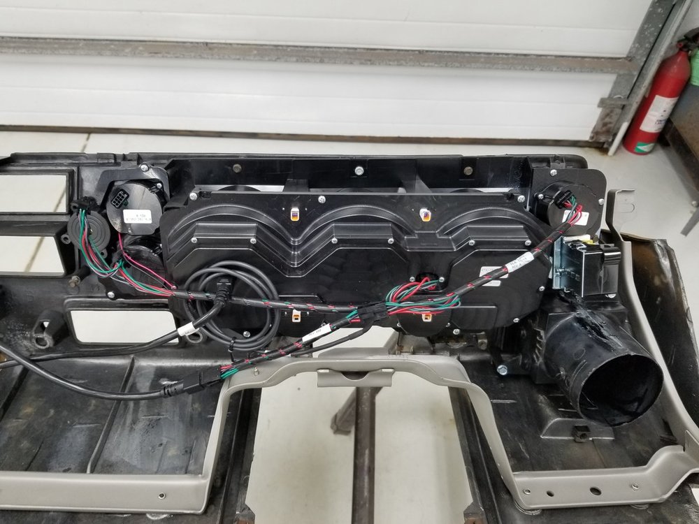

Still plugging away at the wiring and multiple items at once this past month. Managed to get the dash & console assemblies apart, painted and put back together. Wanted to get that done before starting the wiring. Managed to find some 'Liquid Chrome' paint to do the trim outline around the dash (Molotow brand, got it all from Amazon). Used the 'pen' style for the gauge surrounds and airbrushed the main perimeter of the dash itself.Also got the Dakota Digital pod installed.

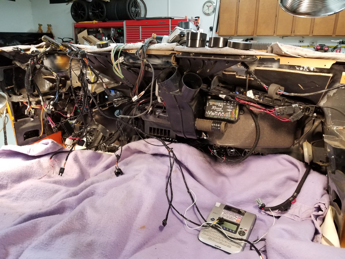

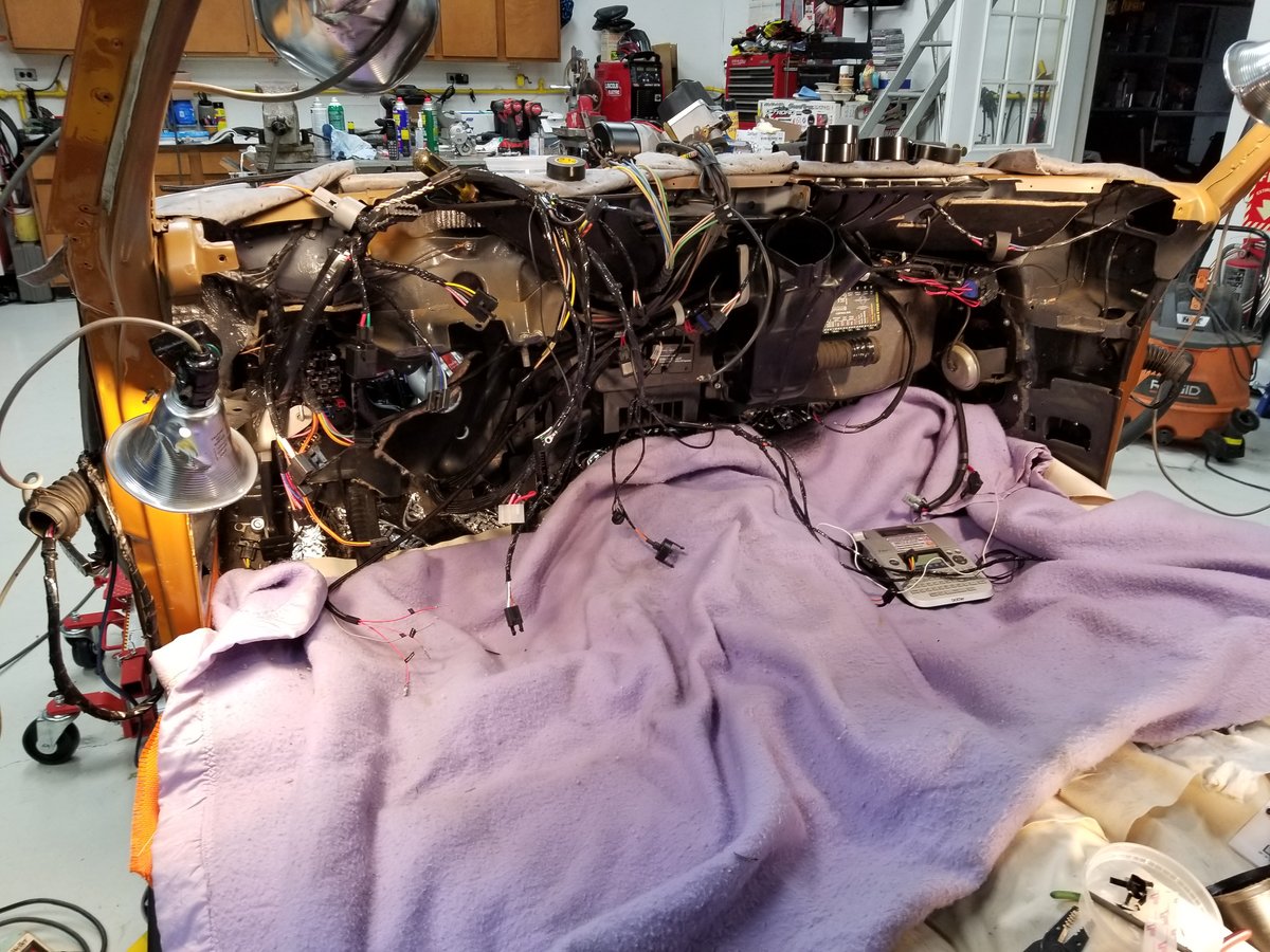

Also got the HVAC units back together and bolted to the firewall. Countless other details, parts to be made or modified along the way that just takes boatloads of time. Then it was on to the wiring. Using the AAW 50336 kit to get it done, but also modded that a bit here and there to suit my need to interface with the numerous other harness associated with the Holley Terminator FI, transmission control, Dakota Digital dash, and the D/D interface module that talks to the Holley FI.

So many wires to keep track of, figured I better label stuff so it'll be easier down the road. All the different modules want a couple sources of power, multiple signals, etc. It's going to be hard enough to remember in a month, let alone a couple of years.
