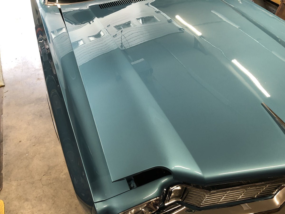

420ponies Posted July 11, 2020 Posted July 11, 2020 Joe, I think you will find that Leo looks at all his stuff Before he ships them out. Enough said. And I hate the 2 step thing also. I put new Eddie Motorsport hood hinges on mine before the meet and now one side pooped and my hood is all sideways on the car Quote
jft69z Posted July 11, 2020 Author Posted July 11, 2020 34 minutes ago, 420ponies said: Joe, I think you will find that Leo looks at all his stuff Before he ships them out. Enough said. And I hate the 2 step thing also. I put new Eddie Motorsport hood hinges on mine before the meet and now one side pooped and my hood is all sideways on the car Oh wow! I remember looking at those hinges at the show. It didn't scratch the paint anywhere, did it? Quote
420ponies Posted July 11, 2020 Posted July 11, 2020 NOT YET!! It happened as I was going to close it. I heard a "pop" and that"s what happened. surprisingly I can close just like the pictures and nothing happens. It's in the up position(with moving blankets all over the car) until They get a hold of me. No response yet to my email and it's been a week so far. The brackets are not bent, Can't believe that. I'm hoping to call them if no answer this week. Quote
jft69z Posted July 11, 2020 Author Posted July 11, 2020 Damn, that's just scary. If it was me, it would have ruined the hood, both fenders, crack the windshield and find a way to ruin the trunk lid too, lol 1 Quote

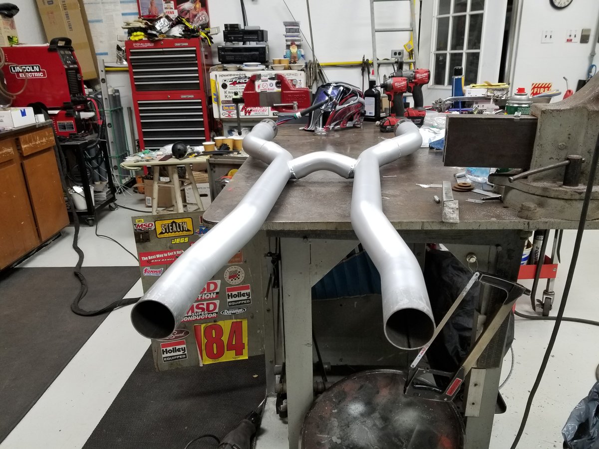

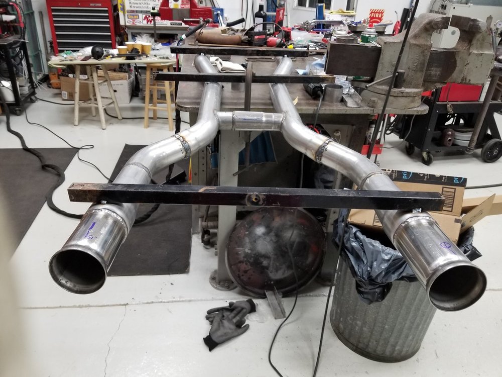

jft69z Posted July 12, 2020 Author Posted July 12, 2020 Been working on the exhaust a couple of hours a day (after working the last 4 nightshifts). Got everything welded on the H-pipe and fitted pretty tight up under the car. The Flowmaster H-pipe section was going to hit the driveshaft though (currently getting made locally at Denny's Driveshaft). Found a nice piece of curved pipe in the attic from a Corvette job I did years ago and zipped it on after bracing up the pipes to keep them from moving around. One step closer to firing this thing up soon now that the exhaust is basically done. Will need to fine tune it a little when the rear bumper is in permanently, but this will be good enough for now. 1 Quote

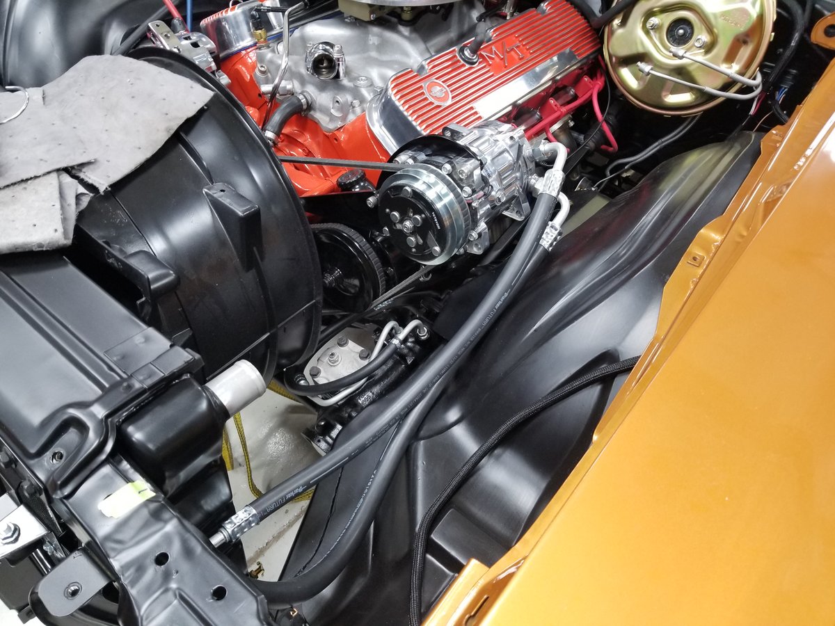

jft69z Posted July 14, 2020 Author Posted July 14, 2020 Put the fenders & wheelhouses' on real quick to run the A/C lines. Got them all cut to length & crimped the ends on. Pulling a vacuum and it looks good so far. Plan to run the heater hoses behind the fender to clean it up a little, but that's still up for debate. Finished running the exhaust, will tweak the tail pipe length when I get the bumper mounted permanent, but it's pretty darn close right now. Powered up the car with a jump box the other night to check out the wiring job. No issues at all, everything worked and didn't make any smoke . Also played around with the Dakota dash for a few minutes, but it was late and called it quits. I'll run the hoses, battery cables, etc then power up the ECM and start programming that soon. Hope to maybe have it running in the near future. Plan to pop the fenders back off for that, just a couple of bolts and it'll be a lot easier to check things out. Things like setting the distributor with the ECM, adjusting the fuel pressure, check for leaks, etc. Almost starting to resemble a car again. 3 Quote

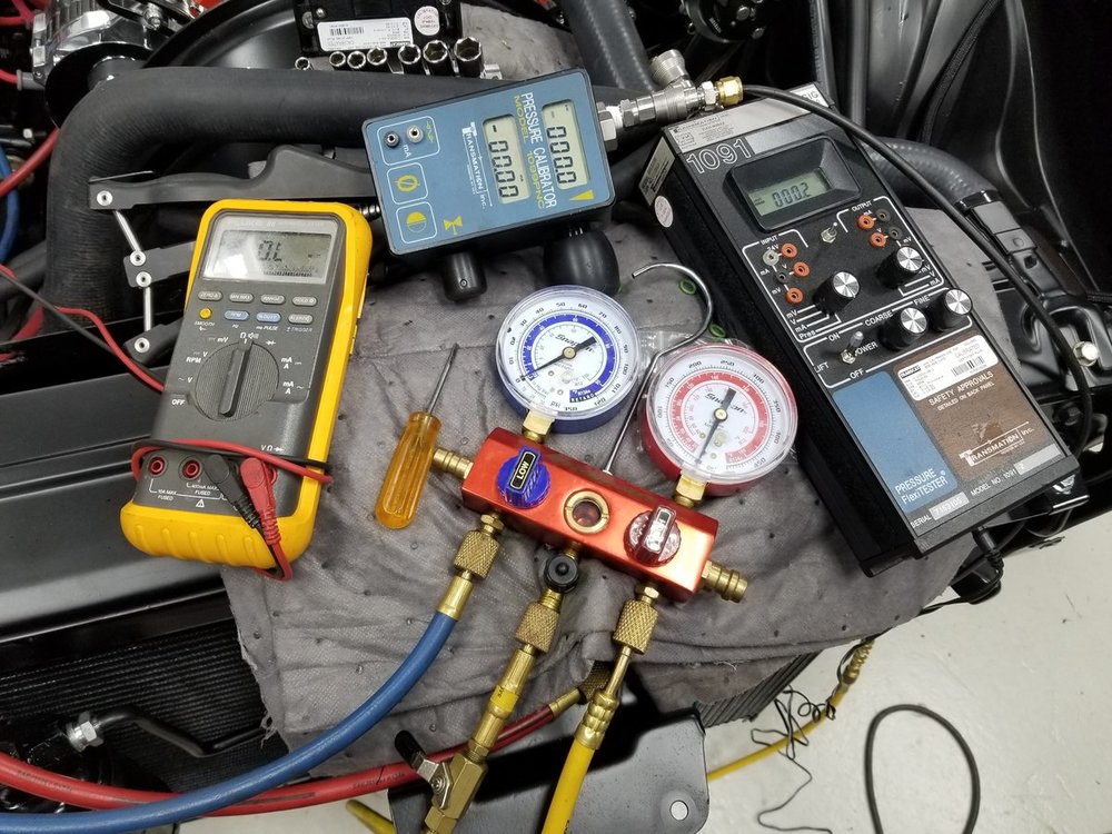

jft69z Posted July 15, 2020 Author Posted July 15, 2020 Yes Rob, it is a lot of work. Luckily I have a girlfriend that is really cool about it. Yeah Steve, I talked to you a few times during the weekend, lol. So, true to form it looks like the A/C Clutch cycling switch may be bad. Can't seem to adjust it to 21 psi on falling pressure. It's either 23.5 psi or it won't shut off at all on the adjustment. My prior life as an Instrument Tech won't let me accept a couple of pounds off on the calibration, lol. A couple of test instruments from that career came in handy today. Also calibrated the Snap-On gauge set while I was at it (both gauges were off a few pounds). Looks like a call to Classic Auto Air in the morning to get a new one sent out. Typical. 1 Quote
