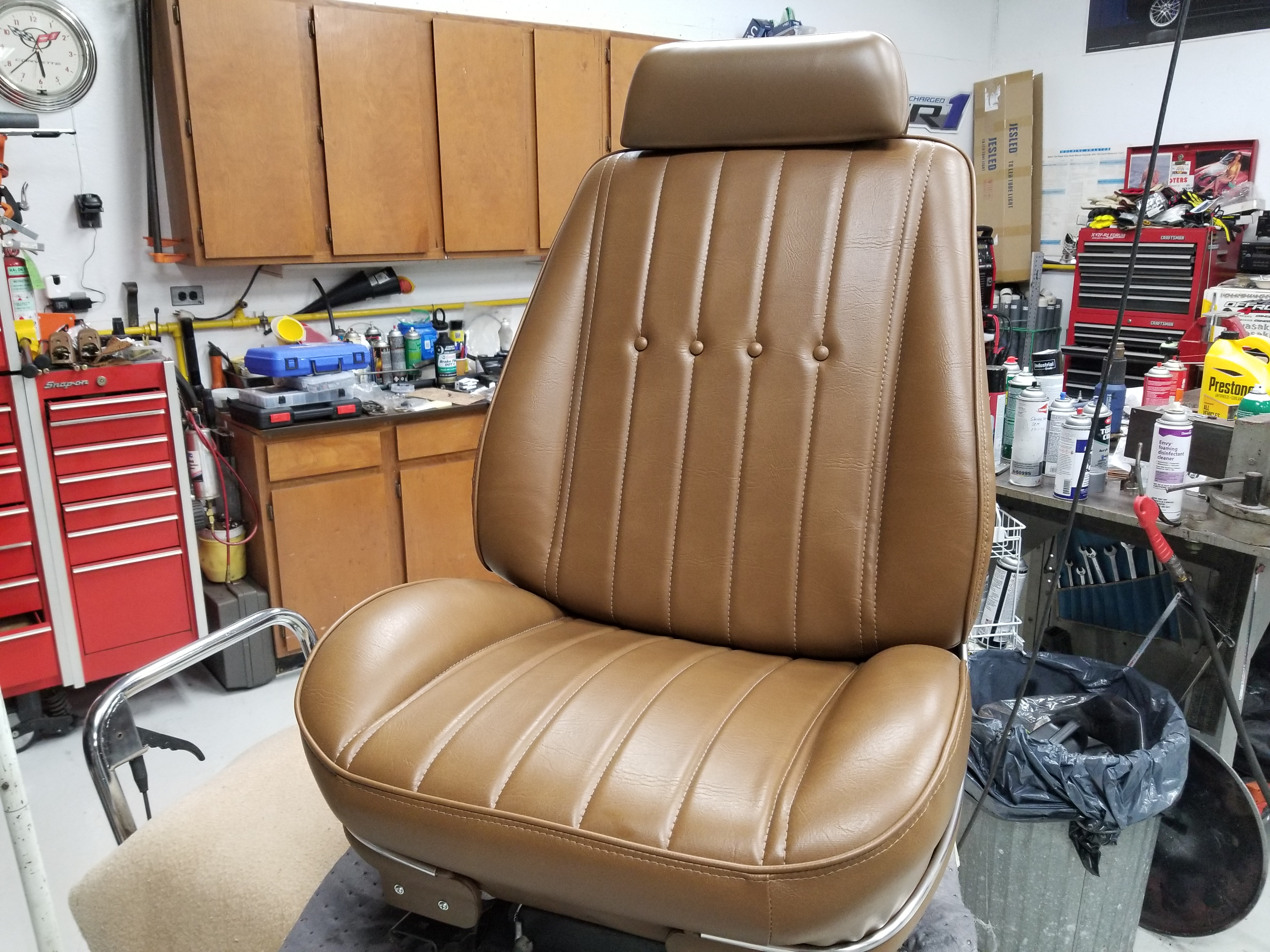

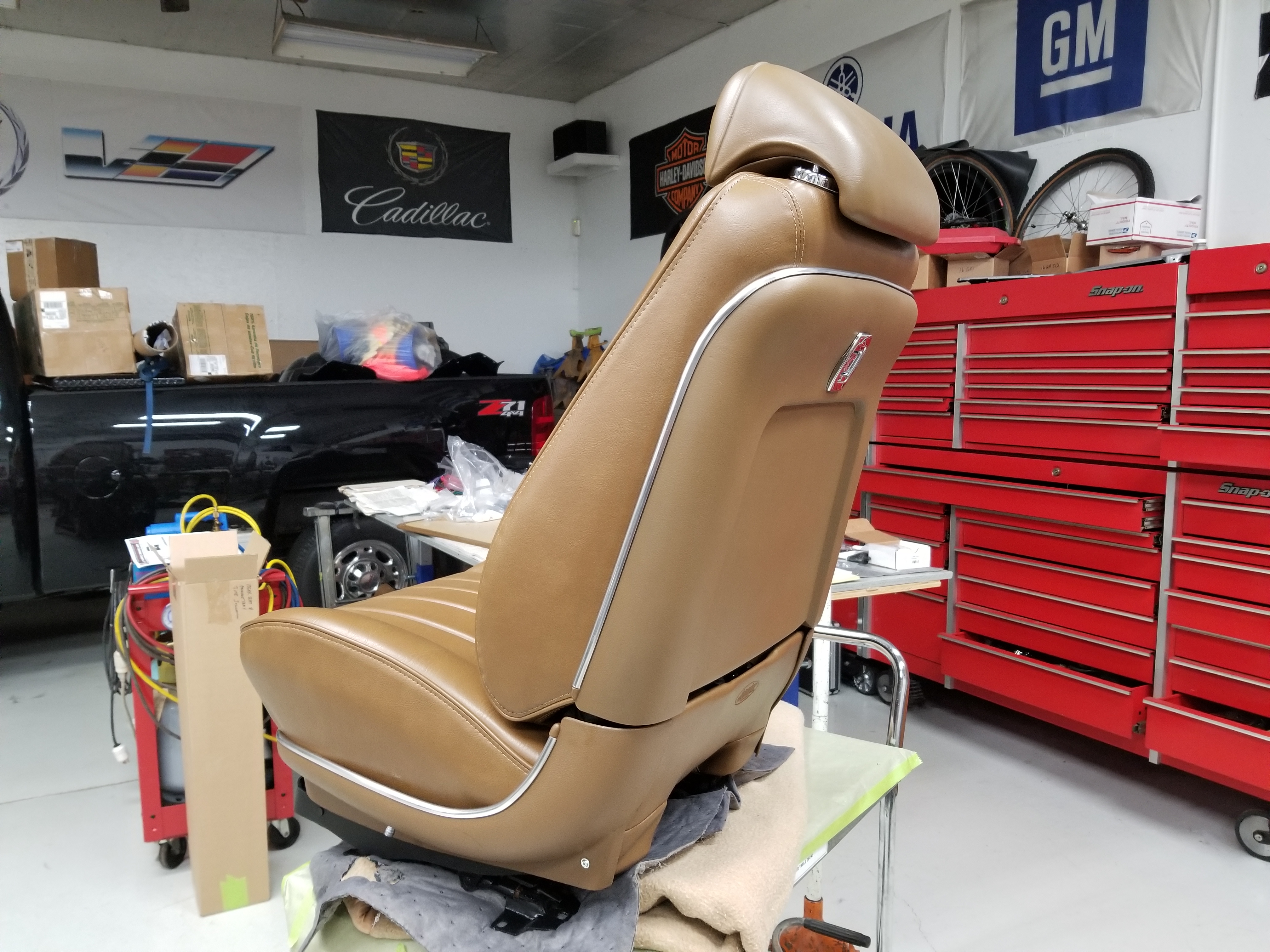

jft69z Posted September 18, 2020 Author Posted September 18, 2020 Been plugging along. Put the front seats together (side and back panels, seat tracks, etc). The chrome piping came from Ames Pontiac parts and fit great. The other ones I got from Legendary & available elsewhere are too small & don't fit good. These replicate the factory ones perfectly. These are the 'Rally' seat covers that Legendary offers, with a little more bolster on the bottom & sides. Pretty subtle, but definitely more comfortable, at least to me it seems that way. Got the windows & trim installed, the engine is back in and running, the bulk of the interior is installed now except the dash pad, front door panels and bolting the front seats down. Got rear bumper & trunk lid on too. Got the driveshaft installed and ran thru the gears, all appears to work with the transmission so far (at least on the lift). During the trans test, noticed issues with the brakes holding and turned out to be a bad proportioning valve (it was new). Also, the repop 'Delco Moraine' booster unit just isn't providing enough power assist. Called them up & they're sending a replacement one, but that's on a slow boat from China apparently, will be at least a month away. Also getting an OEM brake booster made from an outfit in California that deals with these. He's fully aware of what's needed for the vacuum requirement of the LS6, and has a bunch of them out there that work great. Maybe the repop ones just aren't designed to work that low? (15 in hg at idle) I used the vacuum pump for my A/C work and the more vacuum I applied to the booster, the more pressure at the wheels recorded (used the SnapOn brake pressure test kit to monitor front & rear pressures). Got the rest of chrome back yesterday & it looks great. Buffed out the trunk & front fenders and will be putting the front end together in the next week or so. Also put a different starter on today, a GM Perf parts unit that Mark has on his 502 crate motor. Turns out that spins the motor the fastest and plays best with the fuel injection & dual sync distributor to get the sync signal to initiate spark. Thanks for the part number Mark! Pics of the back seat/ rear interior are in the other camera. Had a little helper before putting the windshield in too. 5 Quote
Leghome Posted September 18, 2020 Posted September 18, 2020 You will really like the bolsters. I put them in my 72 when I redid my interior. Much more comfortable 1 Quote

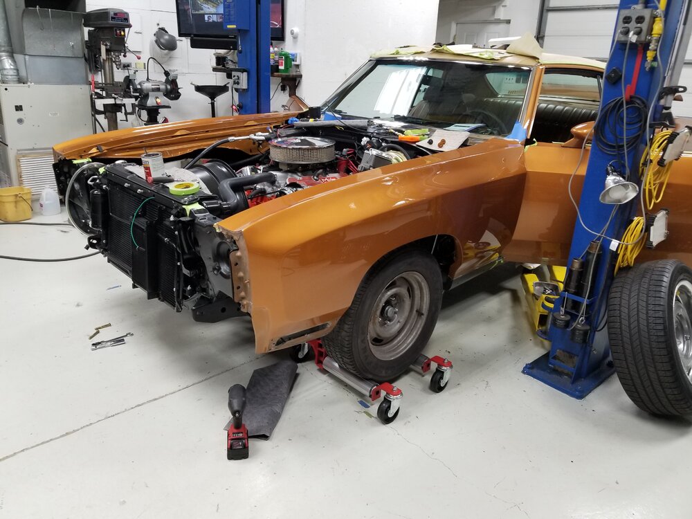

jft69z Posted September 21, 2020 Author Posted September 21, 2020 Thanks guys, it's certainly been a long journey. Started putting the fenders back on this afternoon, hope to be driving it fairly soon. Lot of overtime scheduled though, so I'll just keep plugging away a little at a time. 3 Quote

jft69z Posted September 28, 2020 Author Posted September 28, 2020 11 hours ago, DDay said: Wow!!! Is it for sale lol... Not Yet Don, but a few more aggravations may change that decision, lol. Still putting the front sheet metal, 'Parts Place' plastic wheelhouses, etc in place. Need to buff out the hood & place that so I can line up the fenders, mount lower trim, etc. Minor setback (as usual), the grill had to go back to chrome shop, so another week or two before I get that back. Thank you for the kind words as well! 1 Quote

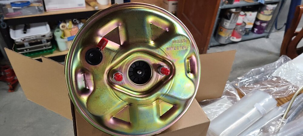

jft69z Posted September 28, 2020 Author Posted September 28, 2020 22 minutes ago, DragCat said: . Since I don't mind spending your money, and no I'm not taking the hit for the starter price .........Since summer is almost over I'm NOT volunteering to come up and turn wrench's with ya lol That starter wasn't cheap Mark, lol The weather today was nice, about 80 degrees. Supposed to go downhill starting tomorrow, 50's and 60's for the foreseeable future. I'll book you a flight!! The new brake booster came today from Mike at 'brakeboosters.com'. Looks good & packaged up exceptionally well. Hope to put it on tomorrow and see if the brakes are better. That being said, I also got the replacement booster from 'the Right Stuff' the other day, new in the box if someone wants it for pretty cheap. The one in the car is good in all actuality too, it just can't handle the lower vacuum the LS6 makes, so if someone wants that, you can have it even cheaper. I still have the original box for that one too. I'll post them in the for sale section if nobody here responds. New one from 'Brakeboosters.com': New/replacement one from "The Right Stuff": Quote
