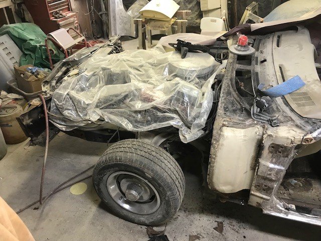

Haven't had an update in a bit just doing some sanding so not much to show. But have most if not all the seam sealing done in the first few pics . The others pics showing I have moved onto the front fenders. Drivers side sanded and mostly sand blasted. Cut out the rust on the fender and the brace is patched, hopefully patching fender tomorrow. m42.jpg.11d98e89775cdfa19a3b98ca2669f958.jpgseam sealed trunk lip and seam behind bumper m43.jpg.a2c7e949be1ed4ccad16c694515e4599.jpgcowl and driver jamb sealedm44.jpg.cb2776cb9a5f48051ee0dd1199036440.jpgcowl and passenger side , I will clean this jamb up, I liked how it came out better on the driver side, may look more factory this way but like it better neater.
m45.jpg.df024e9e8c0d8c80d45b159458223d39.jpg seal jamb under drip rail, also did the top but no pics of that yet must have forgot to take them
m46.jpg.2285420cde1b53cca0c6dc2568406ae6.jpgcutting out the rust, driver fender, just wrote down some measurements for the trim holes that disappeared.
cut out skin, sandblasted, cut out brace rust and patched the brace   m47.jpg.41baf8510e7c842e9e453d7ece5fd109.jpg
m48.jpg.99c62c2bb07e7e547d07a7408763968c.jpgbrace all done will patch the skin tomorrow hopefully.
