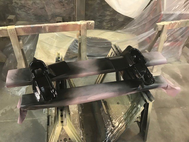

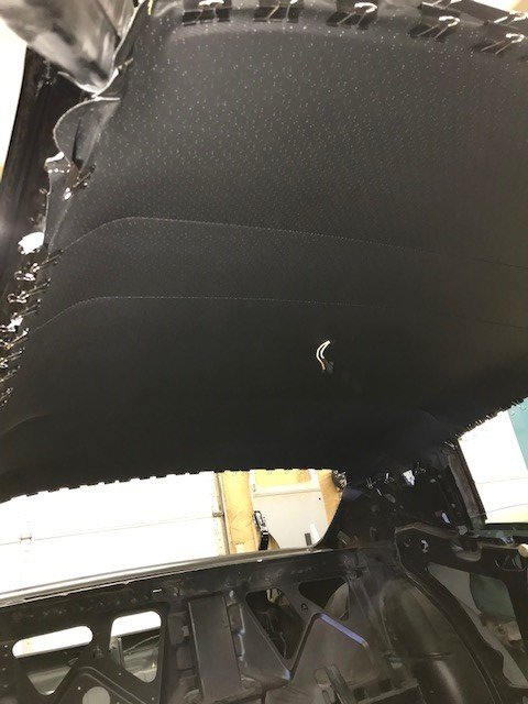

Just another update , now that main part of car is painted can start some work on other things. Started putting in headliner let it sit over night ( glad I didn't glue it yet ) needs to be tightened up more after setting overnight even after leaving in the sun before hand. Will take pics of that when I am done. Also painted the doors, trunk ,taillight extensions and door hinges here are a few pics. Thanks for looking.
Here are a few pics applying the black epoxy primer/sealer.
m160.jpg.e7d9ce0ae71a04b03e7f43e295336eee.jpgm163.jpg.c826e45d9e5e53411c43ec041e2a125f.jpgm162.jpg.2e90606808c0f9d016491732e3df06aa.jpgm161.jpg.c98f484af6d746e5cc50dd255e5c568b.jpg

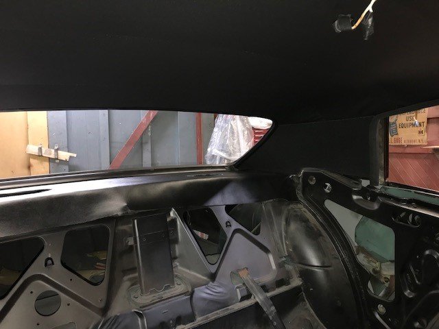

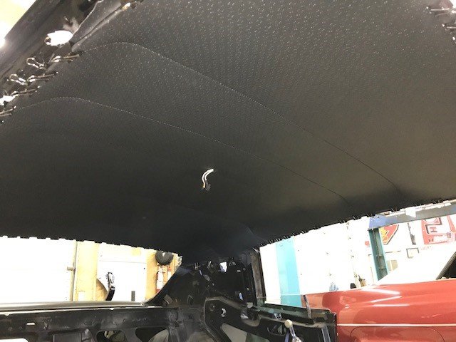

Got the taillight extensions on last night and finally got the headliner glued in , just need to clean up and tuck in edges and install wind lace. Will post pic of taillights later .. didn't want to paint the silver on so I used HVAC Foil tape ( the real duct tape) . I think it will be a little more reflective and the temp is 600-800 deg which shouldn't be an issue. Here are a couple pics of the headliner maybe a little wrinkle here or there but happy with how it came out for a first time doing it. A little sun and /or massaging with the heat gun cautiously may help also. As always thanks for looking
headliner.jpg.4ca1cb66f293d2671d5e7907e0a29cd6.jpg87273099_headliner2.jpg.c4c36eea61d313b7f3c187cc154958ea.jpg
Looks great, I need to replace my headliner, I'm not sure if I have the guts to do it myself. Where did you buy yours??
I grabbed it from Summit ,its PUI Brand with the sail panels and some extra fabric for visors, It was like $107 shipped. I watched a couple videos on line , and with patients with a bunch of binder clips to help hold it as you work and stretch it . I put it in the best I could , let it sit overnight came back on Sunday played with it a little more and then on Tuesday glued it in ,I got the good weldwood landau top and trim glue , brushed that around the metal and on the headliner waited a few minutes and started sticking it . As I glued it I popped off about a quarter of the clips , worked in that area and then did another quarter and so on. I will say I think having it sit in there a couple days with clips made it easier when I glued it .I felt like it went into place and  when it came to gluing it was much easier to work and tweak then I thought.

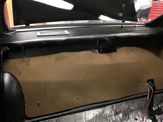

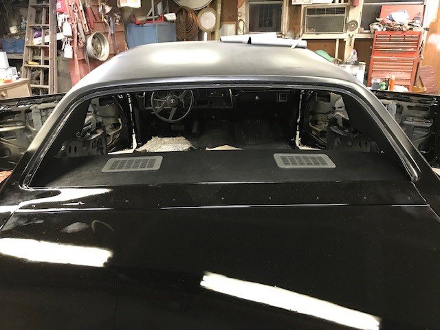

Just an update was on vacation for a week in Myrtle Beach for golf and sun. Enjoyed vacation but also knew this thing is sitting at home and nothing getting done on it. So the latest there are the pics of the taillights with the foil tape , as well as got the trunk on, doors on , made the package tray panel and got that installed, sound deadener , sail panels and headliner moldings installed. Here are some pics enjoy and thanks for looking.

Here is the making of the package tray using tempered hardboard and black marine vinyl. About $20 dollars in materials and personally I think it looks better than the $50 piece of painted cardboard.
m176.jpg.b761943bb67341ec275d7c4342450dcc.jpgm175.jpg.2071a23ce9b7d59731f4d7cd7b2d9ae0.jpg

Here are the finished package tray , sail panels and headliner trim installed.m177.jpg.21ce92b5d37452d1b9b350ec5d5e7660.jpgm178.jpg.a9d1af2d51fbe2e2064d2df312a8face.jpgm179.jpg.37cd3dd88e0b74450f4550f5339b159a.jpg

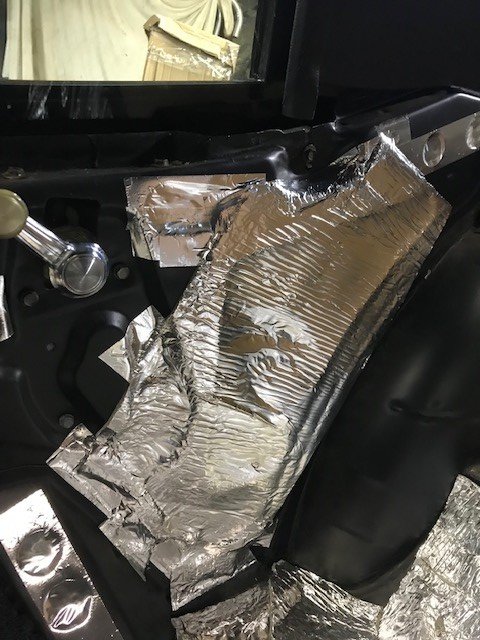

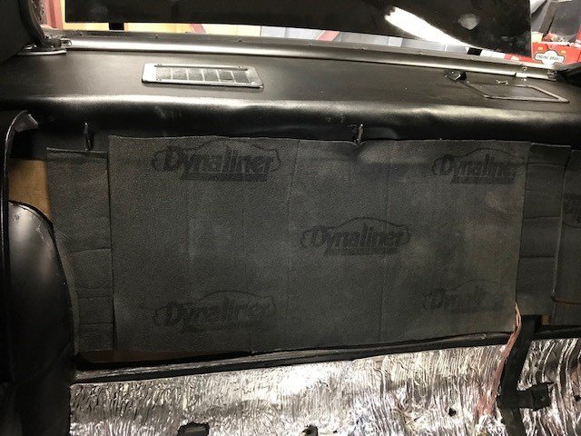

Just the sound deadener in the floor installed

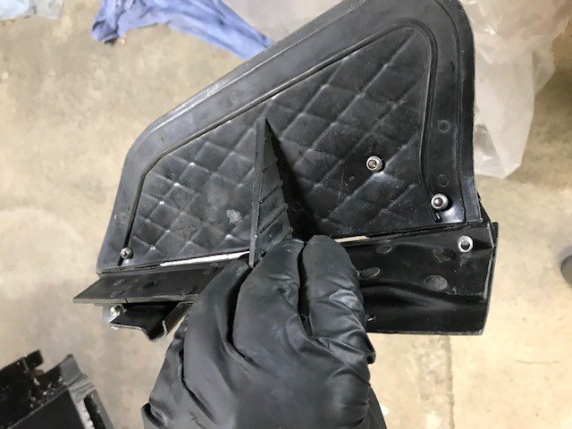

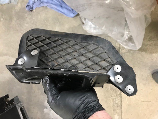

Repaired the fresh air door with rubber and rivets you will never see it  and I think will last longer then the plastic bending back and forth. Cant see spending 60 bucks on these things and just have them break off.
m187.jpg.1548ddc8f140057032c864b0fbfdda38.jpgm188.jpg.e3848d6464daeb0f44b9bd92a734bcab.jpg

Used sound deadener in the sides instead of putting water paper back in, which really seems useless , should be sealed much better with this and provide a little noise reduction.m202.jpg.f16e9f87bede051bf95fb878bdbe3a9a.jpg

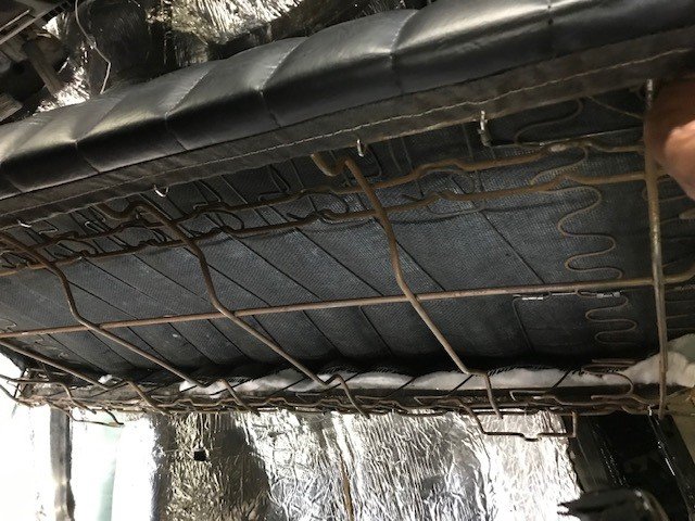

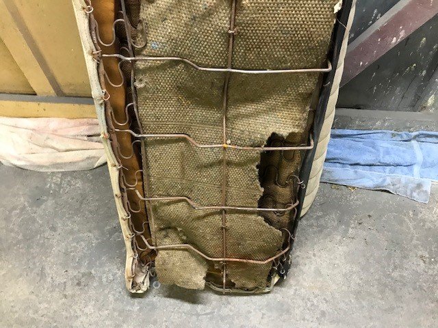

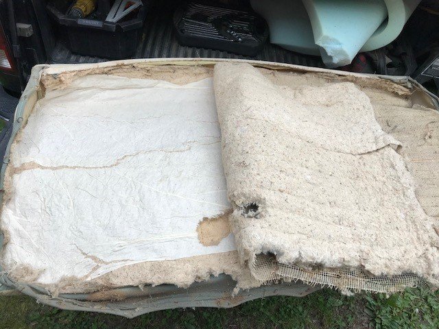

Got the nasty mouse infested seats covered , the only thing I reused was the bottom seat foam which was still in decent shape , steamed it to freshen it and replaced new batting and burlap, had some 2' memory foam from a mattress topper cut up for the back of the seat. worked pretty well . Sad news is someone was here before because that was all I found left of the build sheet in the seat back.
m184.jpg.8f96ee858838ee09acb0e47674750c3d.jpgm185.jpg.4a24a6d978fceb9219df4291cf716066.jpgm205.jpg.95be55bcae28bab1975eb80f5d28e207.jpgm206.jpg.b57bbdae894f3357cd7a9f9b6774ef72.jpg

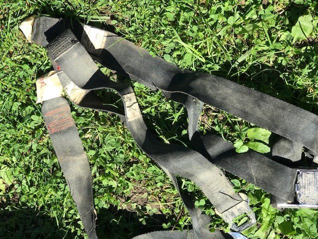

Getting the seat belts cleaned up pretty happy with how they cleaned up.
m196.jpg.498e4890f93a08eceded08b457f0c4fc.jpgbefore
after
m197.jpg.1333054ca7808abad3c293467bd17ee7.jpgm198.jpg.d65d216a24d46f31d0b8f8a5fbacb4ea.jpg

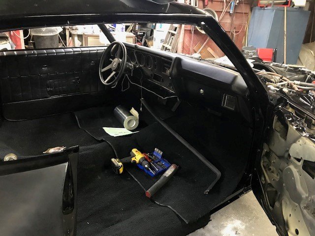

Carpet setting in there need to get the wrinkles outm194.jpg.829129b38a540eaddfb663cdfea2731e.jpg

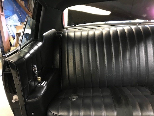

Back seat , rear panels and carpet all installed in the back.
