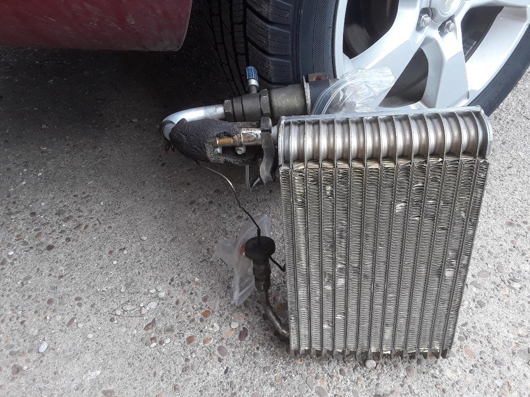

In my past post on this I had mentioned I was having trouble getting the POA valve and the Expansion valve off of the Evaporator coil.  Last week I removed the Evaporator Coil from the car.  It was a little hard to do one handed due to my hand surgery but I was able to get it out.  A couple days ago, before the stitches removal I was able to get the Expansion Valve off.
Tonight, after multiple soakings of PB Blaster on the fittings of the original POA Valve I was finally able to get the original POA valve off.  I know now that I would never have been able to get it off of the Evaporator Coil, with the coil still mounted inside the box, without damaging the lines on the evaporator coil.
It took clamping the evaporator coil fitting to the POA Valve into a vice.  The problem with doing this is it put undue stress on that line with the evaporation coil hanging in the air unsupported si I had to build a support platform to support it.  With the evaporation coil supported and the vice holding the line fitting that goes to the POA Valve and it soaked good in PB Blaster it still would not budge.
My next step was to get my torch out and heat up the POA Valve.  This was suggested by "Old Air Products" where I purchased all of my new parts for my AC system.  With the vice holding the nut on the Evaporator line, and the POA valve heated with a torch for 3 minutes,  I put a pipe wrench on the POA Valve and tried to turn it but unfortunately the base of the vice would not stay locked and the torque on the POA with the pipe wrench was causing the vice to rotate on its base.  I reheated the the POA Valve with the torch again, placed a 15 inch wrench on the vice to hold it into position and a pipe wrench on the POA Valve and most of my 225 pound body weight on the wrenches the POA Valve finally broke free.
Now, with the POA and expansion valves off and the Evaporator coil out of the car it was time to proceed with the flushing of the Evaporator Coil.  If you had followed the earlier posts, when I disassembled my system I found a lot of oil in the lines.  According to what "Old Air Products" has told me when I reinstall my rebuilt compressor I should put about 10 1/2 ounces of oil into the compressor.
With the amount of oil I found in all of the old lines I was sure there would be oil in the evaporator and the condenser coils.  This was another reason I wanted to remove and inspect my evaporator coil.  I am now very glad I did.  I know at I drained at least 3 ounces of oil out of the evaporator coil.  This coil is the farthest component from the compressor and I feel that much oil in the evaporator was very much excessive and I was glad I removed it.  Once I got as much oil out of it as possible I started flushing the evaporator coil with Denatured Alcohol.as suggested by "Old Air Products".  I used about 1/2 gallon of denatured alcohol to do multiple flushings of the Evaporator coil followed by blowing it out with compressed air.
So now my evaporator coil is flushed and as soon as I straighten out all of the fins in the Evaporator Coil and all of the denatured alcohol has had a chance to evaporator I will reinstall it.

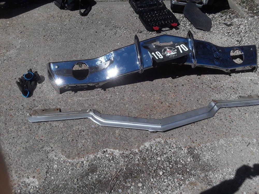

Due to the fact I would have to remove the front bumper, filler plate and numerous other parts,  to try to flush the condenser coil, I was thinking bout trying to flush the condenser coil with it still on the car.  After seeing how messy and hard it was to flush the evaporator coil, I now think I will go ahead and remove the bumper, filler plate and other parts and remove the evaporator coil to do a proper flush of the condenser coil.
After I have done that, I am sure I will find considerable buildup of oil in the condenser coil.  I will save that for a future post once I have the condenser removed.  Once the condenser is flushed I will be able to start reassembly of all of the parts I have removed..  Thanks to everyone who has sent along encouragement, suggestions and assistance.

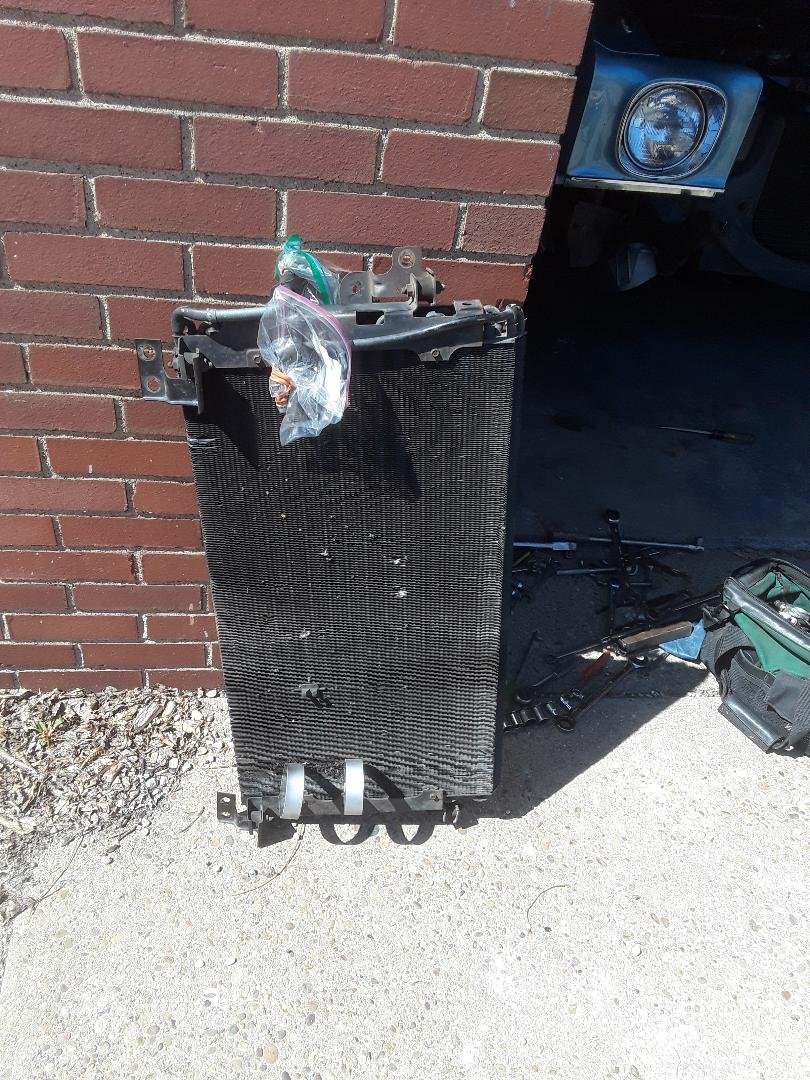

Today I was able to remove the Condenser Coil.  I have flushed it out real well with denatured Alcohol.  Since the Condenser coil is the lowest point in the cycle of the system and the amount of oil found in all the other areas of the system I expected to find a lot of oil it it.  After all, all of the lines and the evaporator coil had a ton of oil in them.
As it turned out there was very little oil in the condenser coil.  It was a bit of work to get the condenser coil out and at first I was upset that there wasn't much of any oil in it and thought maybe I should have just skipped this step in the restoration of the AC System but I would have always wondered if maybe there had been oil in it.  To remove the condenser coil you have to remove the front bumper, turn signals, bumper to grill filler panel, (the grill was already off), the hood release etc. etc etc.  You will see in the pictures the Monte looks like it is smiling but not sure why it would be smiling with this many pieces off of its body.

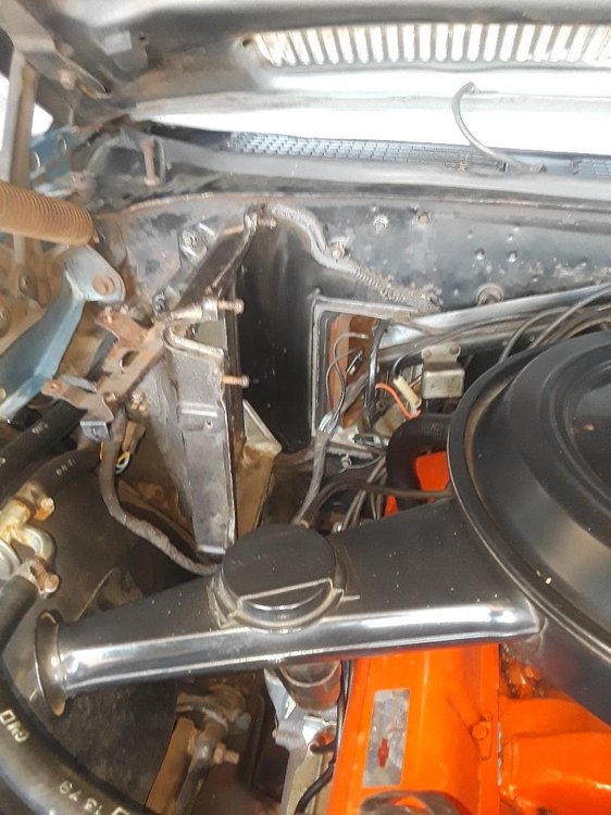

Well Steve....here are the pictures you requested.
32 Bumper and filler panel fremoved so I could remove and flush the condenser coil.jpg34 Front items removed to be able to access the condensor coil.jpg
How hard was it getting the evaporator out. I am guessing your going with 134a
Antoine,
When I removed the Evaporator Coil last week I was working with only one hand due to surgery for trigger release on 4 fingers on my left hand so it took me a little longer than it should have.  Also, it took me a little longer because, with the evaporator coil mounted inside the plenum I could not break the fittings on the expansion valve and POA Valve free and if I had left it in the car I would have damaged the lines and would have had to replace the evaporator coil.
That said......  to remove the evaporator coil it is not real hard if you can get the expansion valve and the POA valve off the evaporator fittings.  Once the two valves are off you should be able to remove the evaporator coil out by completely removing the plenum side on the motor side.  It is held onto the firewall with 2 or 3 speed nuts and one or two bolts.  Also it is held to the other side of the plenum with 6 to 8 bolts.  Once these nuts and bolts are removed the engine side of the plenum should easily come off.  Just a note, there is also a relay and a vacuum canister mounted onto this side of the plenum and must  be removed.
I had heard from another member that once the engine side of the plenum was removed there may be a bracket on the evaporator coil which was holding it to the plenum but my 70 did not this bolt and bracket holding it to the other side of the plenum.  With the engine side of the plenum removed I was not able to get the evaporator coil out because it was catching on the firewall.  The reason for this is where the air would enter the interior through the firewall there is a outward facing lip on the firewall which prevented the evaporator from clearing.  To combat this I only had to remove one speed nut, one bolt and loosen another bolt near the top and side which secures plenum side nearest the fender and this allowed me to remove the evaporator coil..
I hope this is clear.
Time wise, working with one hand, it took me about 1.5 to 2 hours to remove the evaporator coil.
Today, to remove the condenser coil I think it only took about 2 hours.  One of the hardest things to remove to access the condenser coil was the bumper to grill filler panel.  This is the silver panel that fills the area between the bumper and the grill and the bumper and the fender extensions.  If you look at this filler panel above, pictured next to the bumper you will notice the number of holes in this panel.  That's right, there were 11 bolts holding this panel in position.....total over kill for mounting this panel.  I think it weighs all of maybe 5 pounds.
