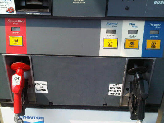

We have this in Canada. 94 octane with no ethanol.
I use ethanol free in mine, there are places that sell it. If I have to use ethanol I use the additive but not twards the end of the saeson, you dont want it sitting for the winter in the car.
