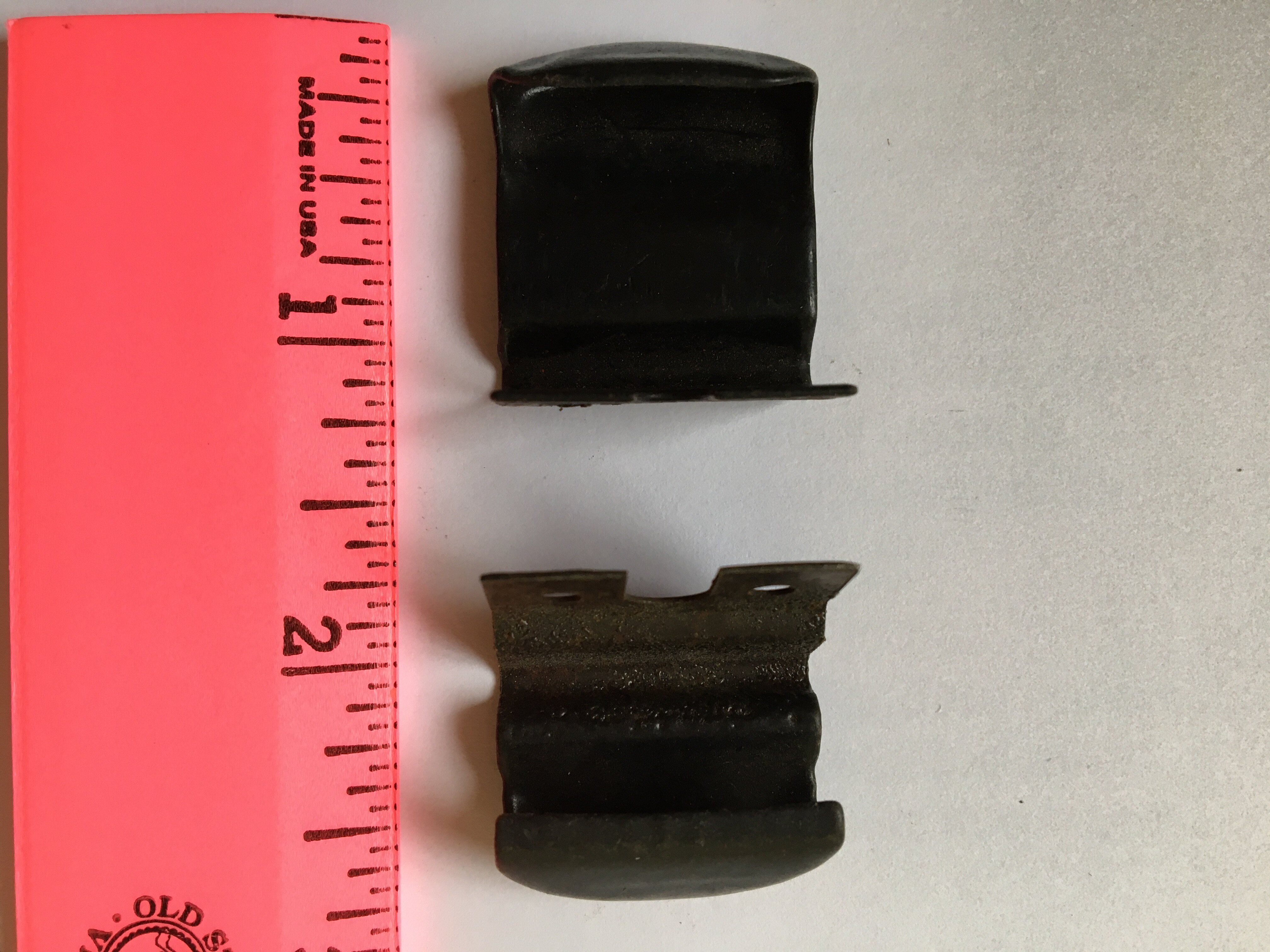

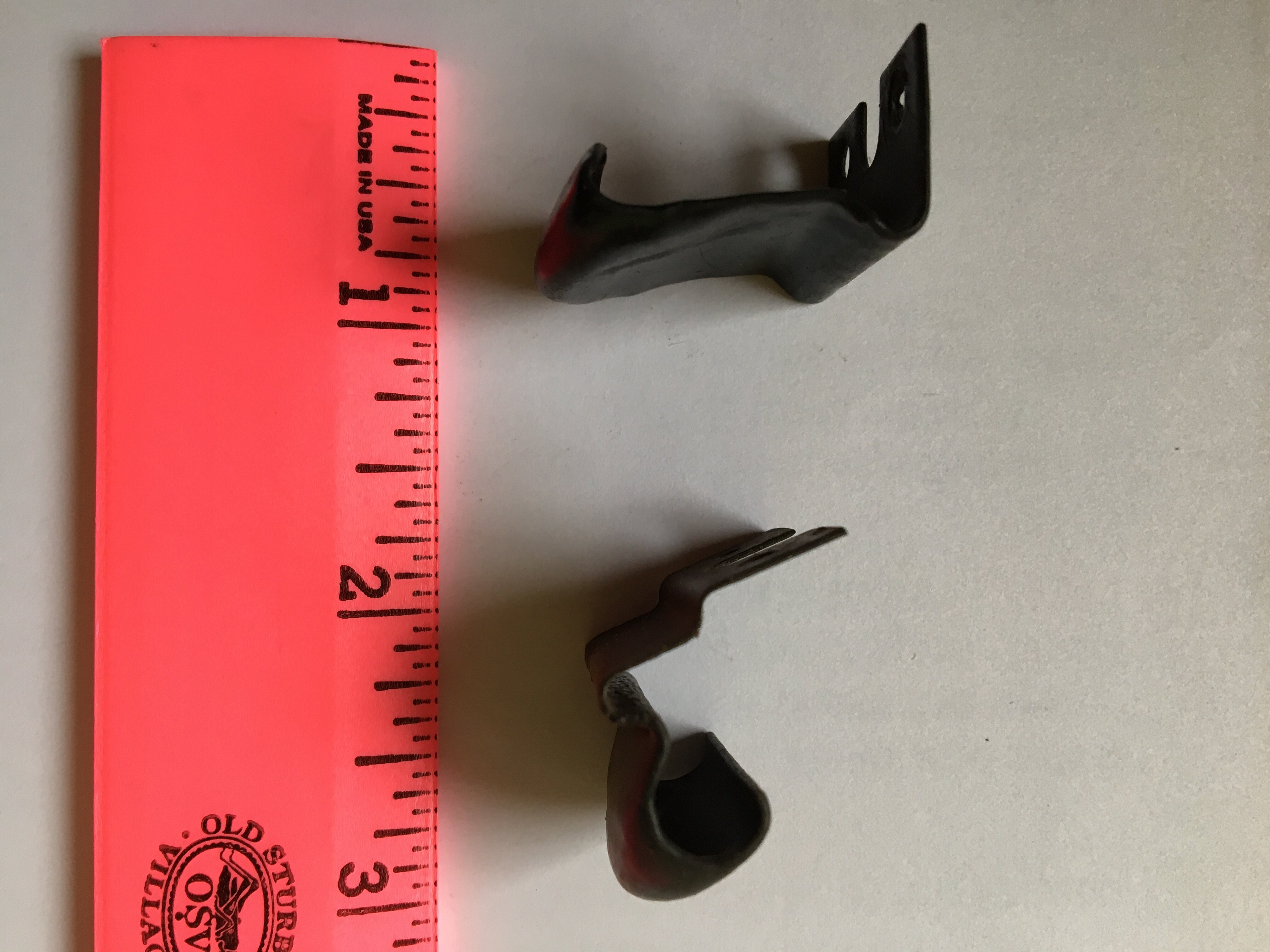

I remember a "anti blow out" clip, one on each ft window on my 71. They were plastic or rubber coated clip that I removed years ago because the plastic cracked and fell off. After the plastic was gone it rusted and looked bad. I think they were perhaps 4 or 5 inches forward of the rear 1/4 window. I got some replacements but never installed them. Can't believe I found them in my tool box!! See attached pictures. two different styles / sizes.
