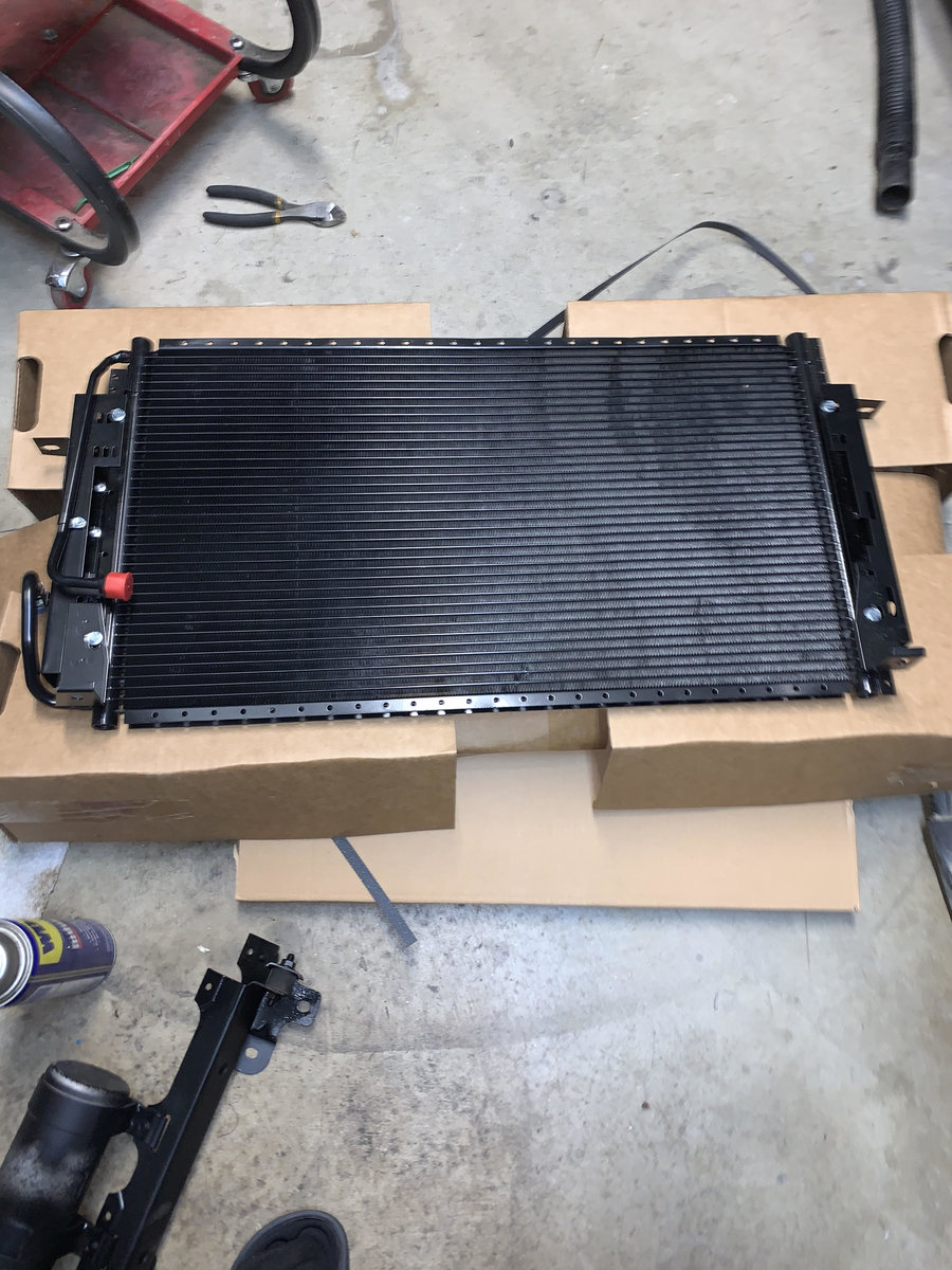

sendo Posted October 27, 2019 Author Posted October 27, 2019 okay got my parallel condenser now looking for the grommets, do I need grommets for both side? anyone know the part number or where to get them? thanks, Sendo Quote
