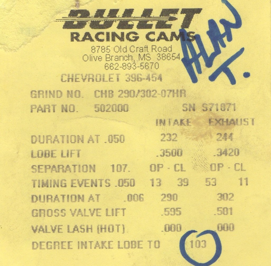

snomobeelr Posted September 20, 2019 Posted September 20, 2019 Hello, I've done this before but it was when I had a regular Hydraulic Cam and stock Rocker Arms. When I did this prior it was not the best way, I did it with car running it was the back off nut and readjust by sound/Clicking method. My motor has 5000 miles on it now and I probably should have check it before but I have not done it. i Have a Roller Cam/Lifters and Rockers. I dont know if it is needed but I have attached the Cam card Any advice would be appreciated. Thank You 454 -30 over Brodix Race Rite Oval port Heads Quote

snomobeelr Posted September 26, 2019 Author Posted September 26, 2019 . So it is done same as Flat tappet, I wasn't sure about that. I did find an article/Site with directions too I pasted it below. Guess Ill see if it is right. Thanks everyone, appreciate it !! https://www.centuryperformance.com/valve-adjustment-procedure.html ENGINE OFF Valve Adjustment Procedure - The Quick and Accurate Way: First, view this simple chart below for Small and Big Block Chevy Engines. Do you understand what it describes? A more detailed explanation follows below the chart. For other engines you will use the firing order that matches your engine to create a similar chart. This chart is based upon "opposite" cylinders of your firing order. (see below) Intake Valve Adjustment: ENGINE OFF! · with #1 cylinder Intake Valve at full valve lift .... Adjust #6 Intake Valve · with #8 cylinder Intake Valve at full valve lift .... Adjust #5 Intake Valve · with #4 cylinder Intake Valve at full valve lift .... Adjust #7 Intake Valve · with #3 cylinder Intake Valve at full valve lift .... Adjust #2 Intake Valve · with #6 cylinder Intake Valve at full valve lift .... Adjust #1 Intake Valve · with #5 cylinder Intake Valve at full valve lift .... Adjust #8 Intake Valve · with #7 cylinder Intake Valve at full valve lift .... Adjust #4 Intake Valve · with #2 cylinder Intake Valve at full valve lift .... Adjust #3 Intake Valve Exhaust Valve Adjustment: ENGINE OFF! You will notice that this is the same procedure and sequence as the intake valves listed above. Only now you are adjusting ONLY the exhaust valves the same way. · with #1 cylinder Exhaust Valve at full valve lift .... Adjust #6 Exhaust Valve · with #8 cylinder Exhaust Valve at full valve lift .... Adjust #5 Exhaust Valve · with #4 cylinder Exhaust Valve at full valve lift .... Adjust #7 Exhaust Valve · with #3 cylinder Exhaust Valve at full valve lift .... Adjust #2 Exhaust Valve · with #6 cylinder Exhaust Valve at full valve lift .... Adjust #1 Exhaust Valve · with #5 cylinder Exhaust Valve at full valve lift .... Adjust #8 Exhaust Valve · with #7 cylinder Exhaust Valve at full valve lift .... Adjust #4 Exhaust Valve · with #2 cylinder Exhaust Valve at full valve lift .... Adjust #3 Exhaust Valve Quote
Andy's Auto Posted October 10, 2019 Posted October 10, 2019 You really have to go with whatever the lifter manufacturer recommends for pre load but there is no difference as far as sequence from a hydraulic roller to hydraulic flat tappet. Quote
