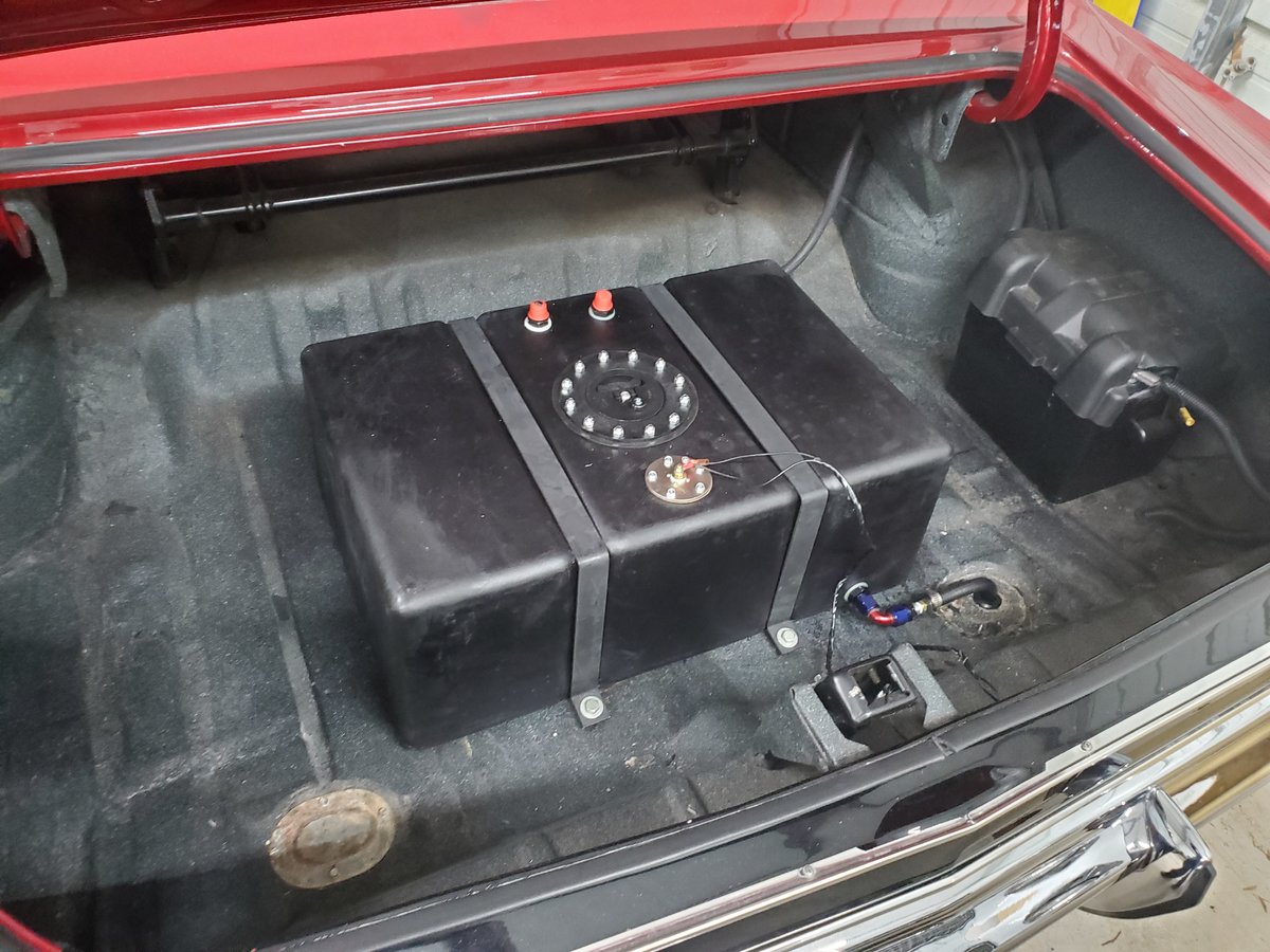

Jared Richey Posted September 22, 2019 Posted September 22, 2019 Well my reproduction fuel tank has sprung a second leak in my car and it's only been in for 10 years so instead of going back with a factory tank I'm looking to install a fuel cell in the trunk. I want to know how to go about making the factory fuel gauge work with the fuel cell. also to anyone who has already done this would you recommend a 16 gallon or 20 gallon? I already have my battery in the trunk but I only use this car for local driving and occasional fun runs at the track. Quote
Mike 57 Posted September 24, 2019 Posted September 24, 2019 Jared, Do you have a true firewall between the trunk and the seat. There is a requirement for one with the cell in the trunk. I think the battery need to be in a can. You can get a sending unit for most cells with GM values. You will have to take the foam out of the cell for the sending unit. Quote
Jared Richey Posted November 12, 2019 Author Posted November 12, 2019 I was just thinking about this and thought I posted about it. I would like to buy a tank with no foam if possible. Also does anyone know the correct sender to get for the tank so my factory fuel gauge will work like Mike said? as far as a firewall situation it's just stock in between the back seat and the trunk. Quote
Rancid87 Posted November 14, 2019 Posted November 14, 2019 The 0-90 ohm sending unit is the one you would want to work with the original gauge. Quote
Jared Richey Posted December 3, 2019 Author Posted December 3, 2019 I've been looking at a few on summit. Are there any concern with ethanol fuel if I get a foam filled fuel cell? Quote
Rancid87 Posted December 3, 2019 Posted December 3, 2019 You would need to make sure the foam is compatible with ethanol/E85. Foam used with gasoline will deteriorate in ethanol blended fuels. Quote
Jared Richey Posted December 10, 2019 Author Posted December 10, 2019 Having trouble finding the correct one. I need one with no sump so I don't have to cut up the trunk floor. Quote
Jared Richey Posted January 6, 2020 Author Posted January 6, 2020 Here it is. Going to detail my trunk again. Fuel gauge works perfectly 2 Quote
