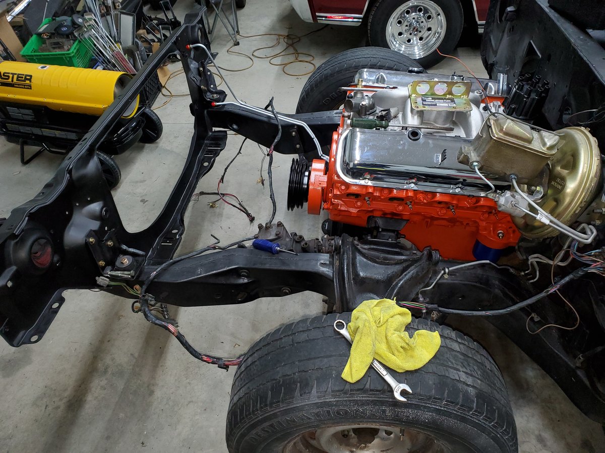

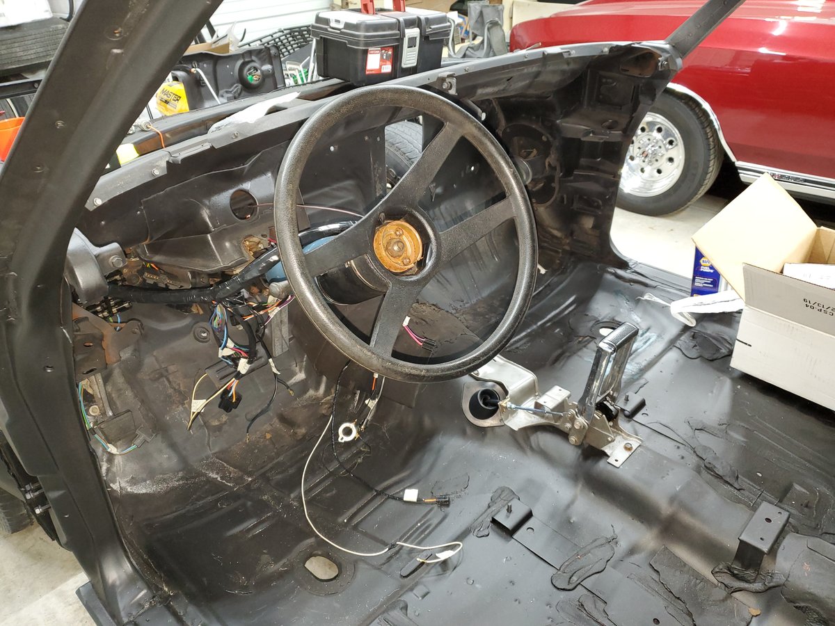

Jared Richey Posted December 2, 2019 Author Posted December 2, 2019 Went ahead and moved the car into my other garage to get the drivetrain/ wiring installed. Hopefully I can time it just right and knock out the body and paint early part of 2020. Quote

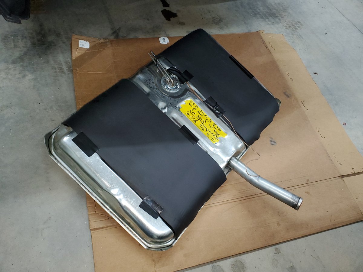

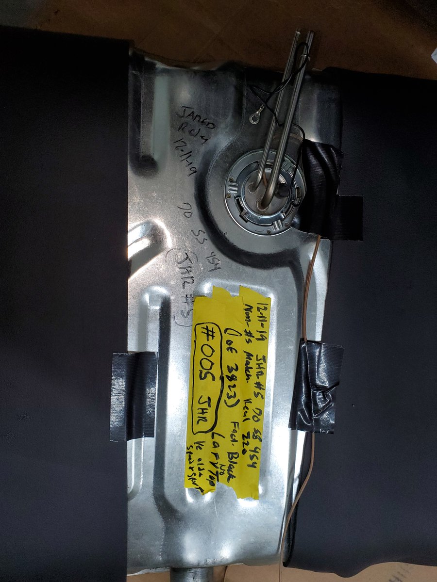

Jared Richey Posted December 12, 2019 Author Posted December 12, 2019 Coming along. Including my personal fuel tank "build sheet" Haha 2 Quote

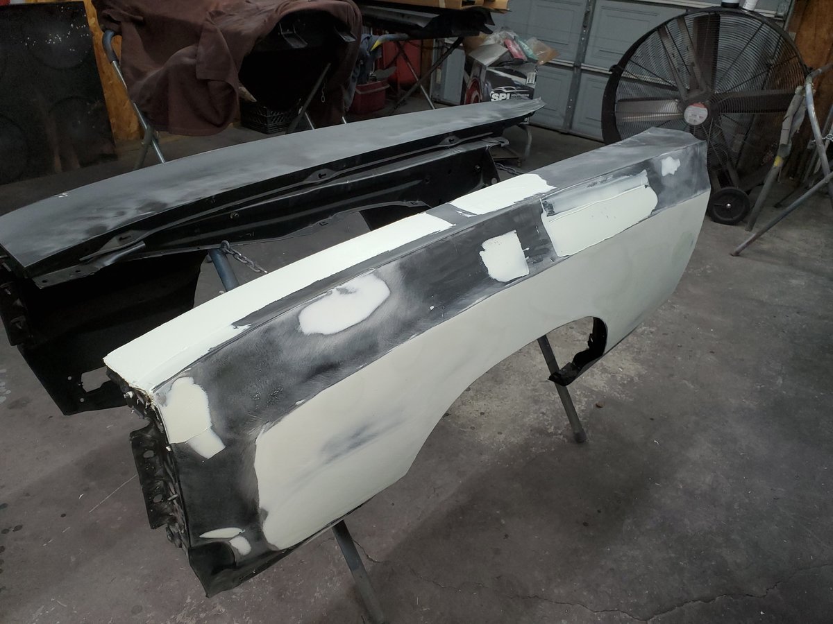

Jared Richey Posted December 17, 2019 Author Posted December 17, 2019 "Ain't no bondo in this car" Hahaha Said no straight paint job ever. Bodywork started on loose panels with 3M filler. This thing will take shape in a hurry once it moves under its own power . VINTAGE AIR is on order. 1 Quote
Leghome Posted December 17, 2019 Posted December 17, 2019 That 3M body is some of the easiest filler I have ever worked with. With careful spreading no sandpaper over 80 grit is used by me or the shop where I first seen the 3M filler Quote

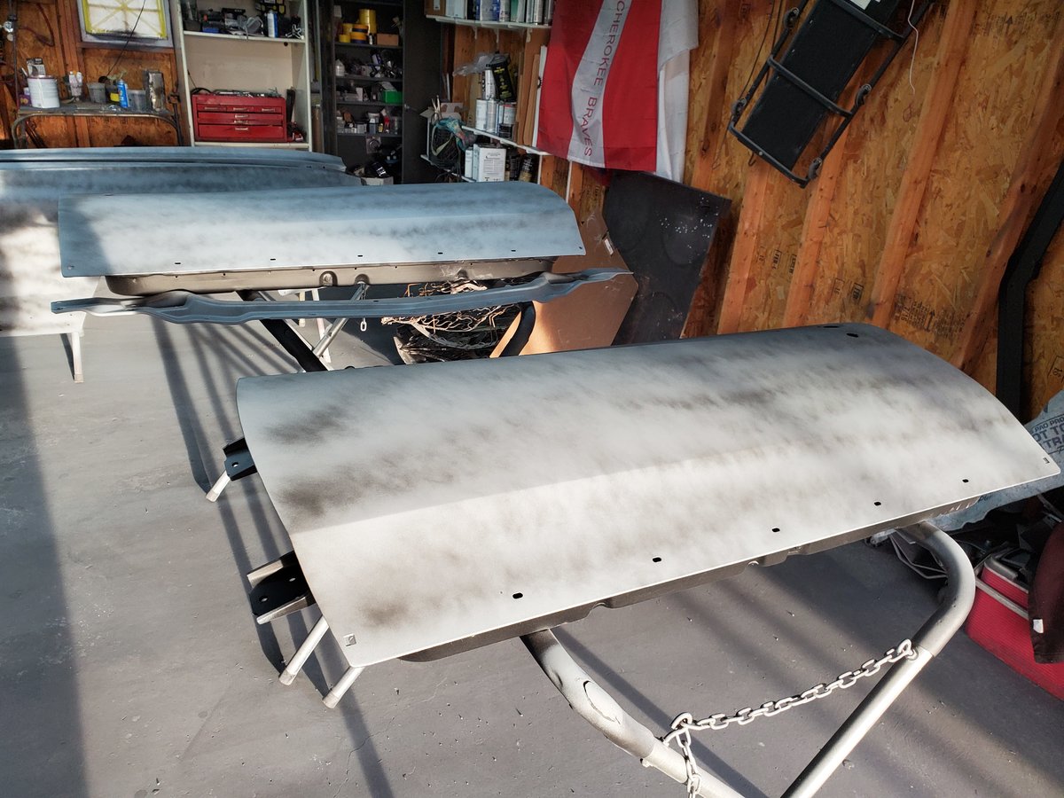

Jared Richey Posted December 26, 2019 Author Posted December 26, 2019 First round of Southern polyurethanes High Build Primer #8000-1 act.. 70001-4 $175 kit 4:1 2 Quote

Jared Richey Posted January 6, 2020 Author Posted January 6, 2020 Going to muffler shop this week hopefully Got to go pick up Vintage Air. Hope to have it running by the end of the month. Bodywork half way well actually over halfway, all the bolt on parts in high build primer already. The key to finishing this car for Carlisle will be the next 3 months. Very critical time period. Car must be painted and allowed time to cure without rushing the cutting and buffing process. Buffing will be absolute last thing. Learned My lesson the hard way cutting and buffing these cars right after a paint job. Quote
Jared Richey Posted January 7, 2020 Author Posted January 7, 2020 Blocking. Coming out nicely. Got to re wipe a little on the fender. Sanded smooth and feels smooth but when you look at it with the water you see ripples where I stuck the orange tape . 1 Quote

Jared Richey Posted February 27, 2020 Author Posted February 27, 2020 Getting close to firing up. Engine is a low miles 80s 454 with a cam/intake swap. 4 Bolt mains. So have to break it in like a new engine. Quote
Jared Richey Posted March 11, 2020 Author Posted March 11, 2020 The car runs and drives under its own power and I have moved it out to my body shop area to work on it. Carlisle or Bust! Quote
