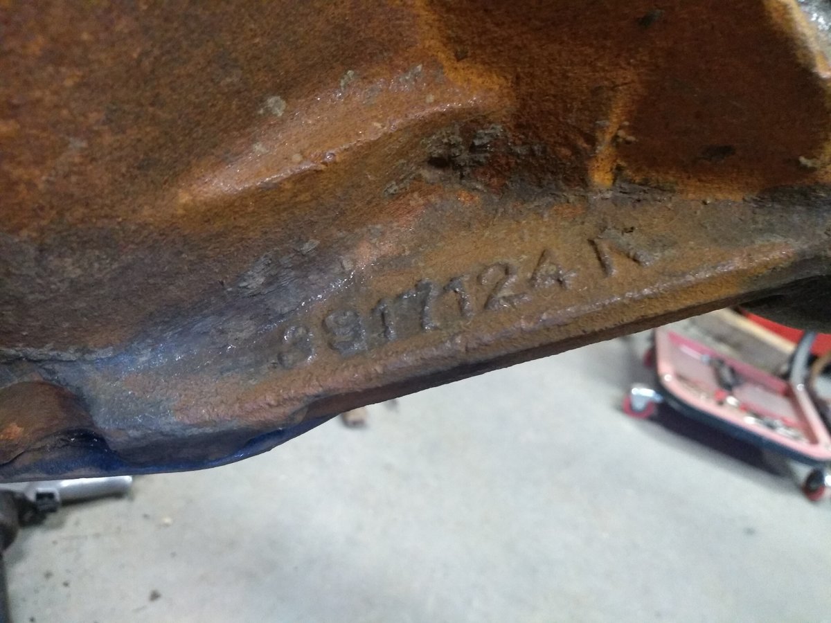

I know this isn't the correct rear end for my car, but can anyone identify it? It's a 12 bolt. IMG_20191231_140037173.thumb.jpg.28cfde3251b299093a3c98a36a402444.jpgHere's the tube stamp.

No Chevelle ever had a rear with the "RC" code.
Can you tell us any more? What year do you think it is?
Can we see more pics, including the cover?
The 0515 is a date code but it's meaning changed through the years.
All I can find is that its an Olds diff with 3:08's inside. Oldsmobile delta 88's or the Jetstar..as far as thew RC code goes. the 05 15K would think its the 15th of November but the 05 is weird...

Don't have a close up picture of the cover but I will attach a pic that you can zoom in to it. Looks like an ordinary 12 to me.  All I will say is I put this rear end in after the previous one wore the trailing arm bolt holes to a nice oval shape. It wasn't the factory unit either. But my dad owned a salvage yard so this was already pulled out. I walked over to a selection of 12 bolts and picked one that was maybe a dozen years ago. Thanks for the replies.
Well that's definitely a Chevy car 12 bolt rear. Truck 12 bolts had a different cover.
I wasn't having luck finding anything online, that's why I posted here. Thought maybe I was a moron and wasn't looking it up right.
From the "K", I can say this rear was manufactured by McKinnon Industries.
Tommy, see if you can get the casting number. It's on the front webbing of the cast center section.

May sound stupid, but what if the guy on the line stamped it backwards? "CR" would be a 3.07 posi according to a couple of lists out there.
That could be Joe.
Tommy, while you're at it, measure how wide it is from axle flange face to axle flange face.

I haven't pulled the wheels off to measure yet. But the casting # is. 3917124N.
Pulled the cover and it appears to be a 3.07 ratio. 14 pinion teeth and 43 ring teeth.
OK, I'm gonna go with what Joe said, that the stamper got the letters swapped when he stamped it.
The "CR" code would be a 1968 rear with the 3:07 ratio and the casting number.
It should measure 61.21 inches.
That would make sense.  It's not the first time I've seen old G.M. stuff with funky numbers. Thanks for the research everyone.
