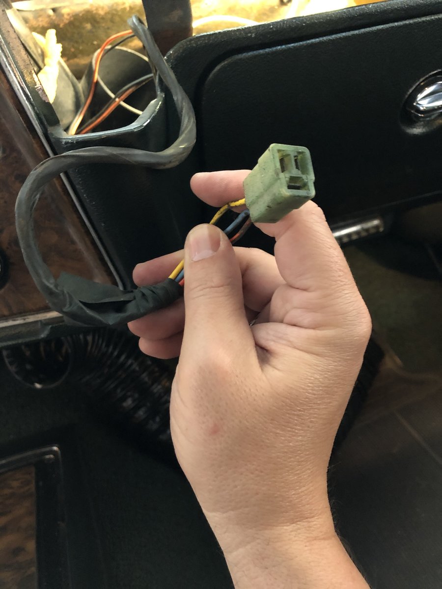

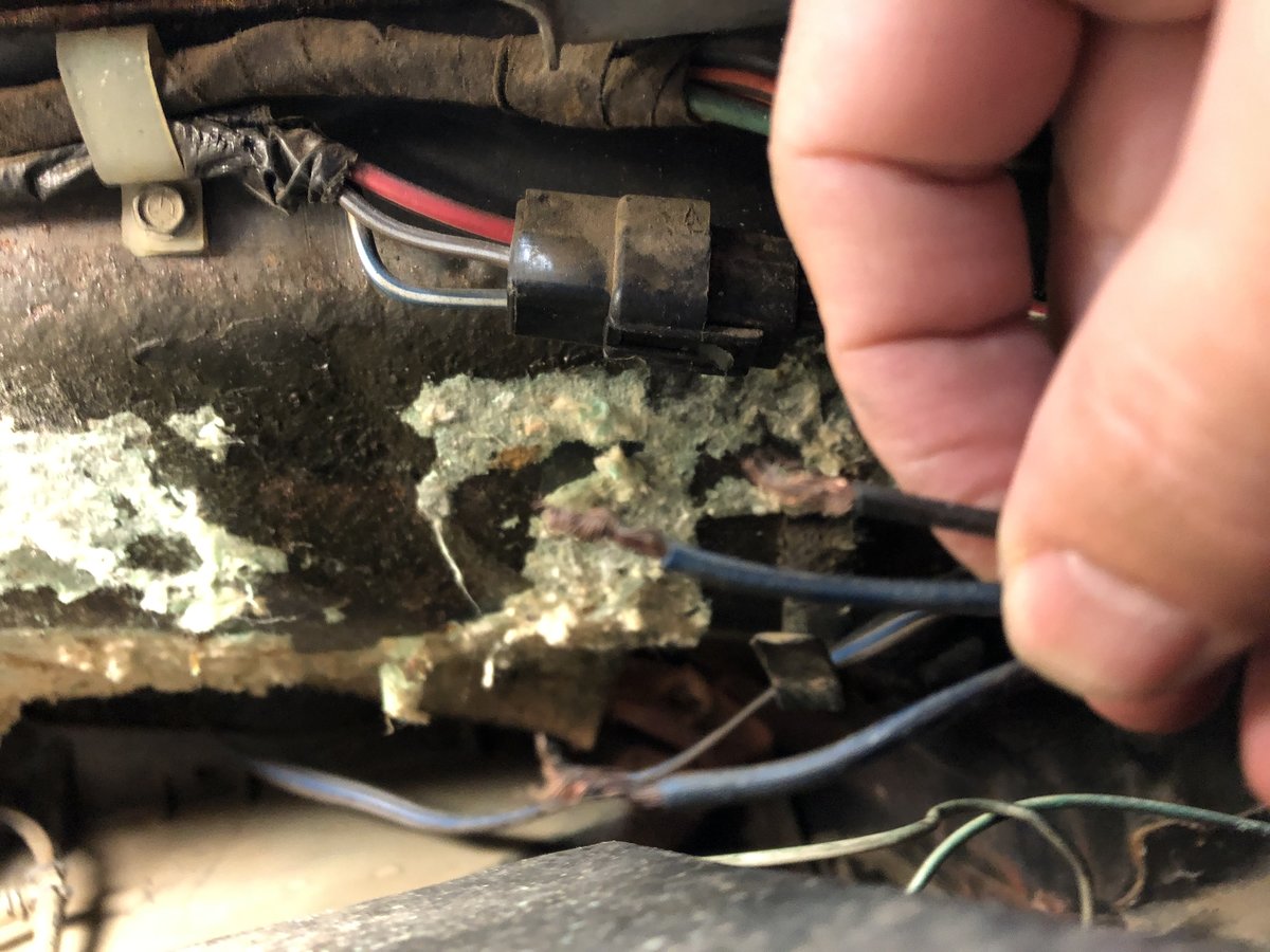

Need some help identifying the white connector behind the dash.  It appears to share the same loom with the wire that goes to the passenger door jam switch.  Any idea where it connects and to what?  In the second picture there are three wires that appear to come from the firewall but just stop where I assume the passenger side speakers should be...not sure. Two black wires with a purple wire in between them.  Sorry picture is blurry on that one but you can see the wires heading down over and behind the heater box.

The white connector goes to the heater box on a non A/C car. It plugs in on the top of the heater box. Do you have A/C? If not it will not be used. The other wires look like they are speaker wires.
Thanks Dan.  Just so I have it correct.  Since the car has A/C that connector is not used, correct?  I believe those are speaker wires too but the radio isn't hooked up (missing part of the harness I believe), the speakers are missing and I believe I am missing the drivers side speaker bracket.
