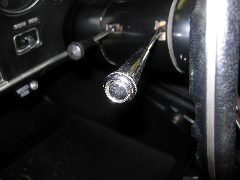

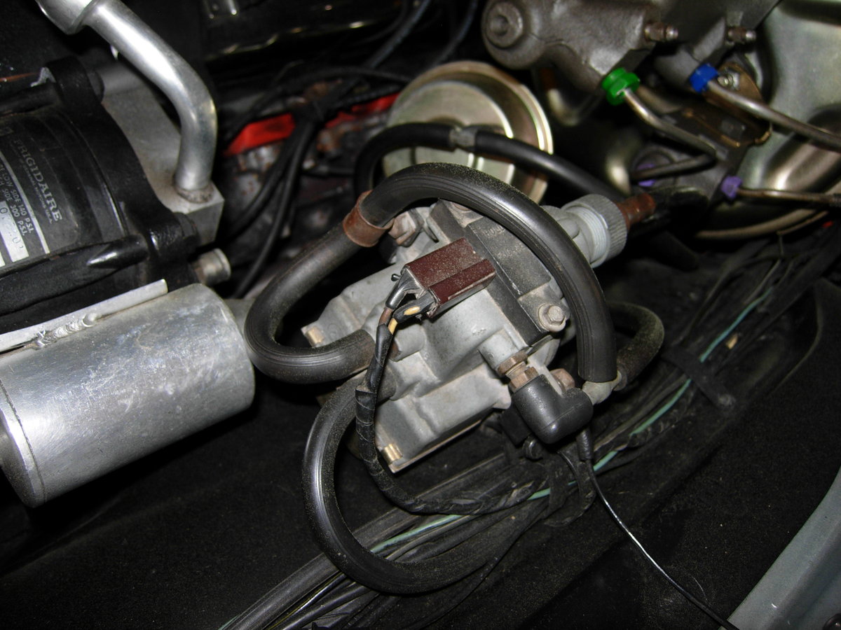

The 1970 cruise control lever is chrome and there was also a vacuum canister mounted on the firewall not the inner fender and 71 didn’t have any cruise control but 72 had a black lever with the canister on the inner fender. The linkage was different In 70.

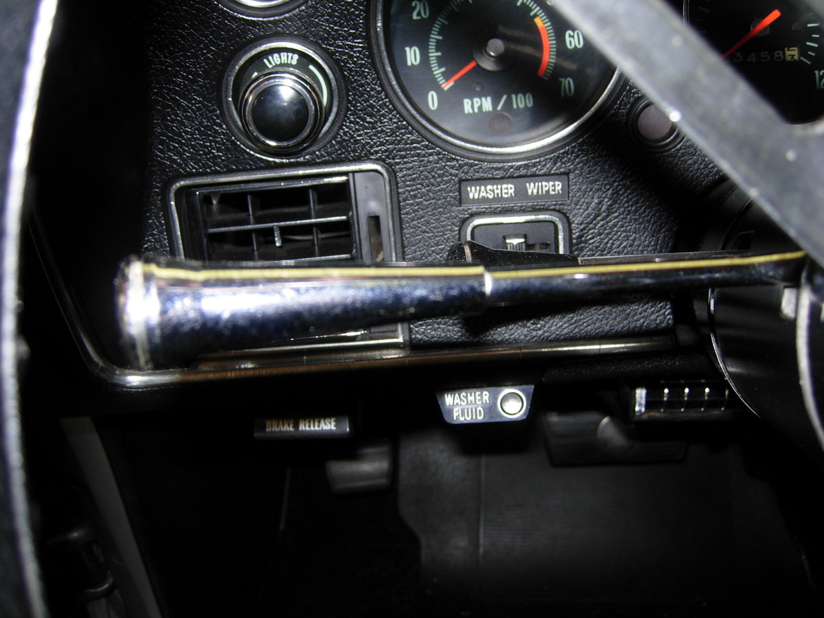

I bought it new in 71, cruise showed on the options list. Never looked for a build sheet, owned it from 71 to 81. It was a GM cruise and looked like the pictures posted?
Thanks for the pics Jerry, much appreciated!! ... Pictures really are worth a thousand words!!
 The vacuum canister that you are referring to is the servo that has the cable attached to the back side according to my 1970 Monte assembly manual. Which  brings me to my next question, does anybody know who restores cruise control servos for our Monte’s?image.thumb.jpg.a1c3bee855b474d7a6cfab85a57993f6.jpg
I made a mistake when I said the server was mount on the firewall it’s on the inner fender like the 72 I was thinking of a 68 impala I saw so the only difference is the chrome lever in 70 and the linkage to the carburetor with the chain in 70
 Got it ... thanks again for all of your help!!

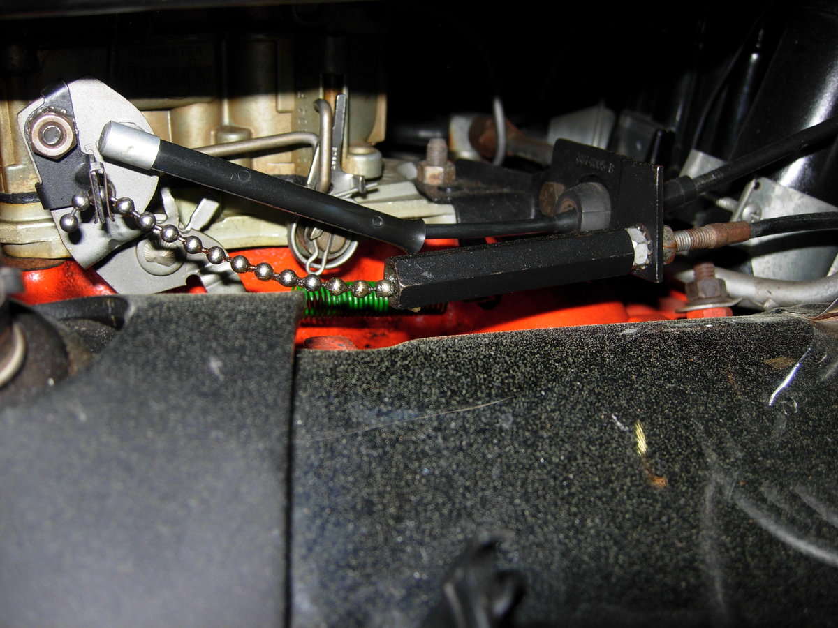

I added it about 30 years ago, bought a used assembly from someone in the old Monte Carlo Owners Association.
I have trouble with it every 3 years or so. I take it (the thing that both speedometer cables attach to) apart, clean it up and then it works!
This picture shows how I attached it to my 350 4BBL (NO A/C)
Bruce, I think the 1970 cars used a chain at the carb. You 1971 car has no chain but I think it's correct for 71.
This is from the 1971 assembly manual.
