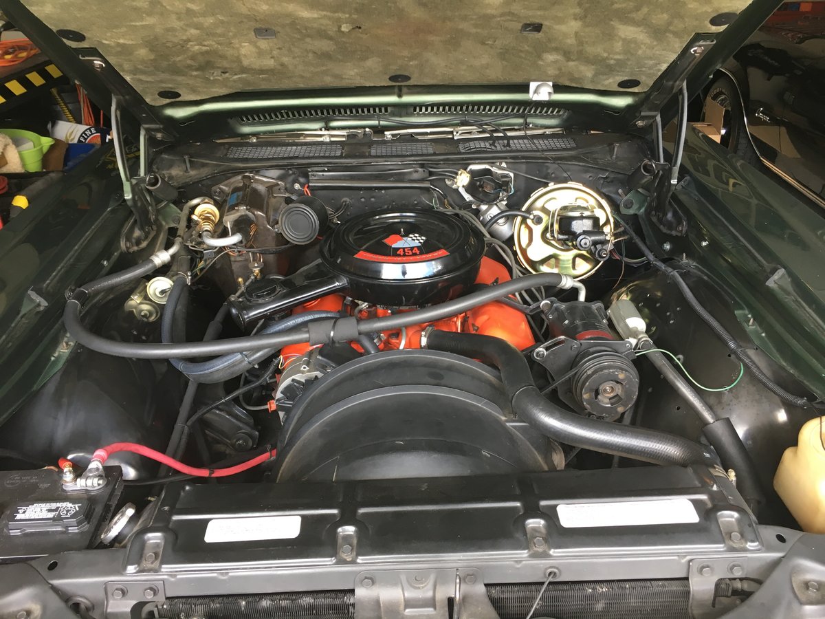

willie Posted June 15, 2020 Posted June 15, 2020 Does anyone know how I route the green wire for the A/C around the firewall to the inner fender well to the compressor. I am hung up by the power booster, I don't know if it goes under or over. I have it going over the booster to the clip and down the inner fender well and to the comp, but its tight and doesn't look right. Any ideas? Quote
Rob Peters Posted June 15, 2020 Posted June 15, 2020 Willie, I wish I could say for sure but I can't. I don't think mine runs over the top of the booster but I can not say for sure. I think mine runs under the booster and is in with the bundle running on top of the inner fender well. Rob Quote
jft69z Posted June 15, 2020 Posted June 15, 2020 I looked in the assembly manual (for a '72). Looks like it follows the harness across the firewall, over the booster, to the clip, then follows the forward light harness along the fender well. I'll post a few pics later when I get home from work. Quote
DragCat Posted June 15, 2020 Posted June 15, 2020 Willie, this is how it looked when I got my 70, not sure if its to spec but it runs over the booster. Quote
Paul Bell Posted June 15, 2020 Posted June 15, 2020 As this wire was added after the body was assembled on the Fisher Body side, the brake booster would have been put on the body first. It would easier to drop the wire over the booster than under and speed is everything on an assembly line. It's also a more direct path for the wire. I'd say the wire belongs over the booster. Quote
jft69z Posted June 15, 2020 Posted June 15, 2020 Just woke up, see if these help. AC-3.pdf AC-1.pdf AC-2.pdf Quote
willie Posted June 16, 2020 Author Posted June 16, 2020 Thanks guys, I ran it over booster and along side of the harness. It was hung up under the wiper motor, I got a couple of inches after that and now it sits and looks better. Thanks everyone Quote
