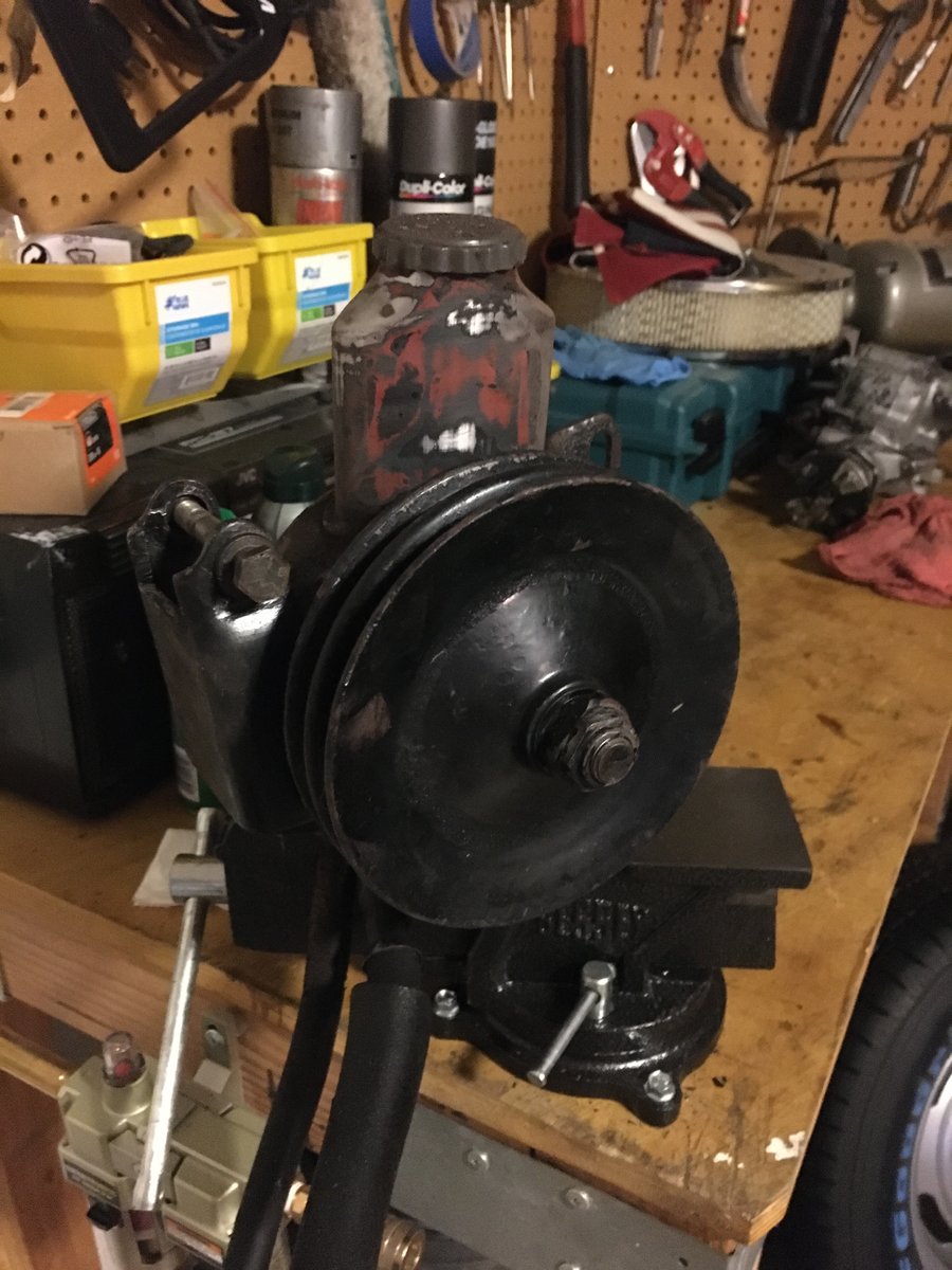

Hey guys is this the correct power steering pump for a 71? Not sure if big blocks got different pumps?
Yes, rounded neck portion of reservoir seems to be for big blocks. The flat faced reservoir was on small blocks.
That is the correct pump for a 71. Big block or small block. Just difference in brackets.

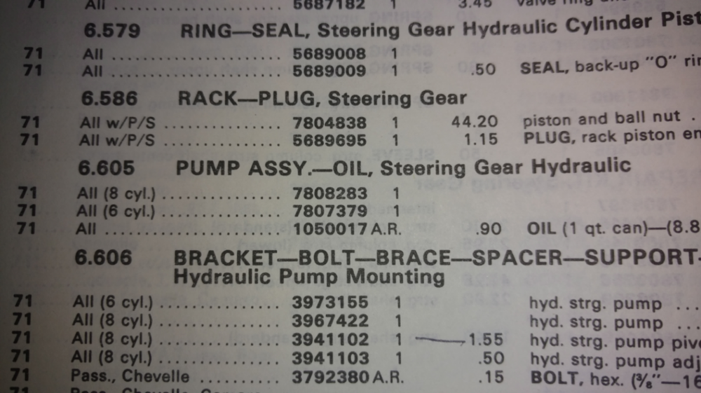

I am blessed with a printed 1971 parts catalog.
Thomas is correct, all V8 cars received the same pump.
