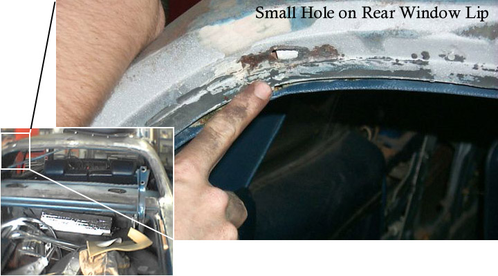

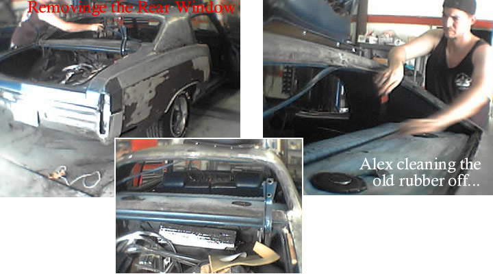

Midshipman Posted April 18, 2004 Author Posted April 18, 2004 Well, KnightFan... we enjoyed the weather ourselves! What a georgeous day to work on a Monte! I arrived at the garage at about 1 o'clock, and Alex and I began immediatly. Â We took a pretty laid back approach today, but still got a lot done. We started by pulling the rear window out (which turns out to be a lot harder than one would think...) Our wire kept breaking as we tried to slice through the window gasket, so we ended up prying it up ever-so-carefully with a few prybars. Â Â After we got that taken care of, Alex showed me how to weild the sander, and off I went to see what was underneath the paint on the passenger door. Unfortunatly, we found a TON of body filler on the entire passenger side... but it appears the job was done quite well. So it will hopefully not be too big a problem. (See all the "White" in the pics, body filler) Â Also, it turns out the rot around the Rear tire-wells is worse than first expected. I'm gonna need a patch panel or two to take care of these problems. And although it isn't shown in the picture, the front part of the passenger rear well is in pretty bad shape. Â Â The Driver's side is a little better than the passenger's: Â While I was happily sanding away on my door, John (who owns the garage we are working in) came out and singlehandedly stripped the paint off the entire driver's side using only a RAZOR BLADE! I was impressed. The car was blue, I go to work on my door, come back over to the other side a few minutes later and the car is suddenly a smooth primer-brown! It was really amazing! Of course, we'll still have to sand down that primer... but wow! Â Then it was time for some brake-work. We installed my brand new Rotors and Pads, which was a first for me! So I learned something usefull today. When we pulled the believed-to-be-original rotors off the car... it was amazing the Monte had even been able to stop! There was a quarter-inch groove ground into the driver's side rotor! [and yes, this was damage, it was in addition to the nice smooth "cooling groove" that each rotor had been originally manufactured with] Â After we got the brakes fixed up a little, Alex helped me pull the rear bumper off and he began to remove some of the smaller trim items that were still on the car. Â So basically, we had quite a productive day! Before I knew it, it was 8pm and I still had a 2 hour drive to get home! Time sure does fly when you're having fun! Â I really appreciate your help guys, and a special thanks to Alex for his gentle kindness towards a dumbstruck tinkerer who was in WAY over his head this afternoon. Â The progress is comng along nicely, I almost didn't recognize "Molly" when I saw her... no top, very little paint, no trunk or hood... and the rear seat removed... Things are coming along nicely! Â I'd like to once more express my thanks to Alex, Charles, Charlie, and John for all they are doing for me! I'd be in a world of hurt if it wasn't for this club.

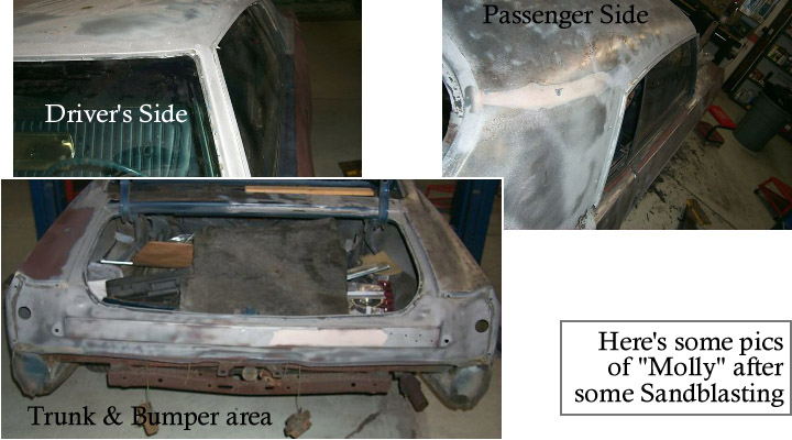

alex's72fgmc Posted April 19, 2004 Posted April 19, 2004 well that ok cort i will get drunk for ya lol  Oh billie i have some more pics for ya coming your way "the after shots of the sandblasting of the rear and front sections around the vinyl top pins and side channels.  charles used up 1000 lbs of sand blast sand on his project "the camaro" and some on the monte... we recovered 8 bags from the 20 used ouch ...  alex
Midshipman Posted April 19, 2004 Author Posted April 19, 2004 Oh billie i have some more pics for ya coming your way "the after shots of the sandblasting of the rear and front sections around the vinyl top pins and side channels.  charles used up 1000 lbs of sand blast sand on his project "the camaro" and some on the monte... we recovered 8 bags from the 20 used ouch ... And here they are, folks... for everyone to see! Here's the Front of the Monte after some sandblasting:  And then, some varying angles on the car...  And last but not least, it appears the sandblasting discovered a small little rust problem on the Rear Window Frame:

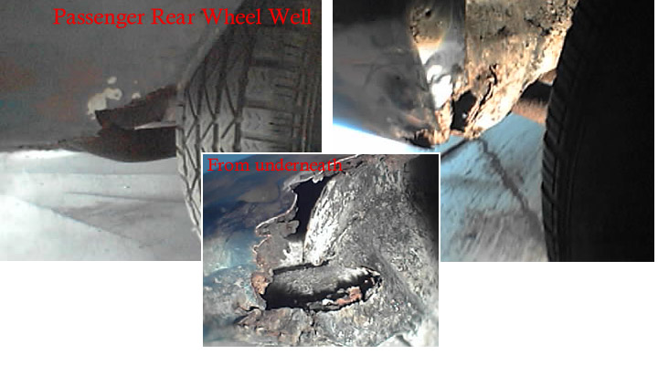

Midshipman Posted April 22, 2004 Author Posted April 22, 2004 Well, I will not be able to make it down this weekend (24 - 25 APR 04). There is the slightest of chances I may have Sunday free, but I wont know until Saturday afternoon.  So I guess I wont be there guys  On a plus note, I asked for my birthday gifts in cash this year... so I can put em into "Molly".  So the budget has increased a little bit, let me know if we need anything. I'm still looking for patch panels on the rear's rust problems... I'm thinking we may have to fabricate em.  Also, I was a thought: I'm thinking we do something to rustproof the underside after we get the work done down there. What do you guys suggest? I know I can buy the stuff in aerosol cans and just spray it down there, does that stuff work OK? or should I get some POR-15 to put down there?

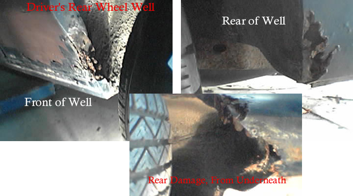

Midshipman Posted April 27, 2004 Author Posted April 27, 2004 Charles gave me a call last night and told me that basically the driver's rear quarter is crap... Â Apparently it's got a ton more bondo than we'd like... So should I just try and find some whole new quarters? About how much is that going to cost me? Â Or how bad is it? Can somebody lemme know some more info on it? I was in the middle of WWIII with my roommate who is stiffing me on the bills, so I couldn't talk to him too much last night. Â Also, it looks like I will be coming out there this weekend if you guys are going to have time to work on her with me. What day works best for you guys? And who else will be able to come down and join!? (If anybody...)
