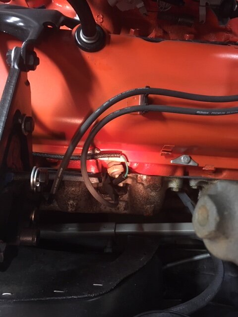

willie Posted August 1, 2020 Posted August 1, 2020 Ok guys this is what i have again this is a '72 BB car. This is the drivers side with a clip om connector and a solid green wire This is the passenger side with only 1 terminal and a green and white wire and just for the heck of it i took a pick of the TCS wires behind the carb (not completed yet) Hope it helps!!!! Sorry for saying it was a double terminal, its not. Quote

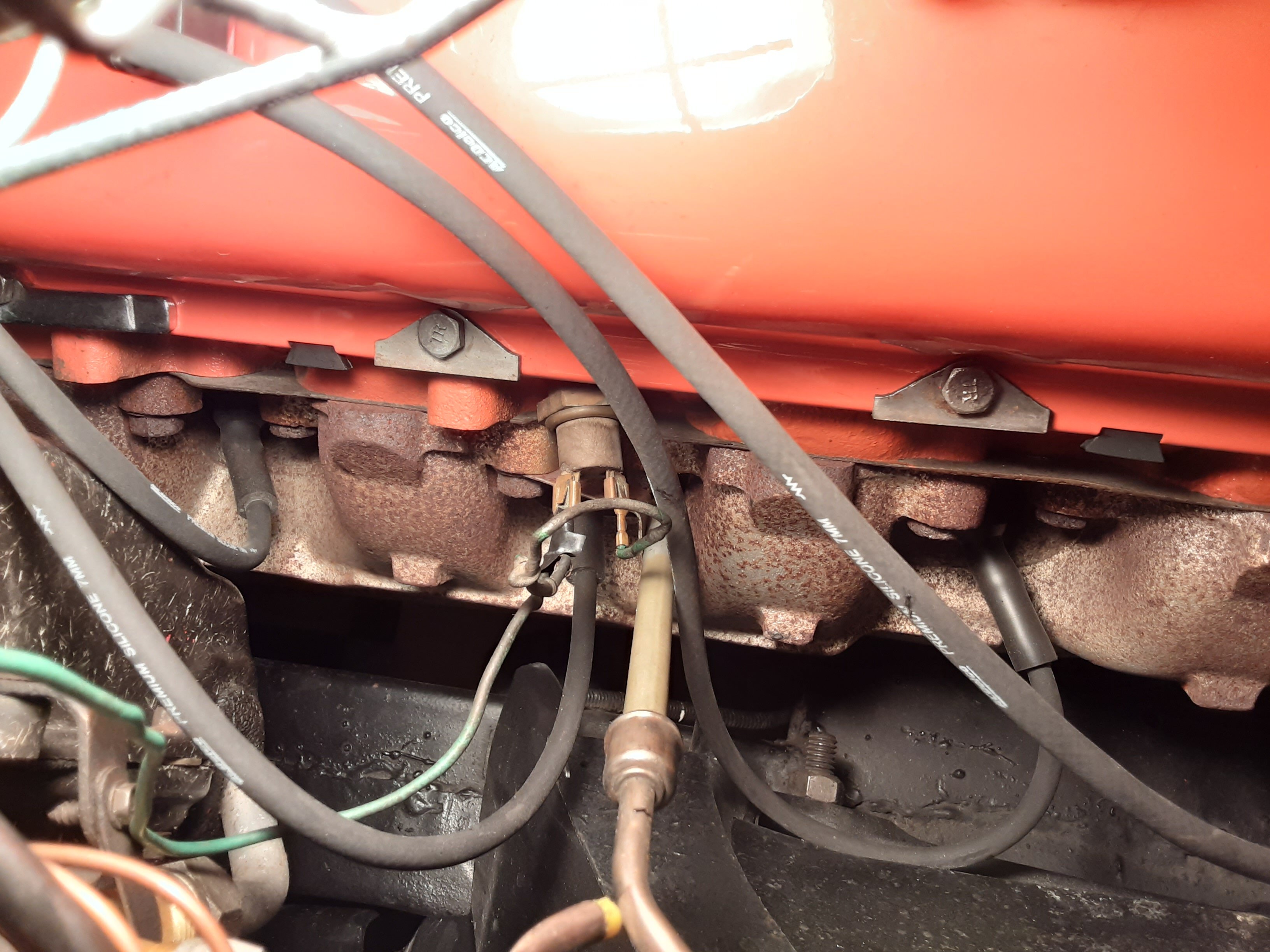

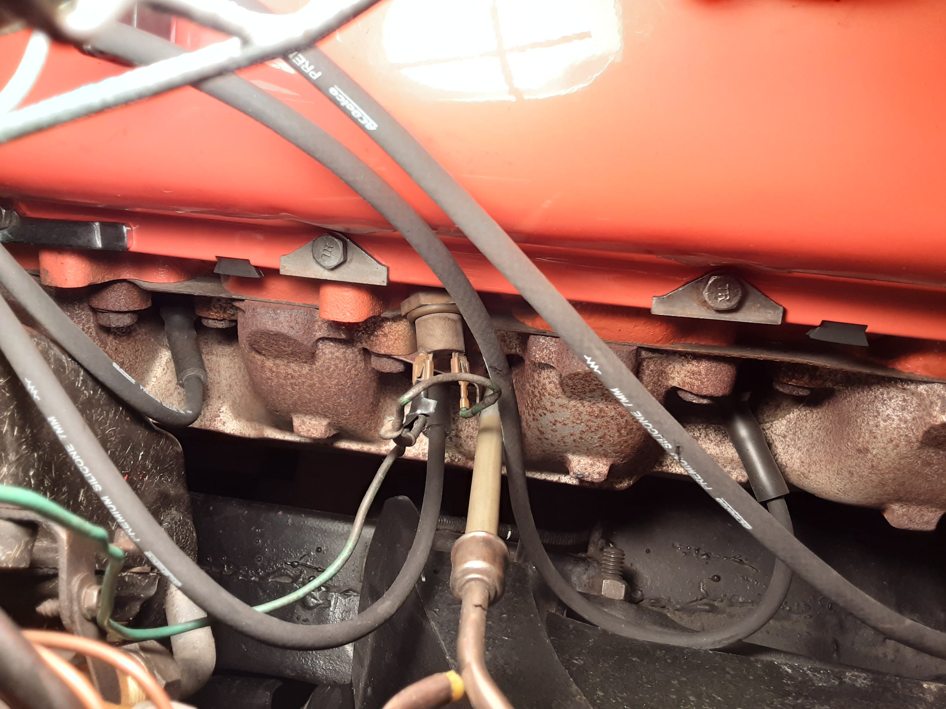

1970mcss Posted August 1, 2020 Posted August 1, 2020 So as I posted earlier, my car has a 2 wire sensor. The wire has a a jumper to the second terminal. I don't know what the prior owner did to the car but he told me he replaced the engine harness but the wire to the tcs looks original Quote

Dtret Posted August 1, 2020 Author Posted August 1, 2020 Ok that makes more sense. I don’t have to come up with a second wire. So 70 has 1 wire drivers head and two wire pass head. 72 has 1 wire driver head and 1 wire pass head. Not when I go to purchase a tcs sensor for a 71 the books show two wire. That’s where all my confusion started from. I can make 1 wire each side work(I think). Anybody with an original 71 want to chime in? Paul. Can you (not now but sometime) check the wire that is running right up the dipstick tube ( looks brown but green by the terminal) which I assume is the jumper and see what it connects to ( the tube is blocking it). Thanks Dennid Quote
Dtret Posted August 1, 2020 Author Posted August 1, 2020 29 minutes ago, willie said: Ok guys this is what i have again this is a '72 BB car. This is the drivers side with a clip om connector and a solid green wire This is the passenger side with only 1 terminal and a green and white wire and just for the heck of it i took a pick of the TCS wires behind the carb (not completed yet) Hope it helps!!!! Sorry for saying it was a double terminal, its not. I don’t even have a connector like that ???? I think my car is broken😆 Quote

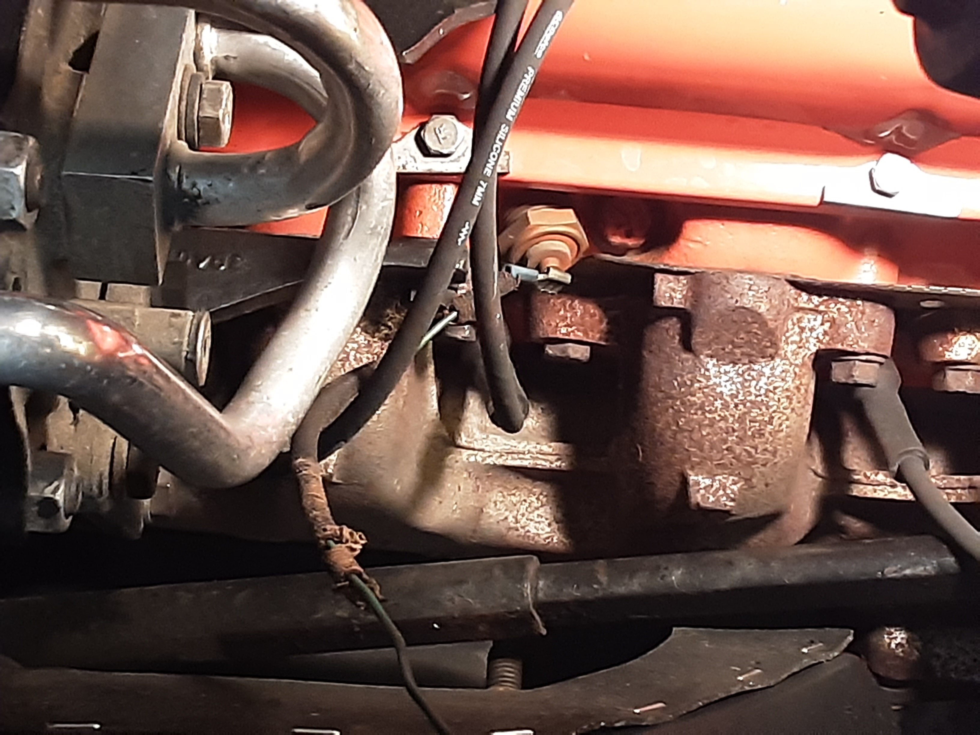

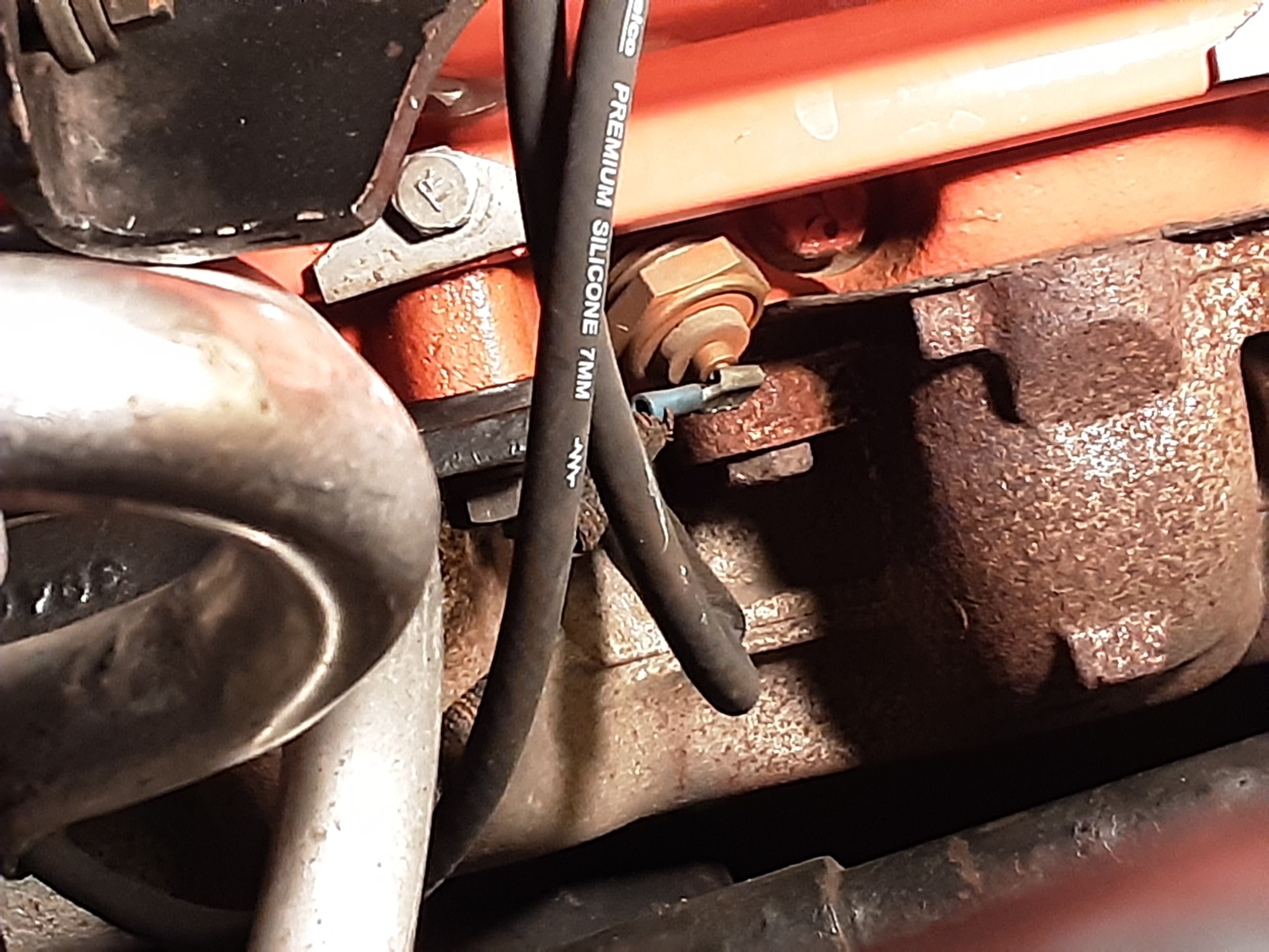

1970mcss Posted August 1, 2020 Posted August 1, 2020 Dennis, no problem doing it now. I was just watching a little Cubs baseball. The wire looks brown but it is green. I need to re-wire or clean that up a little. I moved the wires a bit to take a couple pictures. Hope it helps. Quote
Dtret Posted August 1, 2020 Author Posted August 1, 2020 Thank you. I was watching the reds. That makes more sense now because I also just found this and if you follow this harness you can see the jumper 1 Quote
Dtret Posted August 1, 2020 Author Posted August 1, 2020 This make sense because that wire looks long enough to connect under the brake booster Quote
Dtret Posted August 1, 2020 Author Posted August 1, 2020 I agree with Willies pics also because if your adding a jumper then why do you need a two wire sensor just run s single wire to the connector under the booster Quote
