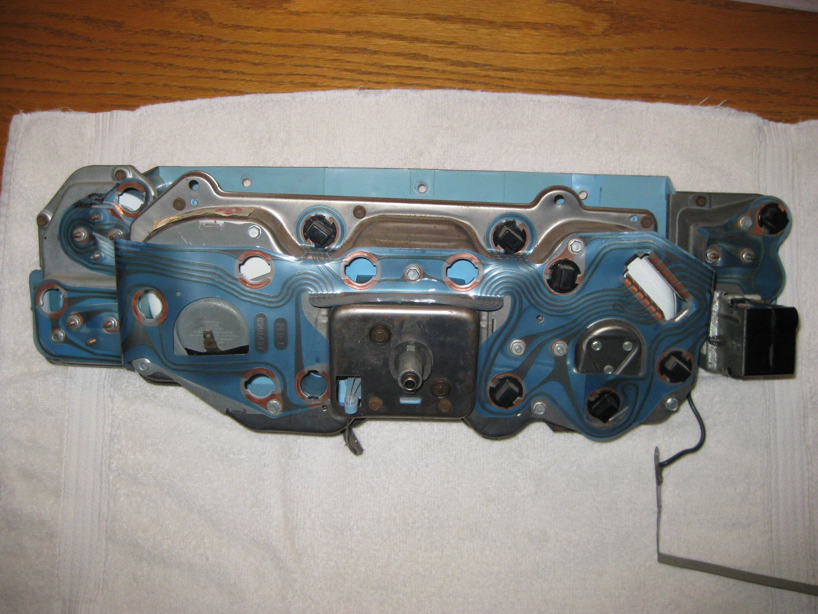

These Monte's came standard with idiot lights.  The gauge dashes an option and the circuit boards and wiring were different.
Picture of my 71 factory gauge package that I swapped with another 71 350 Monte. I also swapped ALL the wiring because it was different.
Ft picture:
IMG_0745.thumb.JPG.49132272730289b6bc9bcf3829eac4f5.JPGIMG_0746.thumb.JPG.ede9c0ccfc048bacdd61f0f38402dafa.JPGIMG_0747.thumb.JPG.cf8464c016dc1ff043990b3ebab5a7c7.JPG

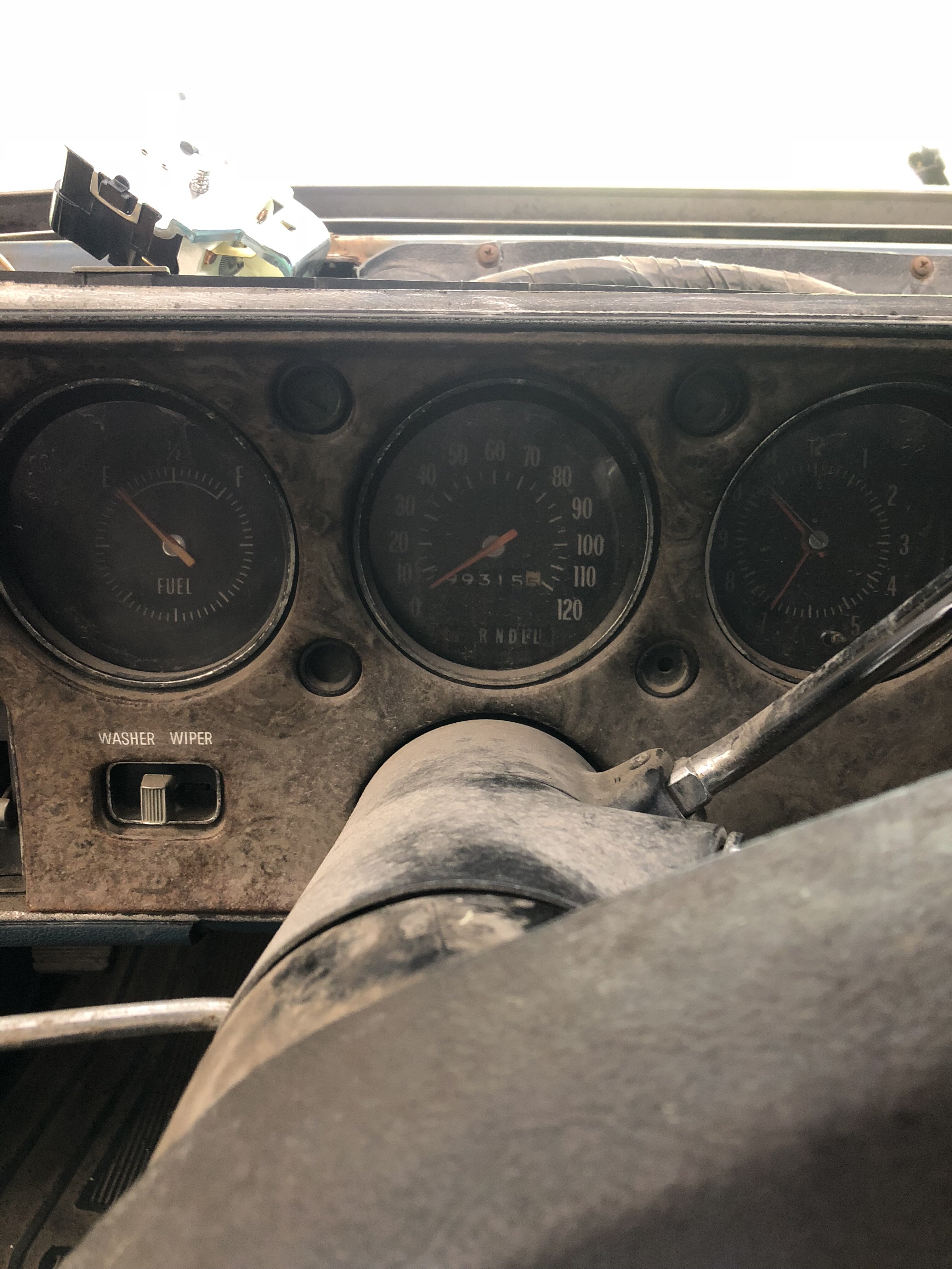

Hi i have a 1972 monte and i just purchased an SS cluster. I would like the tach to be functional. How do i do this?
A lot depends on what cluster you purchased and what other changes were made to the car. Ex distributor.
Tim, If you are new to First Gen Monte's you will soon find out that there is no such thing as an SS Dash  in first gen Monte's.  The gauge cluster was with gauges rather than idiot lights was an option on all three years.  The major difference on the gauge setup's was in the Tach because the red line was different between big block and small blocks.  Many Chevelle people will refer to it as an SS Dash because the SS Chevelle had the dash setup similar to the Monte with the round gauges rather than a sweep style speedometer.
As far as what else would need to make the conversion, I have never done one so I will let someone else answer.   As you can see, Dennis already let you know that more information is needed.
