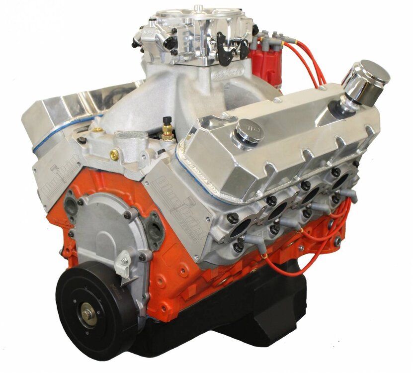

Andy's Auto Posted September 22, 2020 Posted September 22, 2020 You could do one of these 632 thingys. Ordered one for me Malibu last week. 3 Quote
Michael Boyte Posted September 22, 2020 Posted September 22, 2020 Been looking at the Shafiroff 632 pro series 9 degree myself, 1295 HP @ 7500 rpm. They have a pump gas version that produces 945hp @ 6300rpm 3 Quote
Andy's Auto Posted September 22, 2020 Posted September 22, 2020 43 minutes ago, Michael Boyte said: Been looking at the Shafiroff 632 pro series 9 degree myself, 1295 HP @ 7500 rpm. They have a pump gas version that produces 945hp @ 6300rpm This one is pump gas 815hp. Complete with a 4500 Sniper and install kit. it was $14349 shipped. Hope to see it Weds. 2 Quote

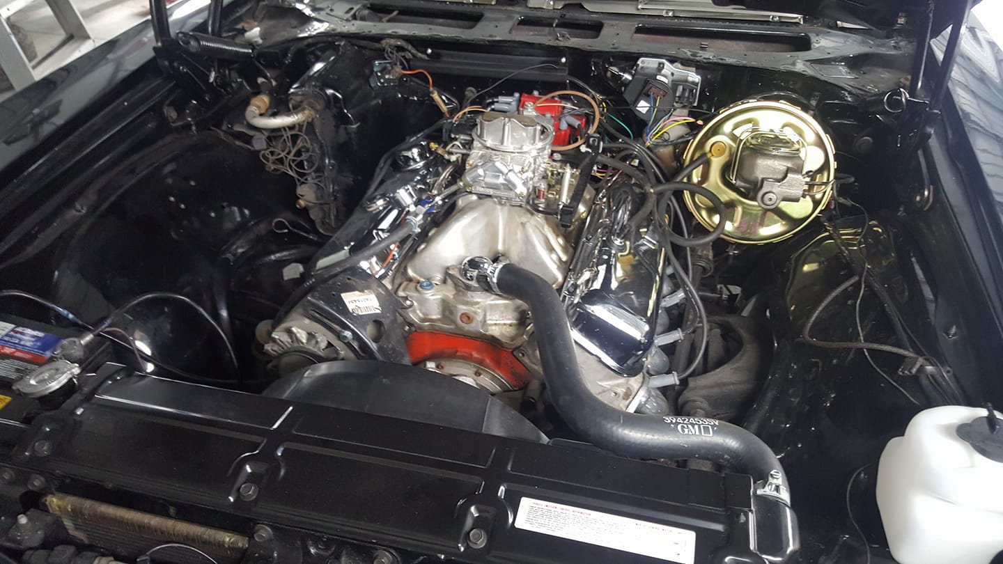

Andy's Auto Posted September 23, 2020 Posted September 23, 2020 8 hours ago, MC1of80 said: Something like this? I see sneaky valve covers! 1 Quote
Andy's Auto Posted September 23, 2020 Posted September 23, 2020 And this excites me. Showed up at one yesterday. 1 Quote
cny first gen 71 Posted September 23, 2020 Posted September 23, 2020 59 minutes ago, Andy's Auto said: And this excites me. Showed up at one yesterday. That's purdy 😀 good to see you posting again Andy. 1 Quote
MC1of80 Posted September 23, 2020 Posted September 23, 2020 Sneaky valve covers? Lolol what is sneaky about them? They are stock valve covers. 1 Quote
Andy's Auto Posted September 23, 2020 Posted September 23, 2020 49 minutes ago, MC1of80 said: Sneaky valve covers? Lolol what is sneaky about them? They are stock valve covers. Shore seems tall! Quote
Andy's Auto Posted September 23, 2020 Posted September 23, 2020 There's a lot of Jesel going on under those 70 454 Chevelle valve covers! Quote
