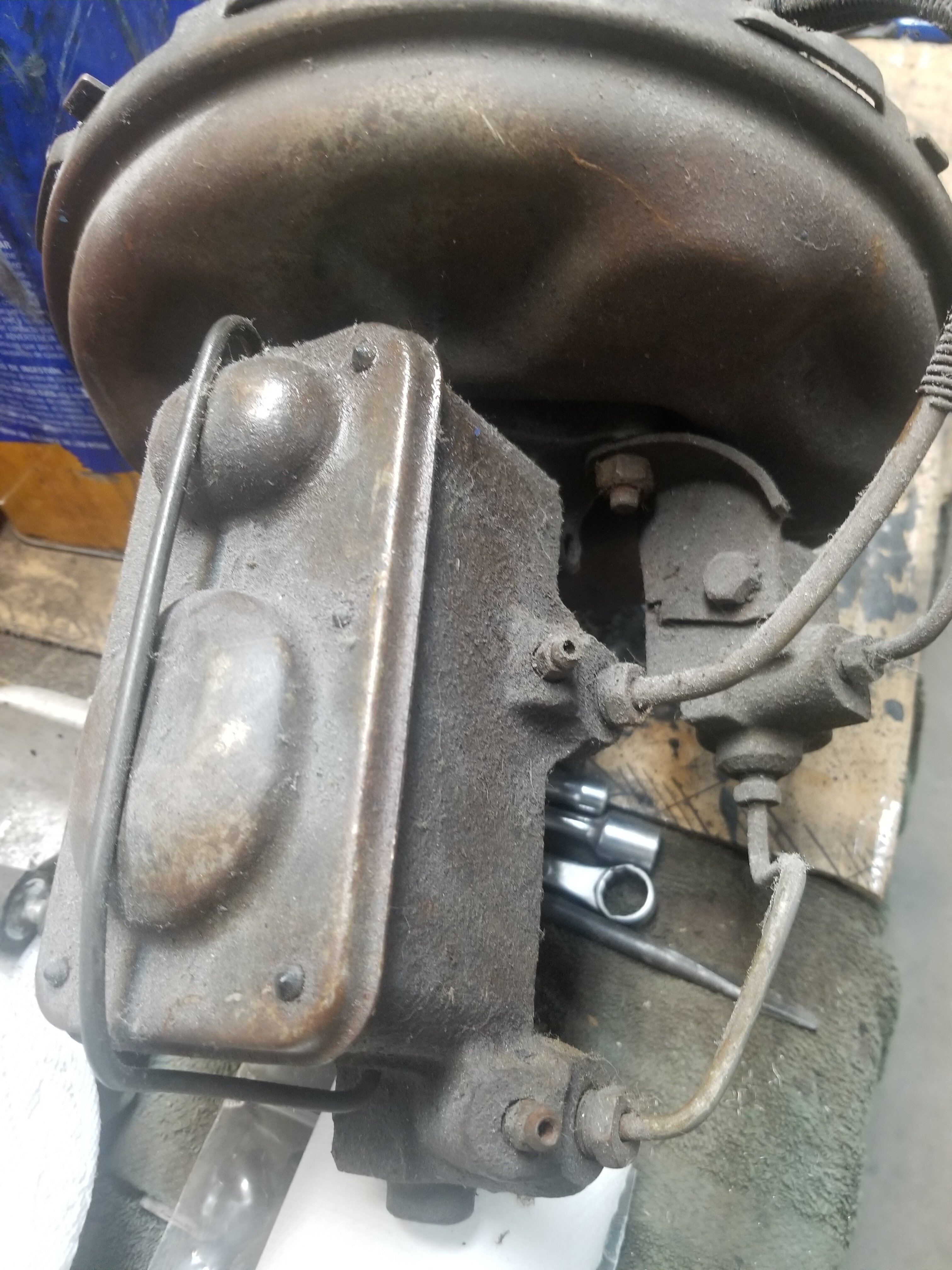

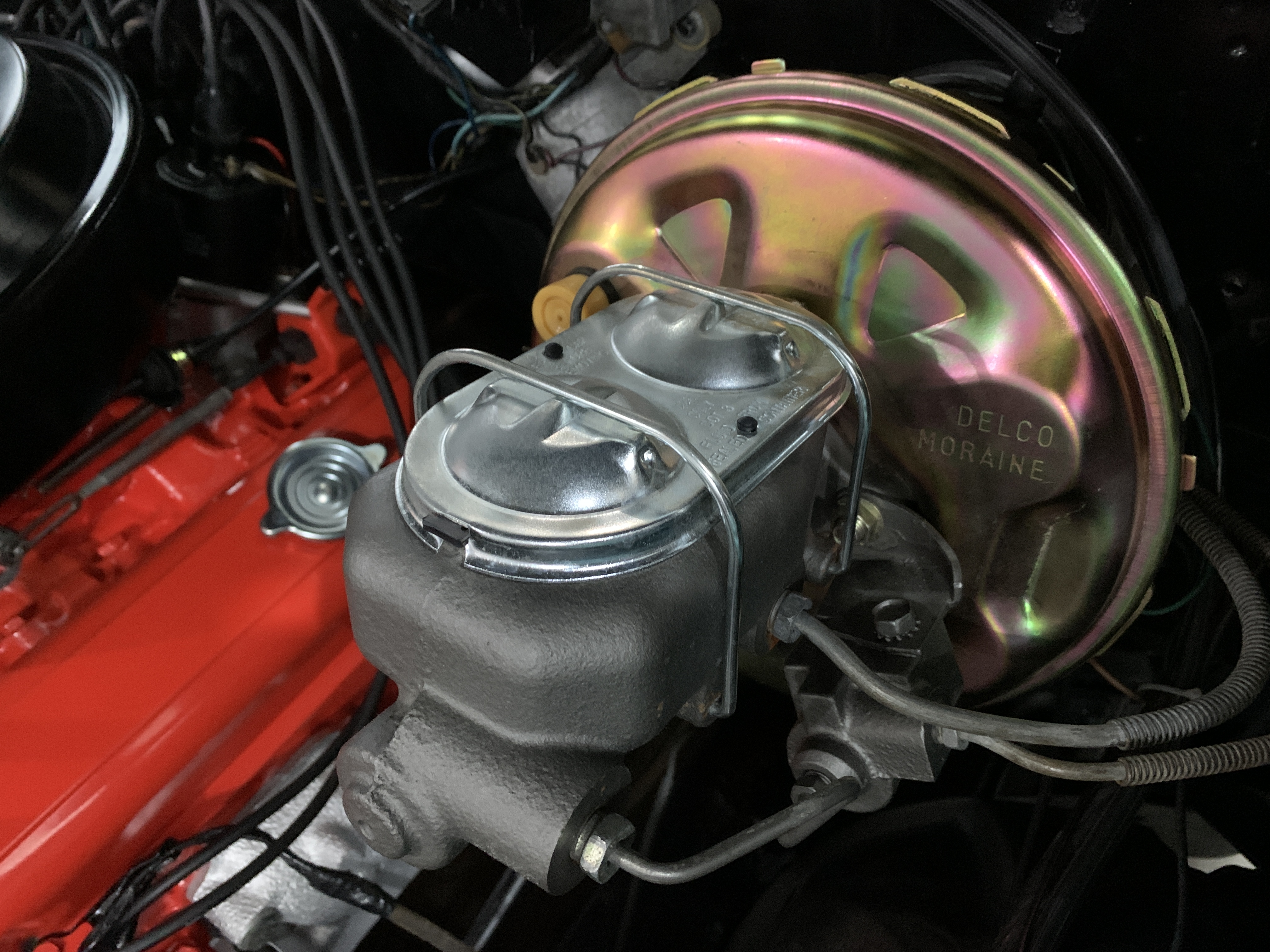

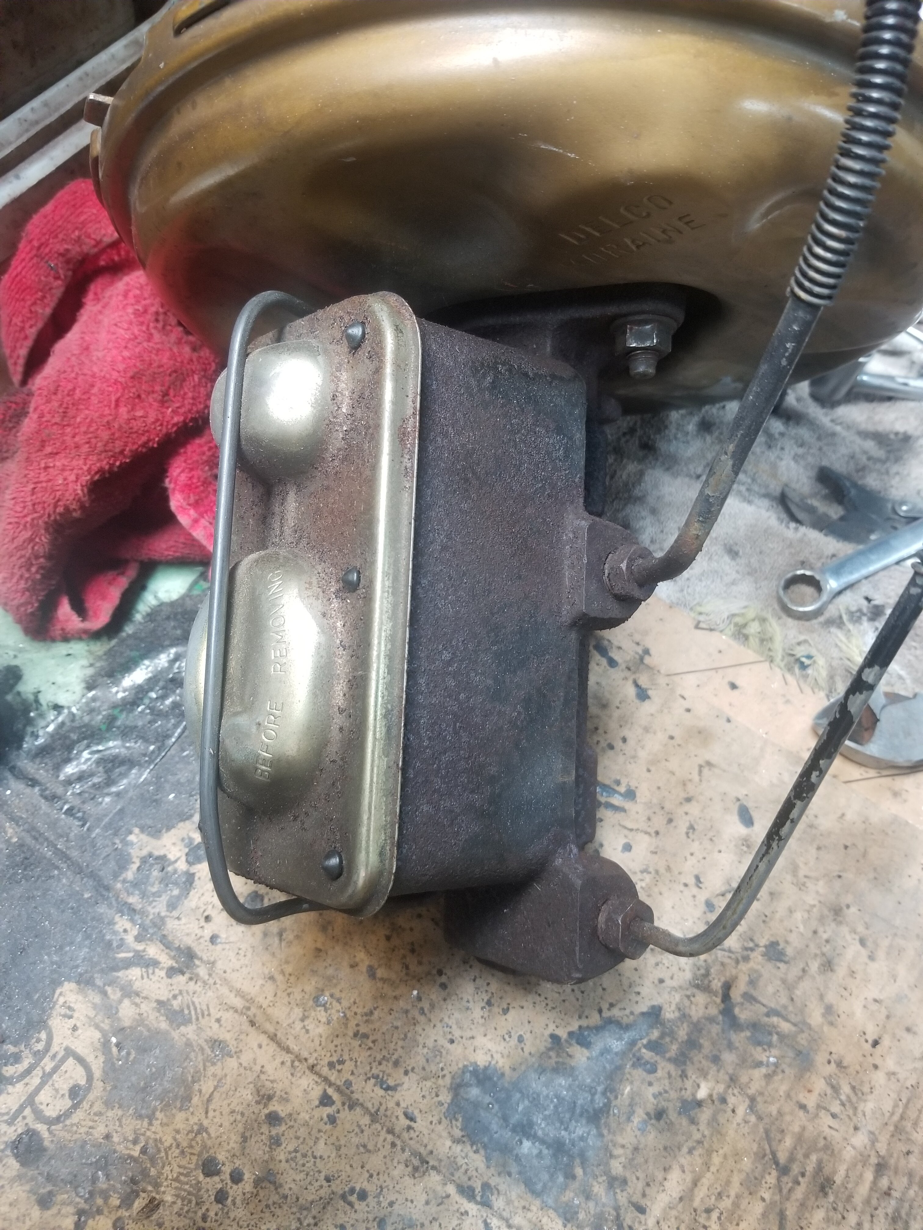

Mike Brichta Posted September 24, 2020 Posted September 24, 2020 I would like to replace my Brake Booster and Master Cylinder on my 70 Monte. I notice that there is an additional component on a 70 Monte booster that my 72 Monte booster does not have. What is this extra device on a 70 Booster and what does it do? Do I need to keep it or can I chuck it? I only ask because my 72 Monte does not have one. See pics below. The first pic is from a 70 booster and the second from a 72 booster. Also I see that I can purchase a 9" booster instead of the normal 11" booster. Are there any pros and cons to going with the 9" one to gain some space? Thanks!! Mike Quote
MC1of80 Posted September 24, 2020 Posted September 24, 2020 Mike. That is a brake residual valve. For the Montes, only the 70 had it. If I remember correctly, it slows the brake fluid pressure as to not lock up the rear wheels during braking. Maybe if you swap out the proportioning valve from the 70 style to 71 style, you can remove the 70 valve under the master. I would check the wheel cylinder and master cylinder bore diameters before I swap it out. 2 Quote
Mike Brichta Posted September 25, 2020 Author Posted September 25, 2020 Based on what you said, I guess it wouldn't hurt to put it back on. Is there any way to test it to see if it is working correctly? Thanks!! Quote
Canuck Posted September 25, 2020 Posted September 25, 2020 I pit mine back on when I replaced the booster and master a couple years ago. Quote
Dtret Posted September 25, 2020 Posted September 25, 2020 1 hour ago, Mike Brichta said: I would like to replace my Brake Booster and Master Cylinder on my 70 Monte. I notice that there is an additional component on a 70 Monte booster that my 72 Monte booster does not have. What is this extra device on a 70 Booster and what does it do? Do I need to keep it or can I chuck it? I only ask because my 72 Monte does not have one. See pics below. The first pic is from a 70 booster and the second from a 72 booster. Also I see that I can purchase a 9" booster instead of the normal 11" booster. Are there any pros and cons to going with the 9" one to gain some space? Thanks!! Mike If you decide to replace the master cyl let me know because I think that is the correct one I need for my 71 Thanks Dennis Quote
Paul Bell Posted September 25, 2020 Posted September 25, 2020 Mike, unless you need clearance for big valve covers on a big block, you should stay with the original full sized booster. As your master cylinder looks to be the correct original with bleeders, you should have a local shop rebuild it. Any traded in rebuilt unit won't have the bleeders. There was a discussion a few months back about the valve you're asking about. It's a residual pressure valve to keep a few PSI in the line to the rears to prevent the springs from fully retracting the shoes. There's also a valve in the rear that slows the buildup of pressure which allows the front brakes to grab first. All 1970 stuff, 71 & 72 didn't have either valve. 2 Quote
Mike Brichta Posted September 25, 2020 Author Posted September 25, 2020 Thanks guys for all of your input. I am always impressed in how much your guys know about these little details. I learn something new every day. So I guess what I am hearing is all (3) of the 70 pieces (proportioning valve, residual pressure valve and rear pressure value) should all be used together and don't remove one without the others? And they are only on 70 models. 71-72 do not use these extra pressure valves. Does that sound about right? Thanks!! Mike 2 Quote
Paul Bell Posted September 25, 2020 Posted September 25, 2020 Yessir, they all work together for a 1970 car. I think the 71/72 master cylinder takes care of the duties of the two line valves used on the 1970 car. Quote

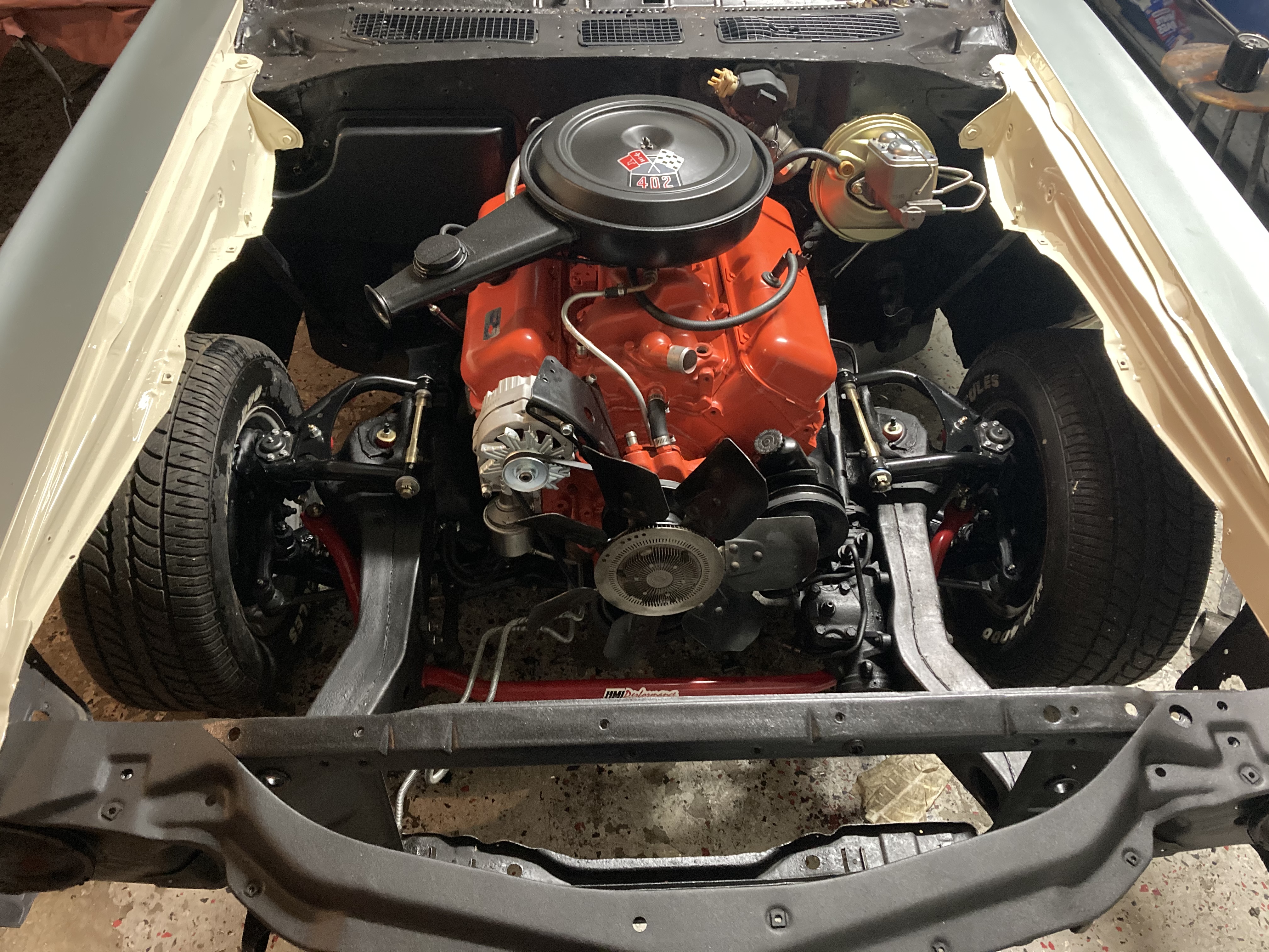

MC1of80 Posted January 5, 2023 Posted January 5, 2023 Like Joe, I also have a vacuum pump on "Big Red". Located under the driver's side fender behind the windshield washer reservoir. 9" dual diaphragm booster and 3/4 spacers between the head and stock valve covers. At the time the "cheater" valve covers were not produced. 2 Quote
Steve G Posted January 6, 2023 Posted January 6, 2023 18 hours ago, MC1of80 said: Like Joe, I also have a vacuum pump on "Big Red". Located under the driver's side fender behind the windshield washer reservoir. 9" dual diaphragm booster and 3/4 spacers between the head and stock valve covers. At the time the "cheater" valve covers were not produced. I’m running a 9” booster with what I would assume is the “cheater” valve covers (3/4” taller) I could have got away with a standard booster but the extra room is nice. 2 Quote

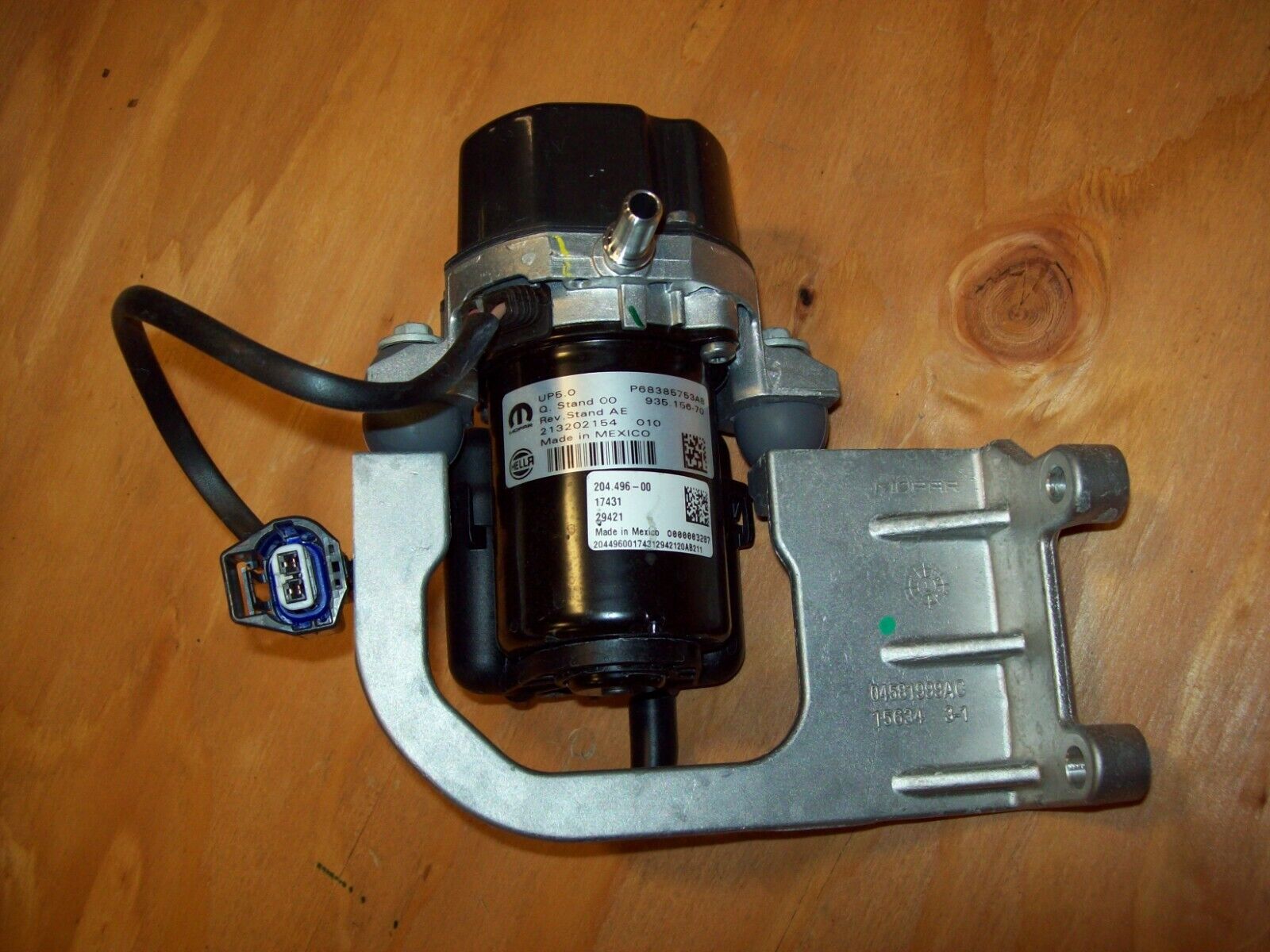

Paul Bell Posted January 7, 2023 Posted January 7, 2023 My car has a dual diaphragm nine inch brake booster. It’s pretty much equal to the stock single diaphragm unit when it comes to adding “power” to your brake system. My camshaft doesn’t produce much vacuum so I needed a fix. I would hate having all the extra hoses for a hydro-boost setup so I began studying electric pump systems. As it turns out, many vehicles today have electric vacuum pumps, GM, Ford, Subaru...they’re pretty compact and are often used to help a car have better brakes. From what I can tell, almost all of them are supplied by Hella. Ford has they’re own designs and they’re pretty poor. There’s four different Hella pumps, small to large. The largest one, the UP5.0 can provide vacuum for a brake system without any engine vacuum and usually come on trucks. This is the same pump that’s used in the very expensive Master Power Silent Drive vacuum pump. The Hella UP5.0 is used in some Dodge pickup trucks, part number 68385753AB. Search this number on Ebay and you’ll find it for about $65.00. The pre-made kits like from Master Power, Leed etc. are ready to go with a universal bracket, vacuum switch, relay and check valve. If you want to use the UP5.0 pump on it’s own, you’ll need to add these components. Superior Transmissions makes an adjustable vacuum switch, K058 which is about $44.00 on Amazon. The relay is any standard 12 volt relay and nice aluminum inline vacuum check valves can be had on Ebay in a variety of hose sizes. The Ebay Dodge pump comes on a bracket with rubbers between the pump and the bracket. You’ll probably make up some sort of bracket but you should still use the rubbers. I made up a bracket and it’s mounted in the fender behind the washer fluid jug, it’s out of sight. I recommend the largest vacuum reservoir can you can find and fit in the fender-or several of them. The system works pretty good on my car-and I have a large master cylinder with a 1-5/16" bore to move enough fluid for six piston front & four piston rear calipers. BTW, I’m thoroughly convinced that the engineers at Wilwood know nothing about brake hydraulics. Pic is the Hella UP5.0 on the Dodge truck bracket. 3 Quote
