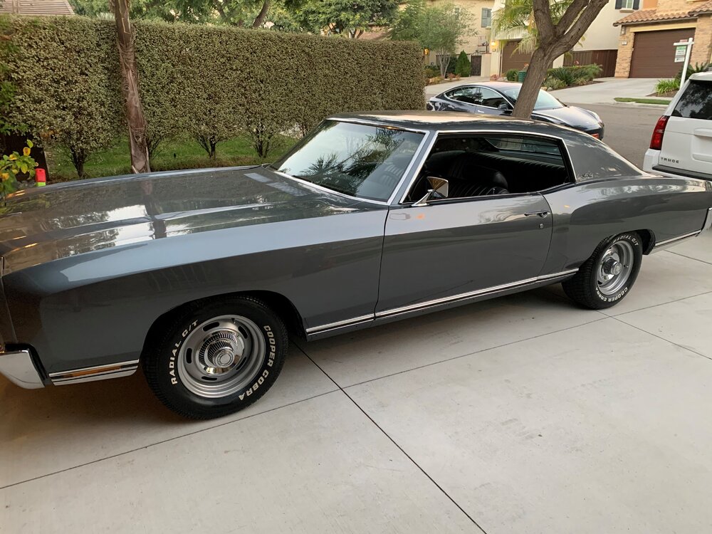

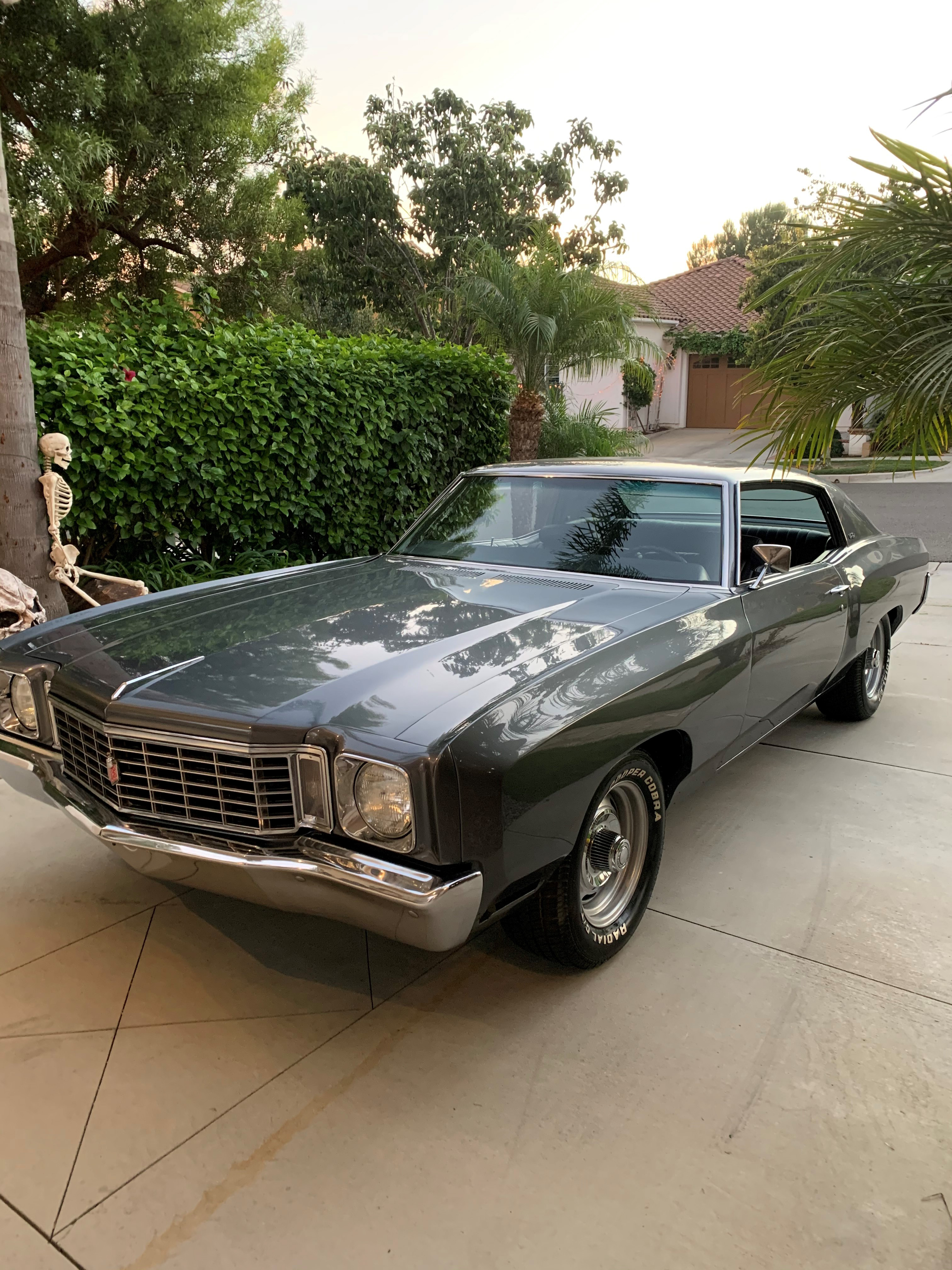

Correct...the car was my Dad's and it was originally a 350 manual 3 on the tree...when my parents gave it to my brother to drive in high school he converted it to an automatic and put a 350 Blazer engine in it. I also drove the car in high school and first year of college, then we sold it in 92'. The car was long gone, but I got a wild idea in 2013 to try and find it (because my Dad was sick) and tracked it down (it was still in AZ) and convinced the owner to sell it back to me (with extra $$). Wish it was still manual and OG engine, but I count my lucky stars that I was able to get it back. Here are a couple of recent pixs + one of the day I picked it up in AZ and was able to give my Dad one last spin around the block in it...it's come a long way for sure. Now I just buttoning up all the details.

Real nice, glad you got to take your dad for a spin too.

Great story, happy you found it.
