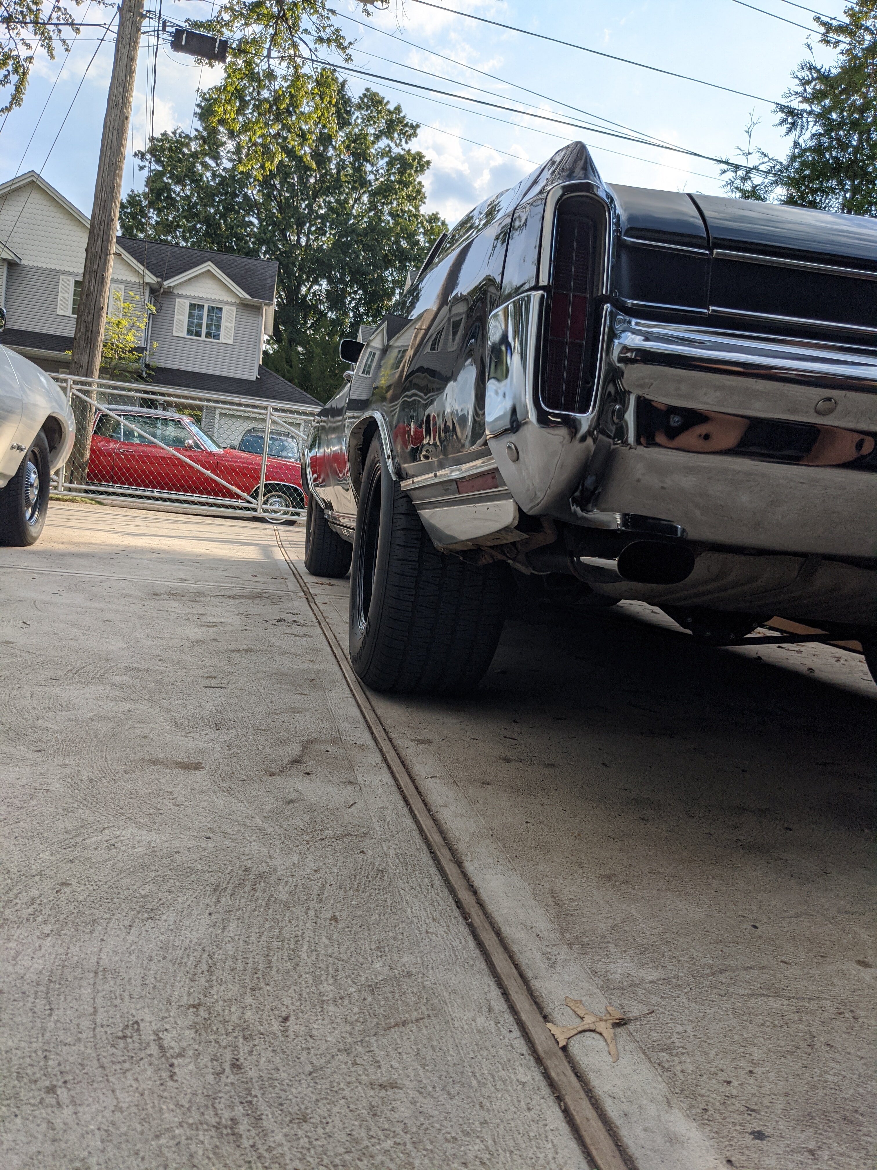

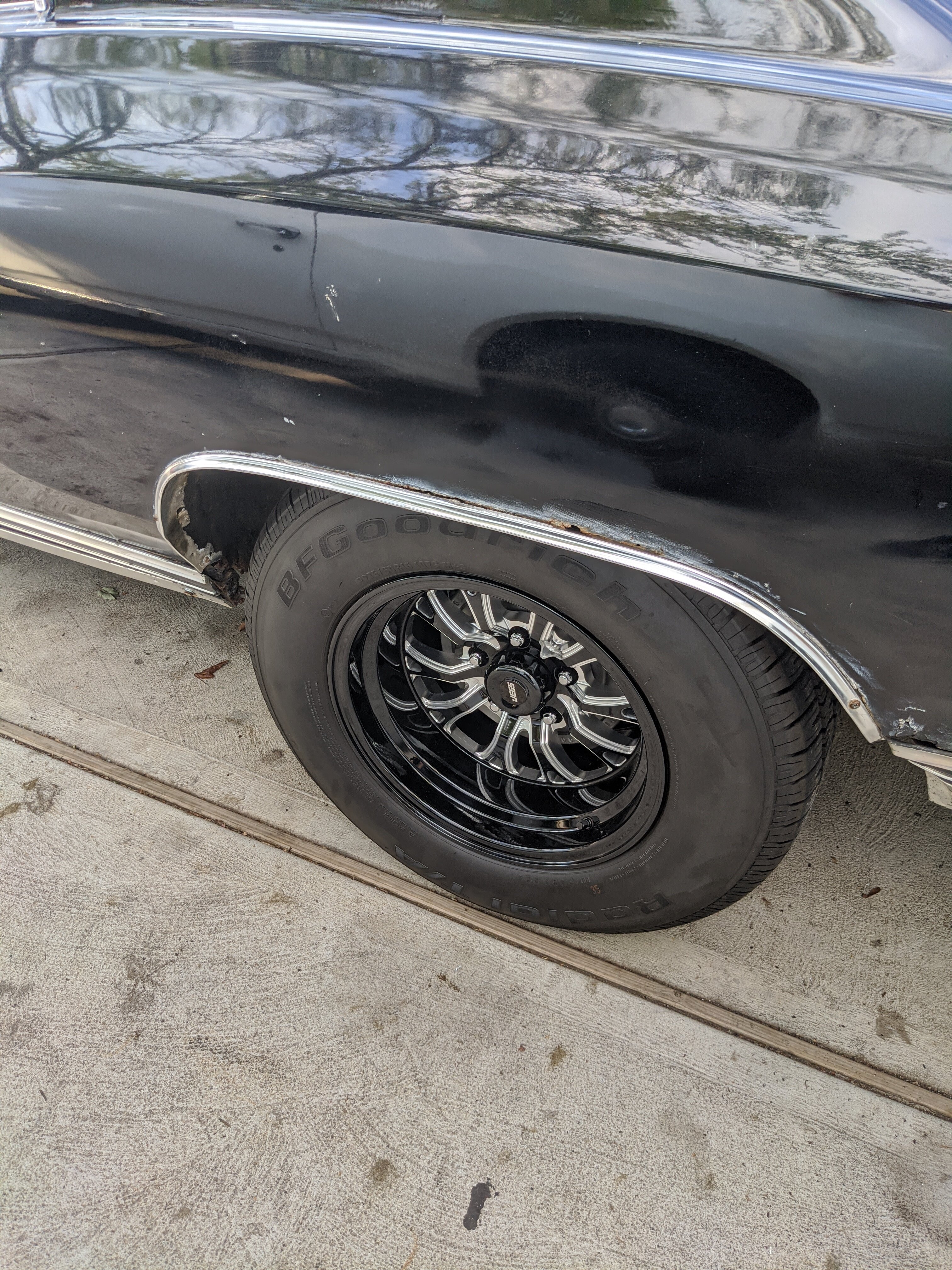

Doesn't matter on the tire manufacturer. All basically the same dimensions for the same size tires. The 5 inch backspacing is your issue. Even with a 275 you will most likely rub bad on the quarter panels. My son has a 275/60r15 on a 15x10 rim with 5 1/2" backspacing.
Thanks for the pictures! So the wheels themselves shouldn't be a problem? I mentioned Mickey Thompson because the sizing is different. 275/60 r15 is 10.8 inches wide 28 tall ,where I can get MT in 28x10 or 10.5...

Tom, if you zoom in on the last pic, you will see very little space between the tire and what's left of the outer lip. The wheel wells are rotted on my son's Monte also.
With the rim you mentioned, it will be 1/2" towards the wheel lip MORE than the one pictured on my son's Monte.
Can you make it fit, sure. But will it be worth it? My "guesstimate" would be that you would have to trim the wheel lip flush with the outer quarter panel and it still MAY rub.
Truly only one way to find out. You asked for opinions...
