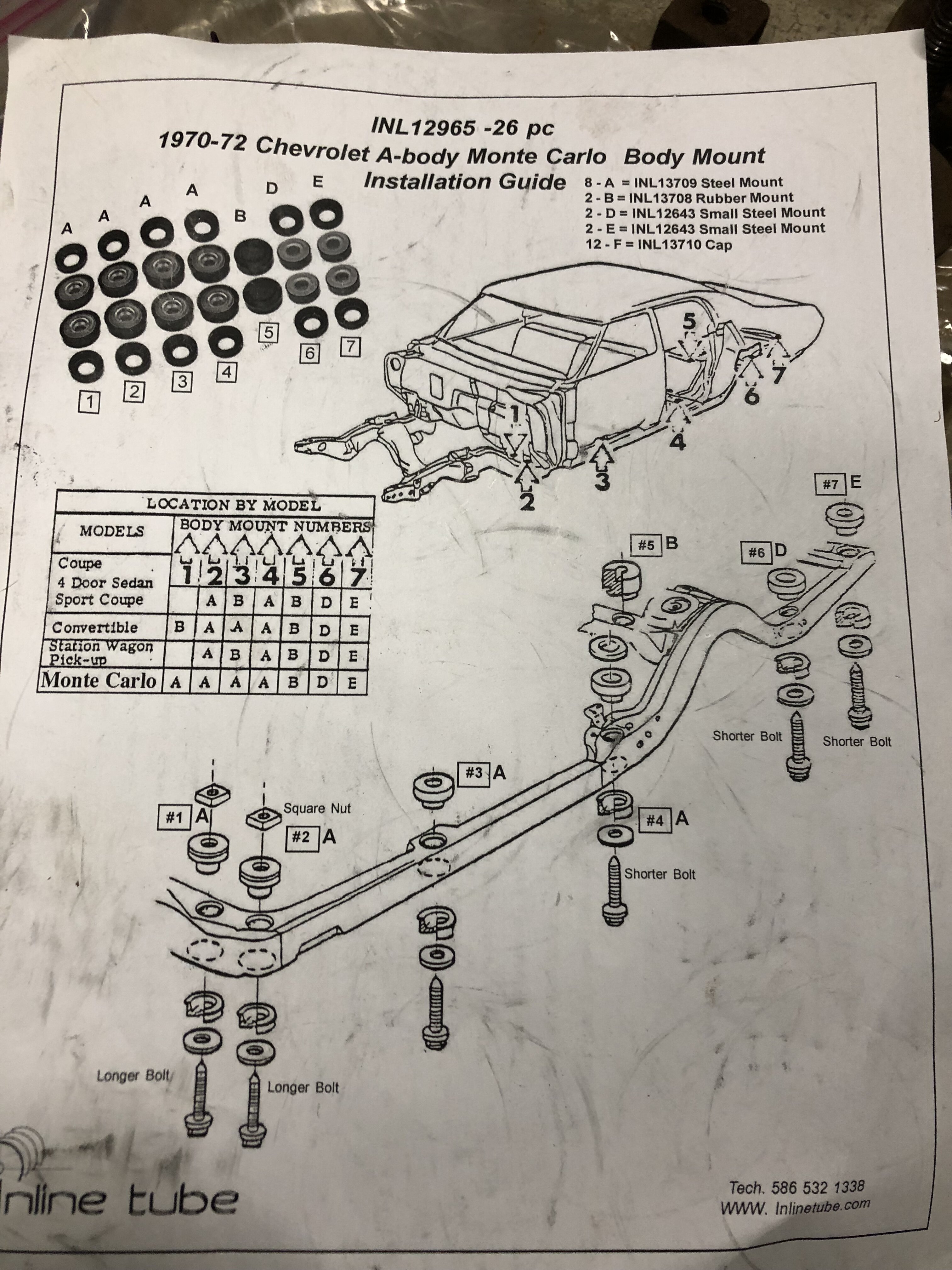

TommySS454 Posted December 12, 2020 Posted December 12, 2020 Hey guys, it's been awhile. I'm going to set the body onto the frame soon and I can't remember where the different body mounts go. All the diagrams I've found aren't very clear. Anybody remember? Thanks Quote
Dtret Posted December 12, 2020 Posted December 12, 2020 I got it somewhere in my mountain of parts. I’ll find it and post Quote
TommySS454 Posted December 12, 2020 Author Posted December 12, 2020 No these are from OPG. I bought these for a previous 70 Monte I had about 200 years ago. Been so long the box disintegrated. But they have always been inside so I'm using them. The originals were almost non existent. Quote

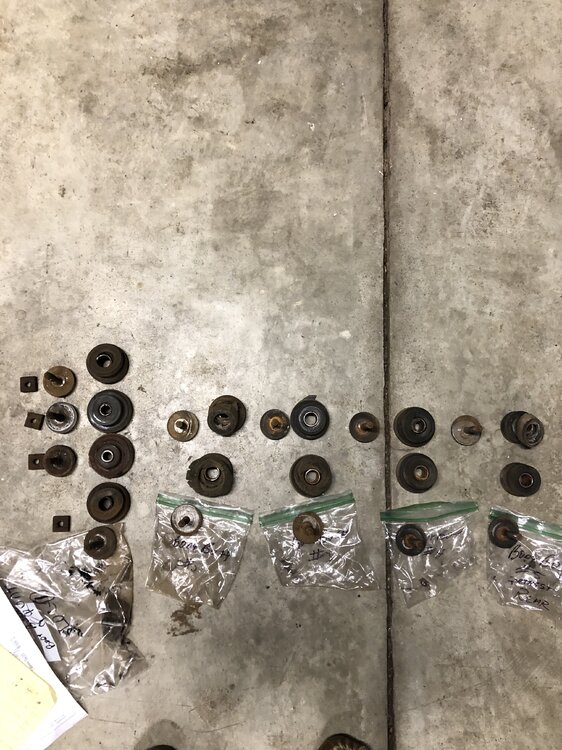

Dtret Posted December 13, 2020 Posted December 13, 2020 This probably won’t help but my original mounts front to back left to right Quote
Dtret Posted December 13, 2020 Posted December 13, 2020 I forgot to ask. But you do have the other half to all the mounts? They are all the same part Quote
TommySS454 Posted December 20, 2020 Author Posted December 20, 2020 Yes I have the other halves. Just didn't include them in the picture. Thanks for the help the other night. Quote
