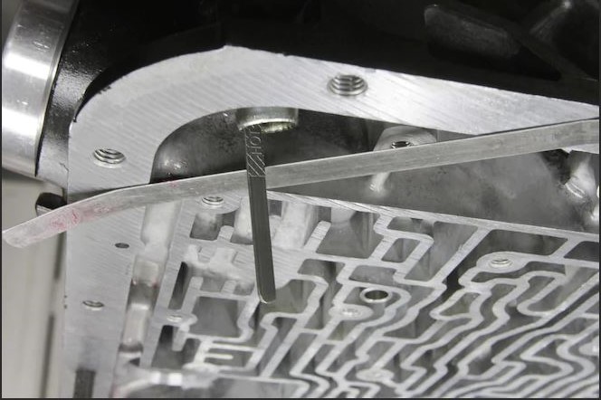

Paul Bell Posted January 9, 2021 Posted January 9, 2021 After you get the unit back, before you install it, install the dipstick tube and drop the pan. The dipstick "full" mark is exactly at the pan rail. Make sure your stick markings match it. Quote
