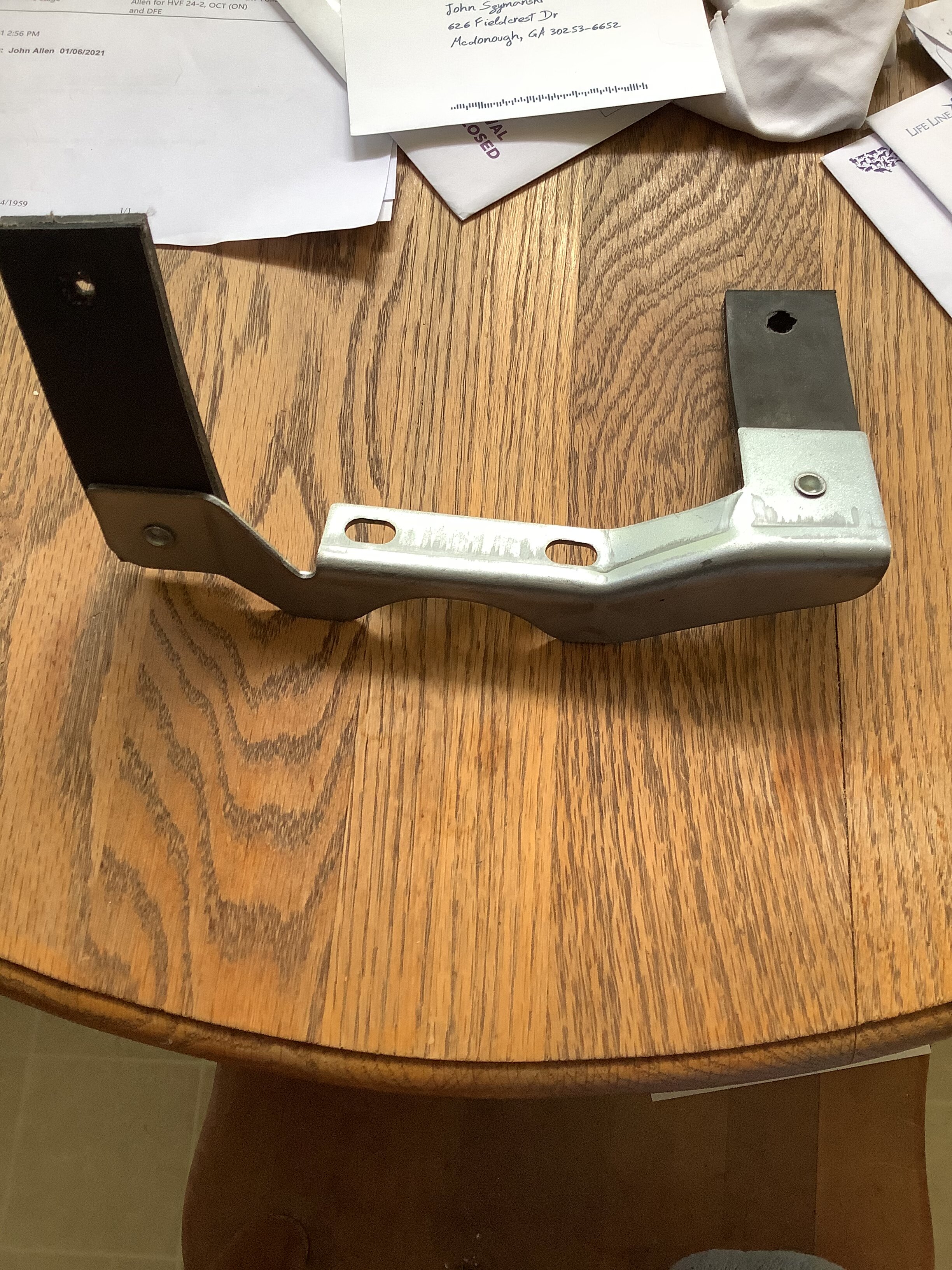

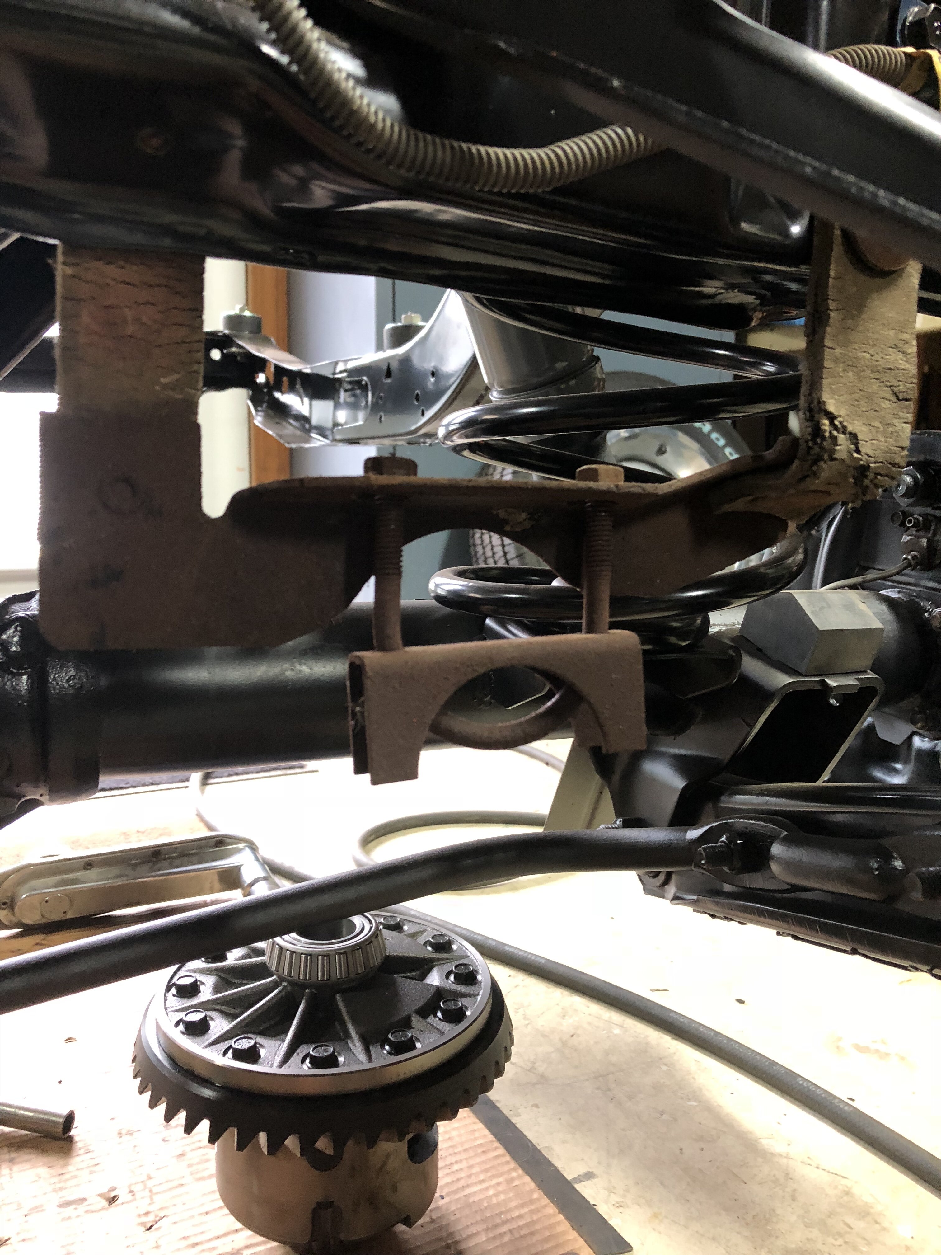

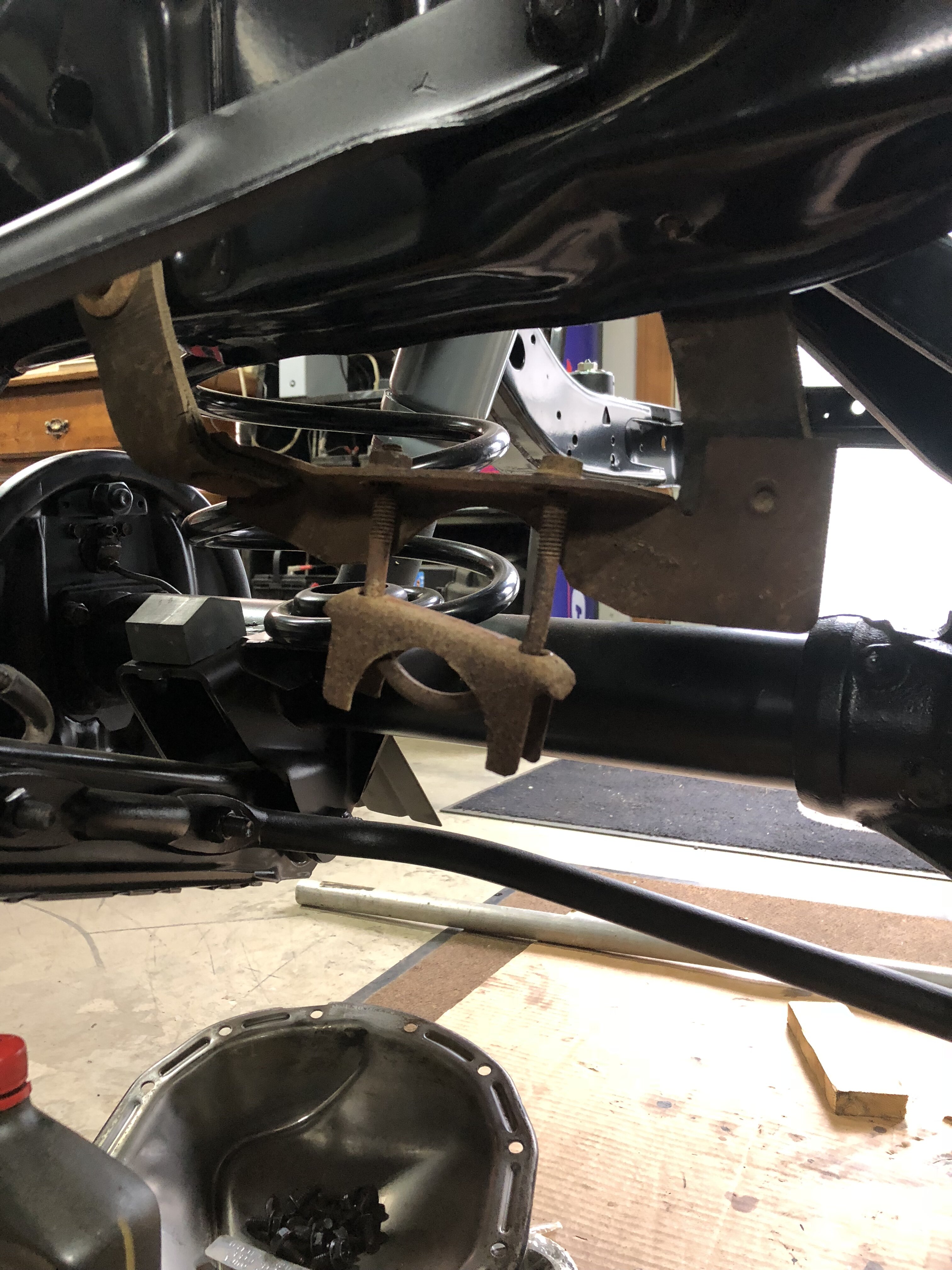

Dtret Posted January 16, 2021 Posted January 16, 2021 You guys are lucky I got this car all apart. Lol. Here you go. 71SS original hangers. First one is passenger side. Second is, well you guessed it, drivers. If you need more let me know Devil went down to Georgia is on the radio talk about soul stealing this car is doing it haha 😂 Quote

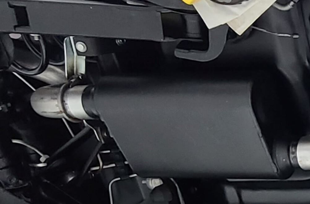

jft69z Posted January 16, 2021 Posted January 16, 2021 That's pretty much how mine are too. I found a pic in my camera roll that shows it, but I enlarged it a bit and cropped it. This is the passenger side. Driver's would be a mirror image. The outboard ones require you to fold the rubber strap at almost a 90 degree bend and attach from the front side, while the inboard ones sort of hang down straight-ish and attach from the rear on the crossmember.. The one you have pictured on your table is the right (passenger) side hanger. If your other hanger is EXACTLY the same, you got boned like I did. Quote
John S Posted January 16, 2021 Author Posted January 16, 2021 1 hour ago, jft69z said: That's pretty much how mine are too. I found a pic in my camera roll that shows it, but I enlarged it a bit and cropped it. This is the passenger side. Driver's would be a mirror image. The outboard ones require you to fold the rubber strap at almost a 90 degree bend and attach from the front side, while the inboard ones sort of hang down straight-ish and attach from the rear on the crossmember.. The one you have pictured on your table is the right (passenger) side hanger. If your other hanger is EXACTLY the same, you got boned like I did. I’ll take it back. I’ll give them that other number and see if that’s in their system. There is a summit store only 2 miles from my house the only problem is dealing with these people is they are not parts experts they’re very good with computers but not very knowledgeable on parts. In-line tube does have right and left specific that come in a set if I can’t get anywhere with summit I will go that route again thank you very much for the pictures I do appreciate it Quote

jft69z Posted January 16, 2021 Posted January 16, 2021 What part number hangers do you currently have, and are the ones you have in your possession the exact same physical part? Quote
John S Posted January 16, 2021 Author Posted January 16, 2021 Just now, jft69z said: What part number hangers do you currently have, and are the ones you have in your possession the exact same physical part? I have Two 35870 and they are identical. Summit has a 35871 but for some reason it is 6$ cheaper and not in stock and has to be special ordered. I'll probably go with inline tube. They sell the L & R as a pair and they do look different. John s Quote
