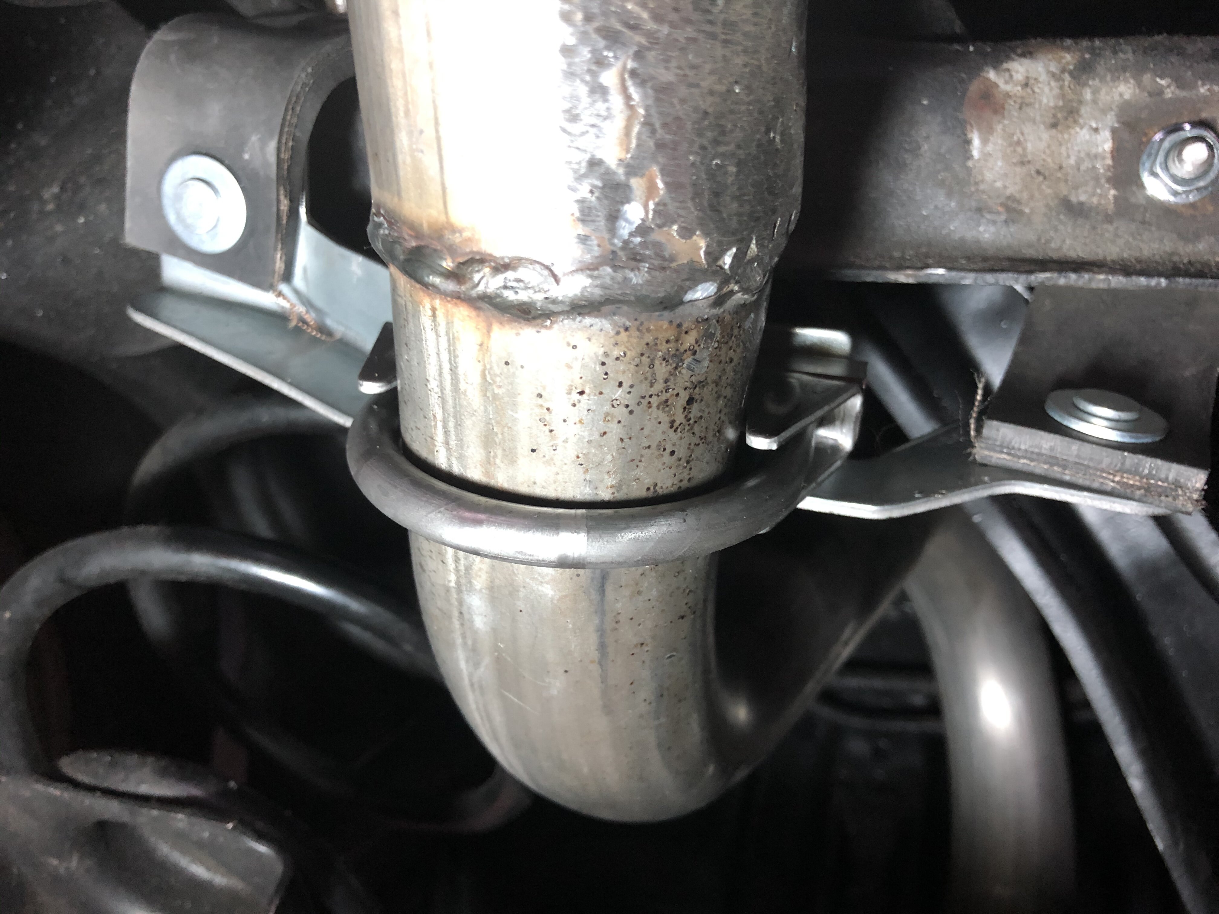

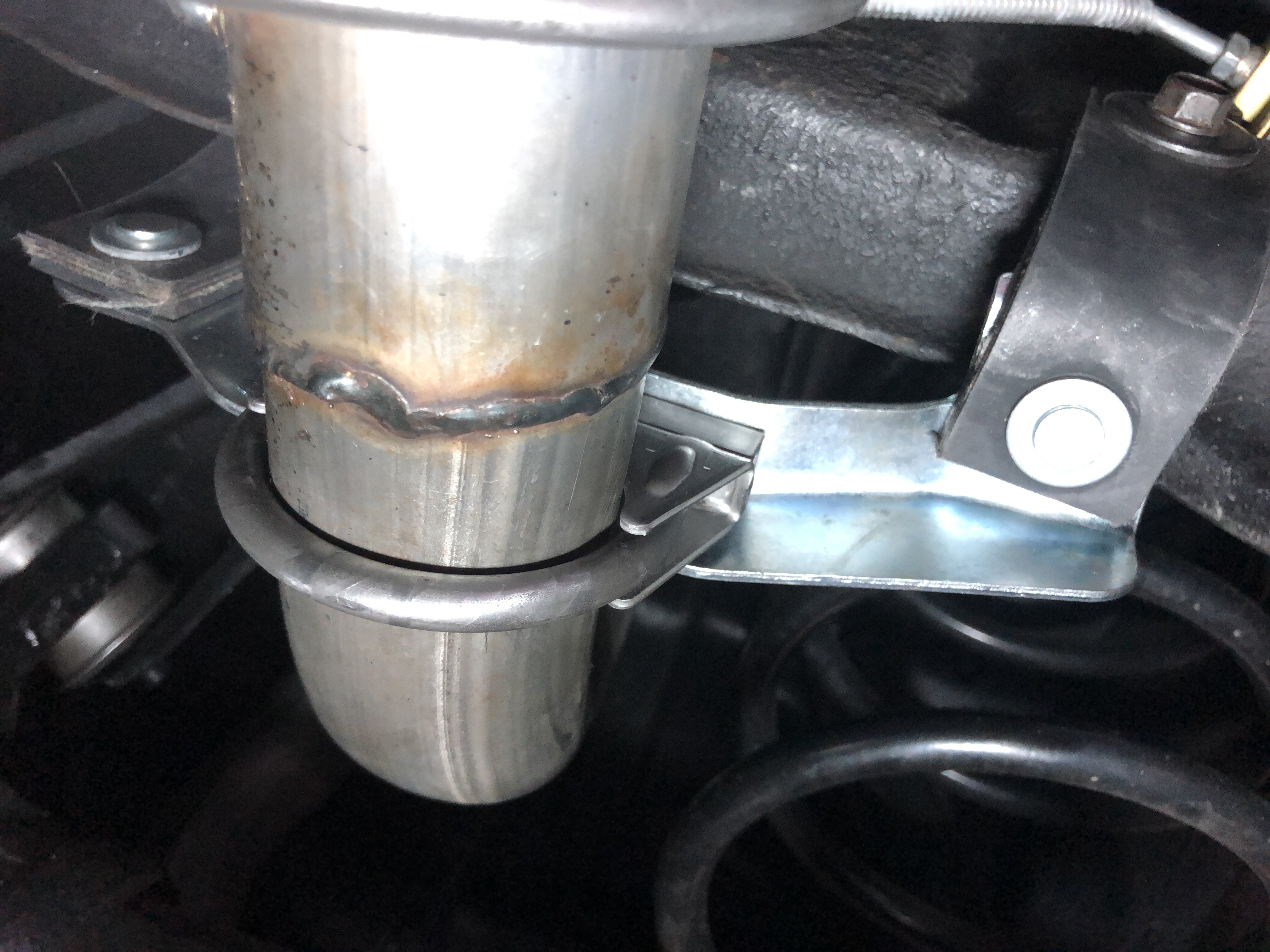

John S Posted January 20, 2021 Author Posted January 20, 2021 On 1/16/2021 at 4:07 PM, jft69z said: Great, let us know how it works when you get it! It worked great got the right part number and it worked there is a difference. First picture is the left second is the right side. Thanks for the help. John S 1 Quote
jft69z Posted January 20, 2021 Posted January 20, 2021 That's good news, glad it worked out for you! Thanks for updating us too. Quote
MC1of80 Posted January 20, 2021 Posted January 20, 2021 Glad you got the correct one and it worked out great for you!! Looks good! Quote
cny first gen 71 Posted January 20, 2021 Posted January 20, 2021 Looks good, what size pipe/clamp do you have there? Did you have to elongate the holes at all? Quote
jft69z Posted January 20, 2021 Posted January 20, 2021 1 hour ago, cny first gen 71 said: Looks good, what size pipe/clamp do you have there? Did you have to elongate the holes at all? Not sure about John's system, but in my case with 2 1/2" pipes, I did have to elongate the bracket holes a little with a round file. Took about 5 minutes. (if that was what you were wondering in regards to 2 1/2"). 1 Quote
John S Posted January 20, 2021 Author Posted January 20, 2021 1 hour ago, cny first gen 71 said: Looks good, what size pipe/clamp do you have there? Did you have to elongate the holes at all? I have a 2 1/4 inch clamp there and I did have to elongate the holes a little bit no big deal just use the round file. 1 Quote
