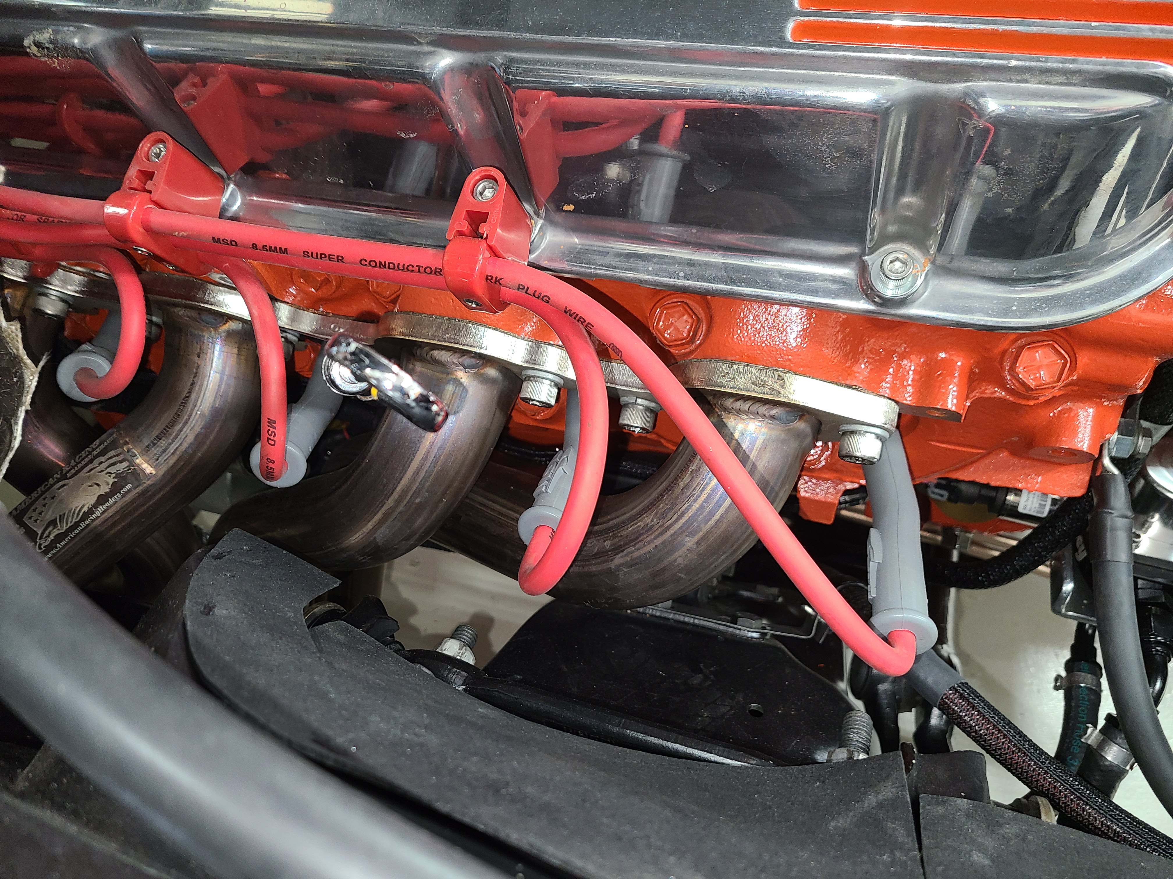

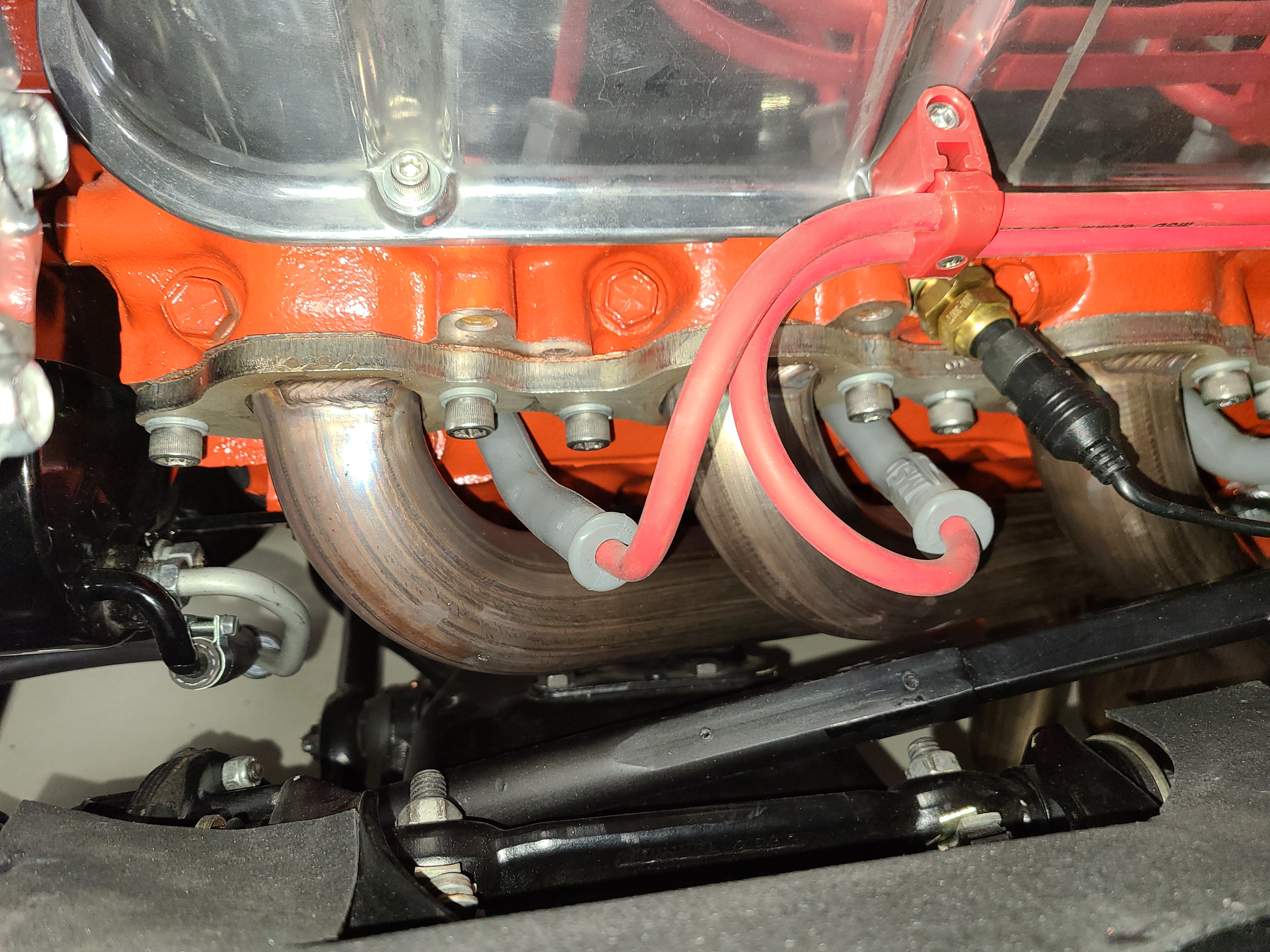

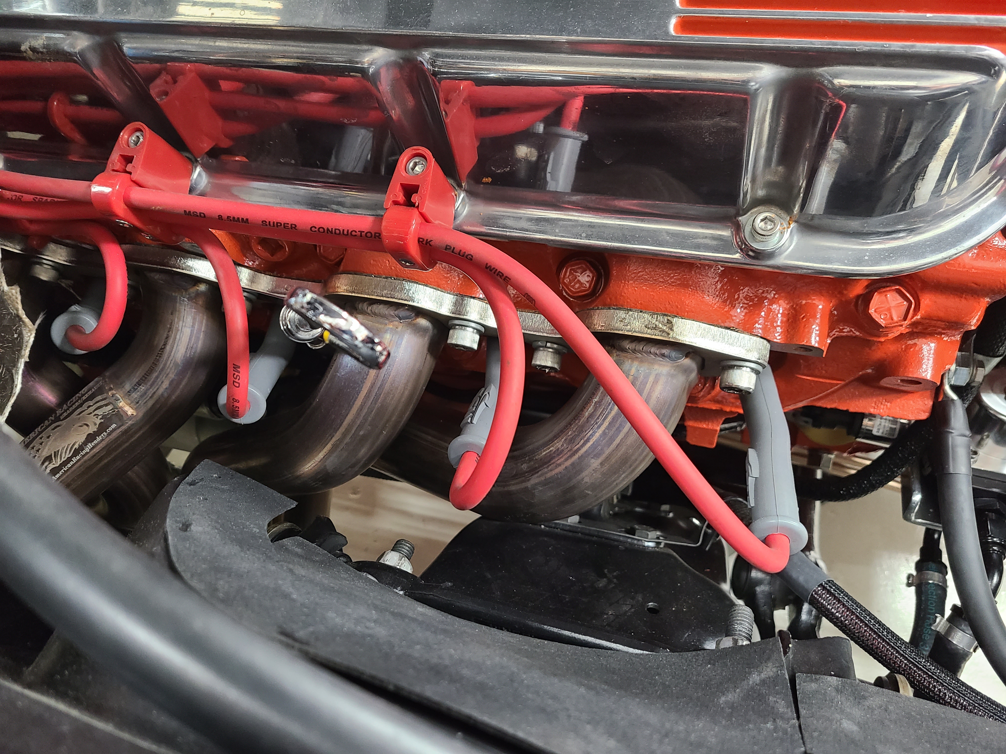

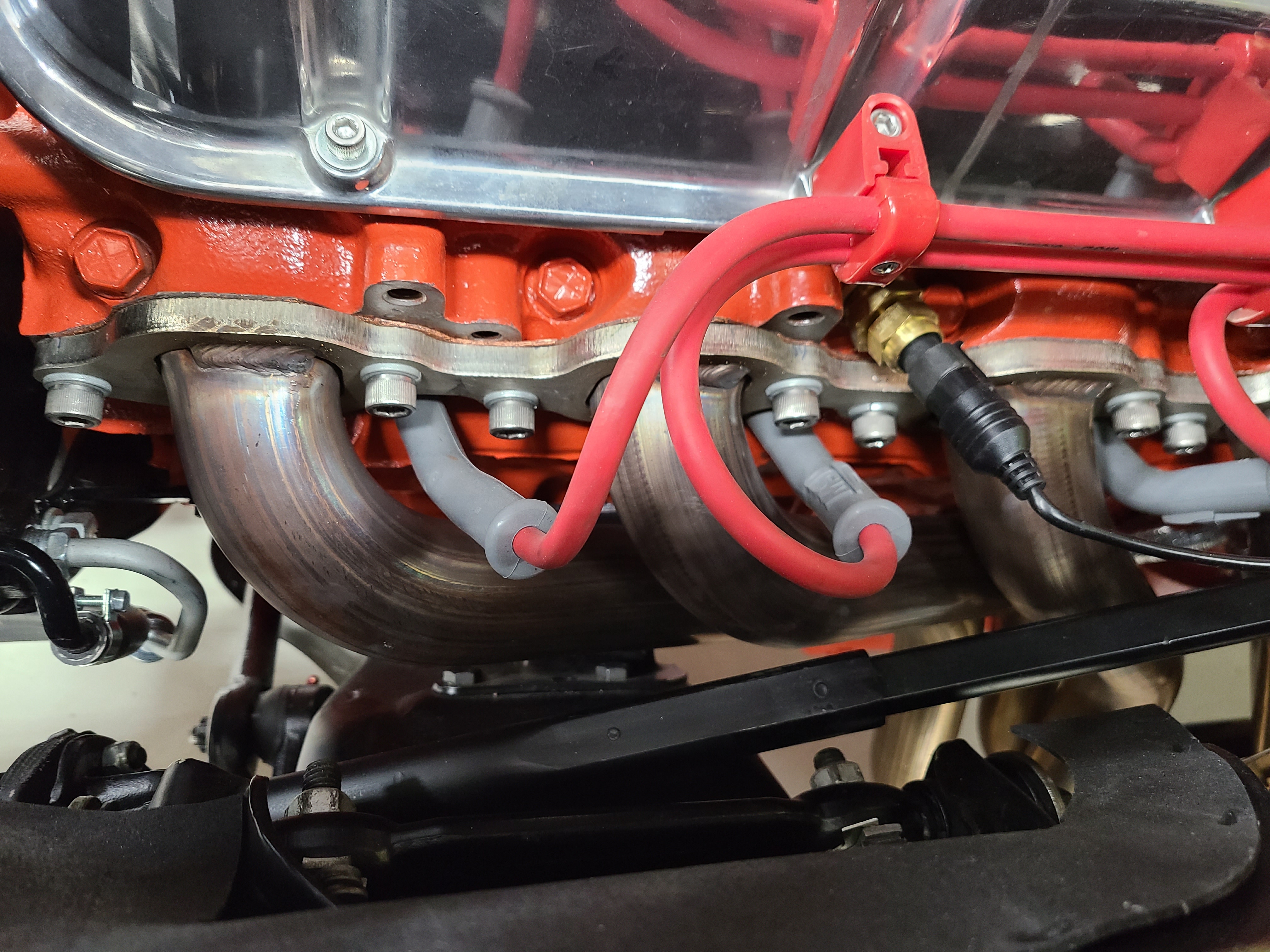

jft69z Posted March 19, 2021 Posted March 19, 2021 Here's a couple of pics, with and without flash. They did darken up a bit, but nothing terrible or ugly. 2 Quote
Tim972 Posted March 20, 2021 Author Posted March 20, 2021 Thanks for the pics, those look great 👍 Quote
jft69z Posted March 20, 2021 Posted March 20, 2021 37 minutes ago, Tim972 said: Thanks for the pics, those look great 👍 You're welcome. If you need more from underneath, let me know. That other thread had some good pics of how high they tuck up though. I'm real happy with the fit, plus no leaks. I used the Hooker gaskets with ultra copper spray-a-gasket. FelPro gaskets just didn't seem to fit the exhaust ports as well as these ones, at least for this particular head (GM rectangle port intakes). Quote
