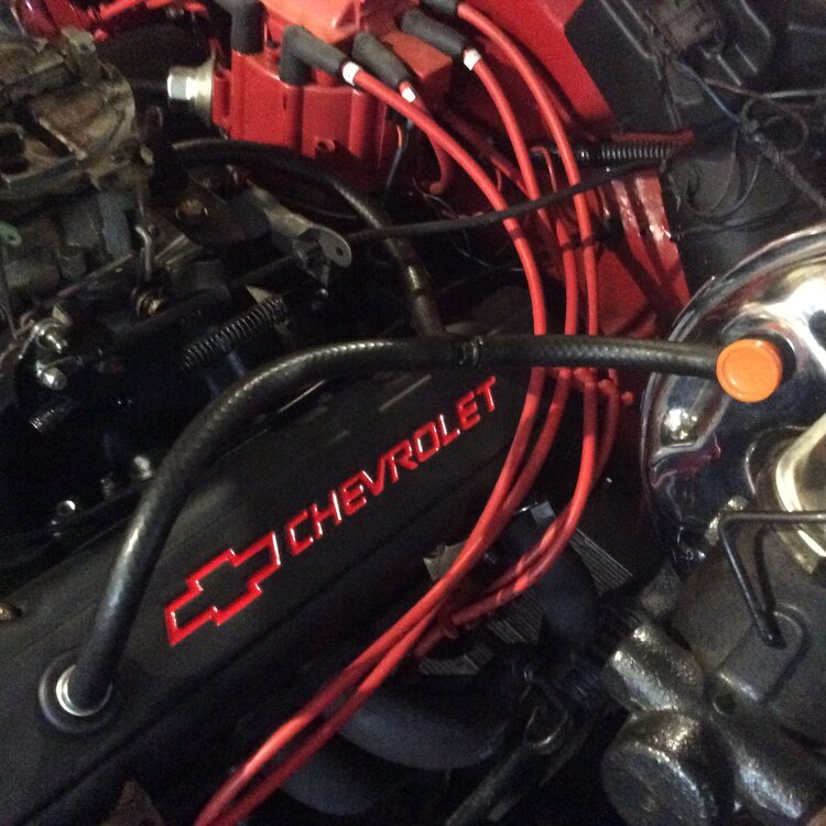

70chev Posted April 11, 2021 Author Posted April 11, 2021 13 hours ago, Blackhawk said: Is the booster itself leaking or is the check valve shot? Well, it is not holding vacuum, also has brake fluid running down it from the back of the master cylinder. My dad looked at it and said the vacuum line is not hooked up right either, which may have destroyed the booster. I have a line running off the back of the carb going to a "T" from the "T", one line goes to the booster, the other line goes to the PCV valve. So yea I have a mess 🤣😬 Quote
cny first gen 71 Posted April 11, 2021 Posted April 11, 2021 Sounds like you have a couple things going on there, first if theres fluid running down booster its probably leaking from back of master cylinder. Replace with a NEW one not rebuilt. Check the check valve it is a one way valve and check the vacuum lines too for leaks. The way to check the booster is with the car not running pump up the brakes a few times the pedal should get hard,this depletes the vacuum in booster. then with your foot still on pedal start the car the pedal should fade down some if it does then the booster is probably ok. I have seen a few boosters go bad over the years and check valves too and of course vacuum lines. Quote
70chev Posted April 11, 2021 Author Posted April 11, 2021 Is this a bad setup for the brake booster? Quote
Dtret Posted April 11, 2021 Posted April 11, 2021 Yes both should have individual vacuum source Quote
cny first gen 71 Posted April 11, 2021 Posted April 11, 2021 Can't get to my car right now but I believe it should direct manifold vacuum to the booster. PCV goes to back of carb. Quote
Dtret Posted April 12, 2021 Posted April 12, 2021 2 hours ago, cny first gen 71 said: Can't get to my car right now but I believe it should direct manifold vacuum to the booster. PCV goes to back of carb. I was going to say that but I wasn’t 100 percent sure so I skirted around it but I know what he has isn’t correct Quote
Dtret Posted April 12, 2021 Posted April 12, 2021 The port hole for the booster is in front of the distributor (plugged?) but with the HEI it may be partially blocked. You’ll have to use a 90 degree port Quote
