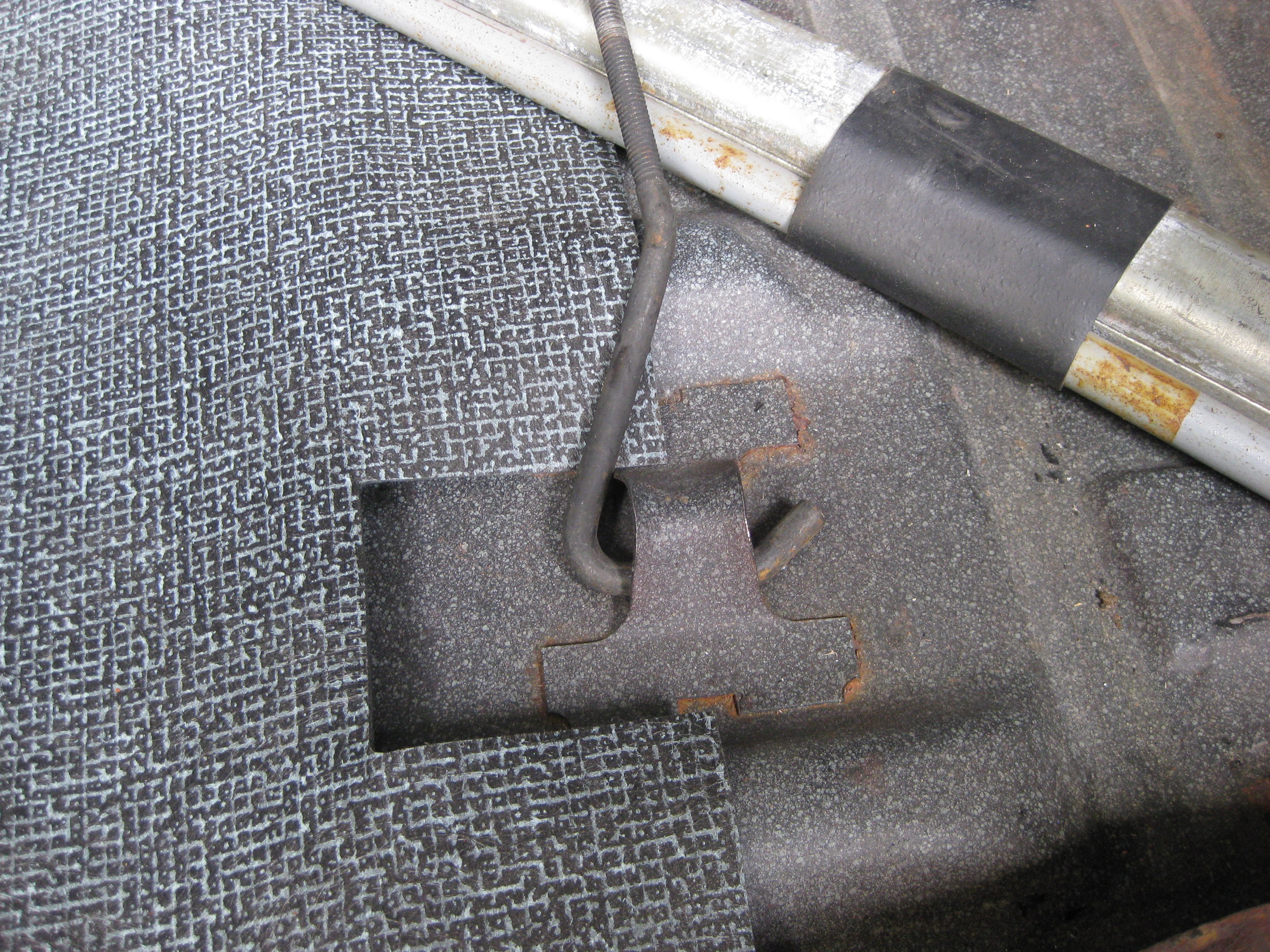

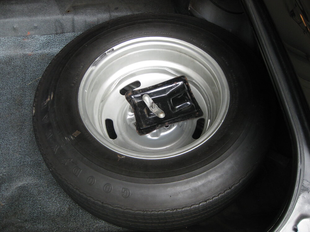

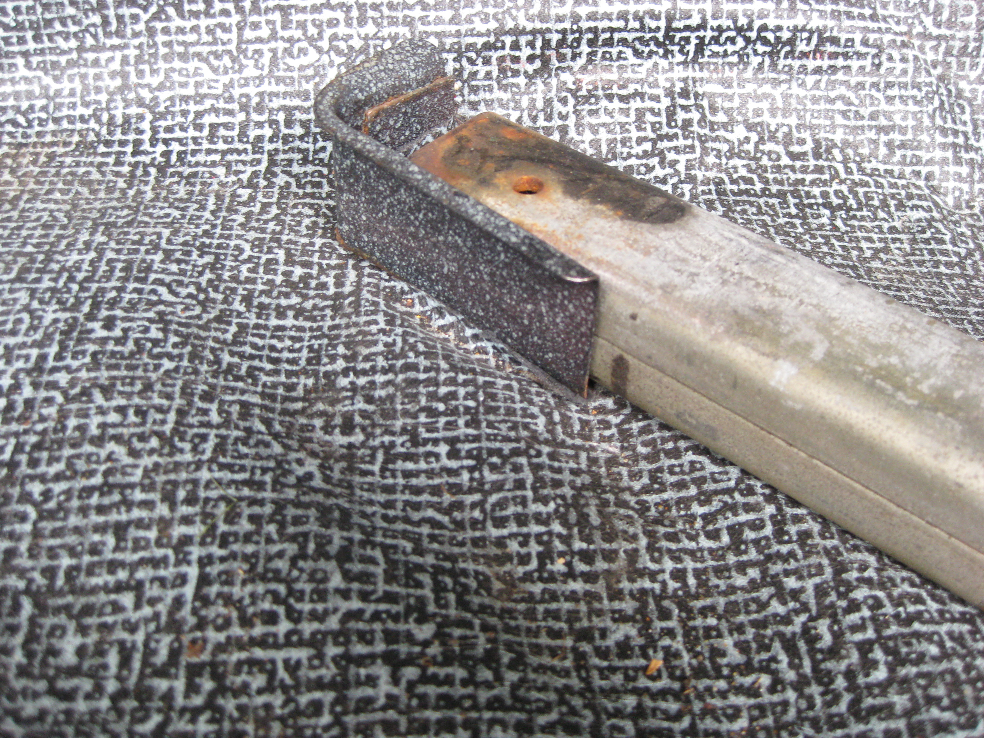

Hey Wayne, I am not sure if all 3 years are the same, hopefully someone else will chime in that knows for sure. But what i have on my 72 is, tire iron is attached to jack with 2 rubber sleeves. all 3 pieces (jack, hook, tire iron) are put down first in the small metal tab. Then the tire goes on top of that upside down (you might have to move the hook, and rachet part alittle to fit better. Then i put the hold down bolt through the tire, then place the base over that (also upside down). Then the wing nut, and done.
Hope that is right because that is what i have done.

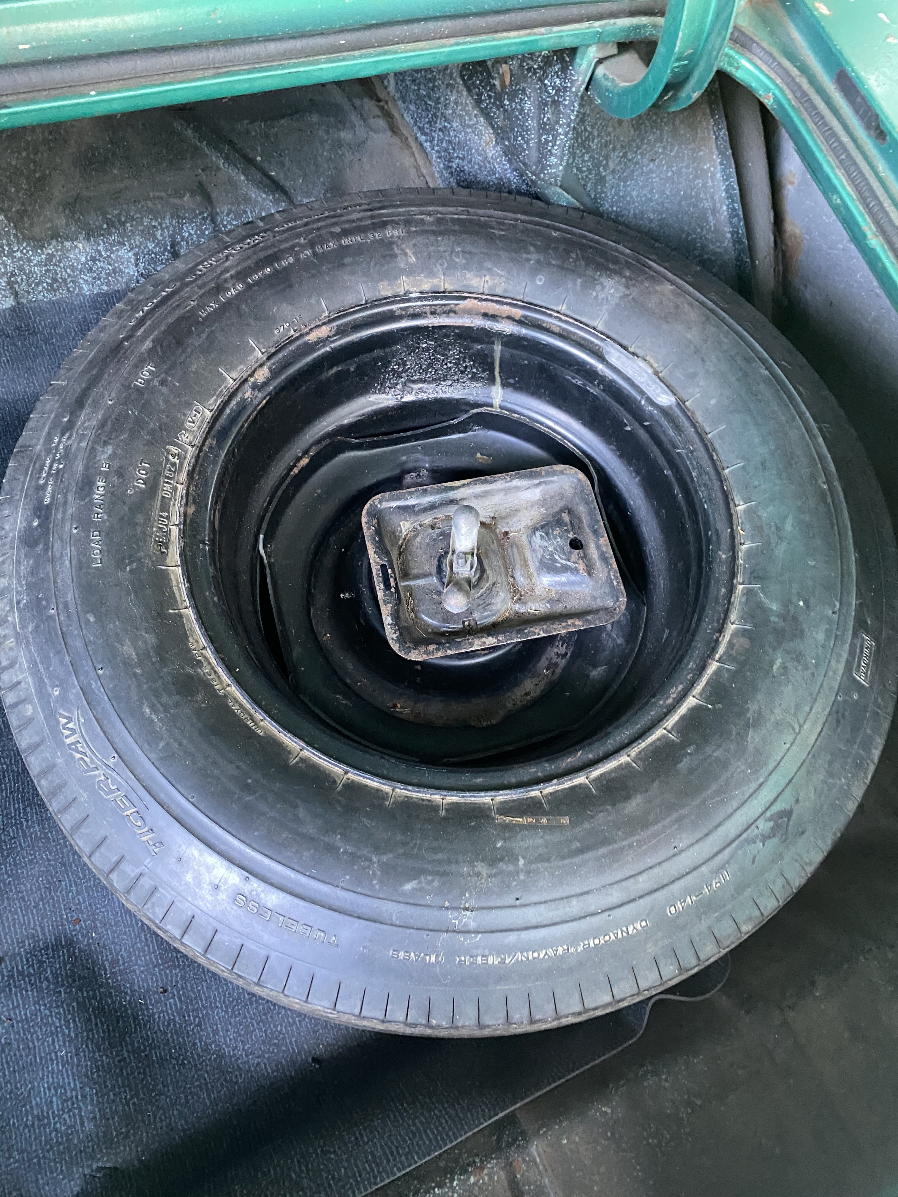

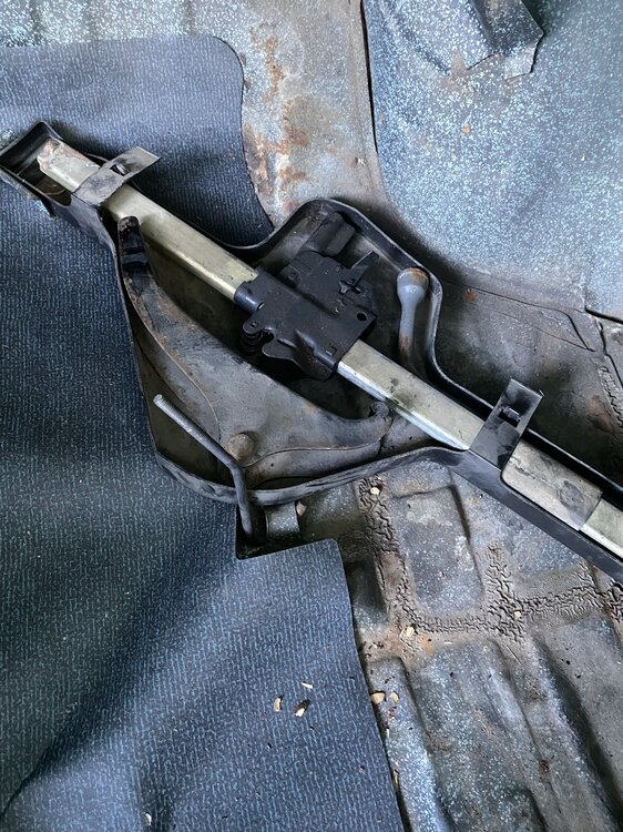

72 should have the plastic guitar case. The directions are in the case. I’ll get a picture of my 72 in a bit.
