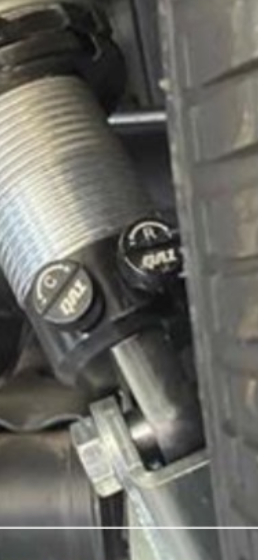

The prior owner of my SS had his mechanic install QA1 coil overs at all four corners. I have the receipt which also lists two hours labor to dial it in “correctly”.
She sits real pretty with no rubbing issues (on stock 15” rally wheels). These coil overs are their more expensive model as they allow multiple adjustments for compression AND rebound (21 increments each control rings a bell). I plan on playing with these settings when I start my vacation, but I don’t plan on adjusting the height at all; my only complaint is that she seems to ride just a tad too stiff.  I’ll see what happy medium I can find without going too soft / causing contact with the bump stop.

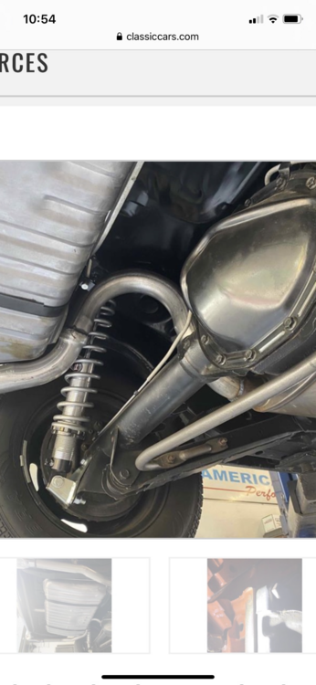

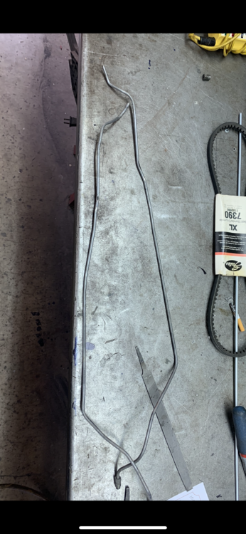

This said, I just discovered that the springs were rubbing through my rear brake lines on compression. The mechanic who installed them obviously didn’t notice this potential based on how much clearance there appeared to be when it was on the rack when he installed them… but it is obviously a whole different story when the car is on the ground under load. Visit QA1.net for some pretty detailed info on coil overs vs. traditional suspensions.
I shared the brake line pix in another thread the other day. The other pix show how deceiving clearances can be. Hope this helps your decision.

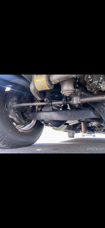

Forgot to add pix of the fronts. I don’t have any pictures with the front tires off, but when I do the brakes I will take some pictures so you get a better idea of how they fit.
