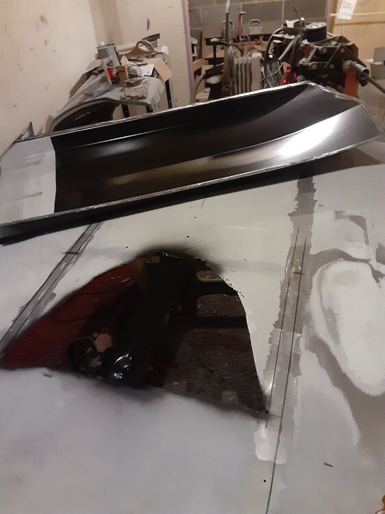

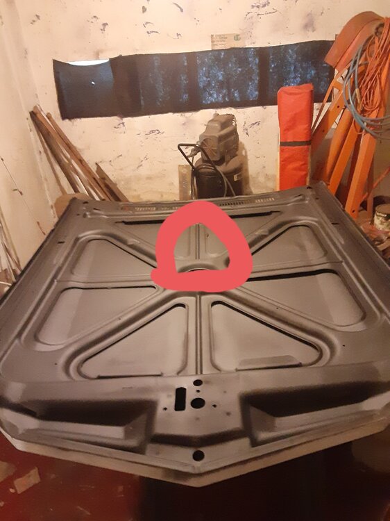

cny first gen 71 Posted November 20, 2021 Author Posted November 20, 2021 Made some progress today think it's pretty much mocked up, did some cutting and grinding seems to be good so far. Have a little more prep work to do on hood but I don't think I'm going to cut the hood to make it semi functional (that scares me) but it's almost ready to bond and screw on after the primer dries on the bottom side. I figured I better scuff it and prime it because I'm not going to be able to get paint all the way to the front. 3 Quote
MC1of80 Posted November 20, 2021 Posted November 20, 2021 Cut it!!! Make it functional! Use a cut off wheel and only remove the outer skin and leave the inner structure. You can do it!!!! 1 Quote
Dtret Posted November 21, 2021 Posted November 21, 2021 I agree. If you’re going to have it, make it functional Quote
Leghome Posted November 21, 2021 Posted November 21, 2021 JUst don't get the metal hot it will warp. Voice of experience speaking 1 Quote
cny first gen 71 Posted November 21, 2021 Author Posted November 21, 2021 Yea I guess you guys are right, I'll do the cutting. I think I can cut the small brace in the back and not really loose any strength in the structure then cut the skin. Quote
Dtret Posted November 21, 2021 Posted November 21, 2021 I don’t think I would cut any braces. It can still be functional with the brace but won’t look as pretty from the underside Quote

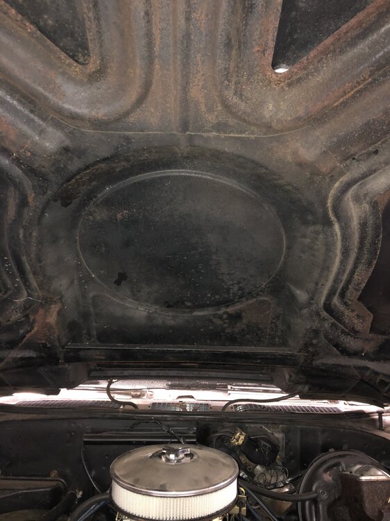

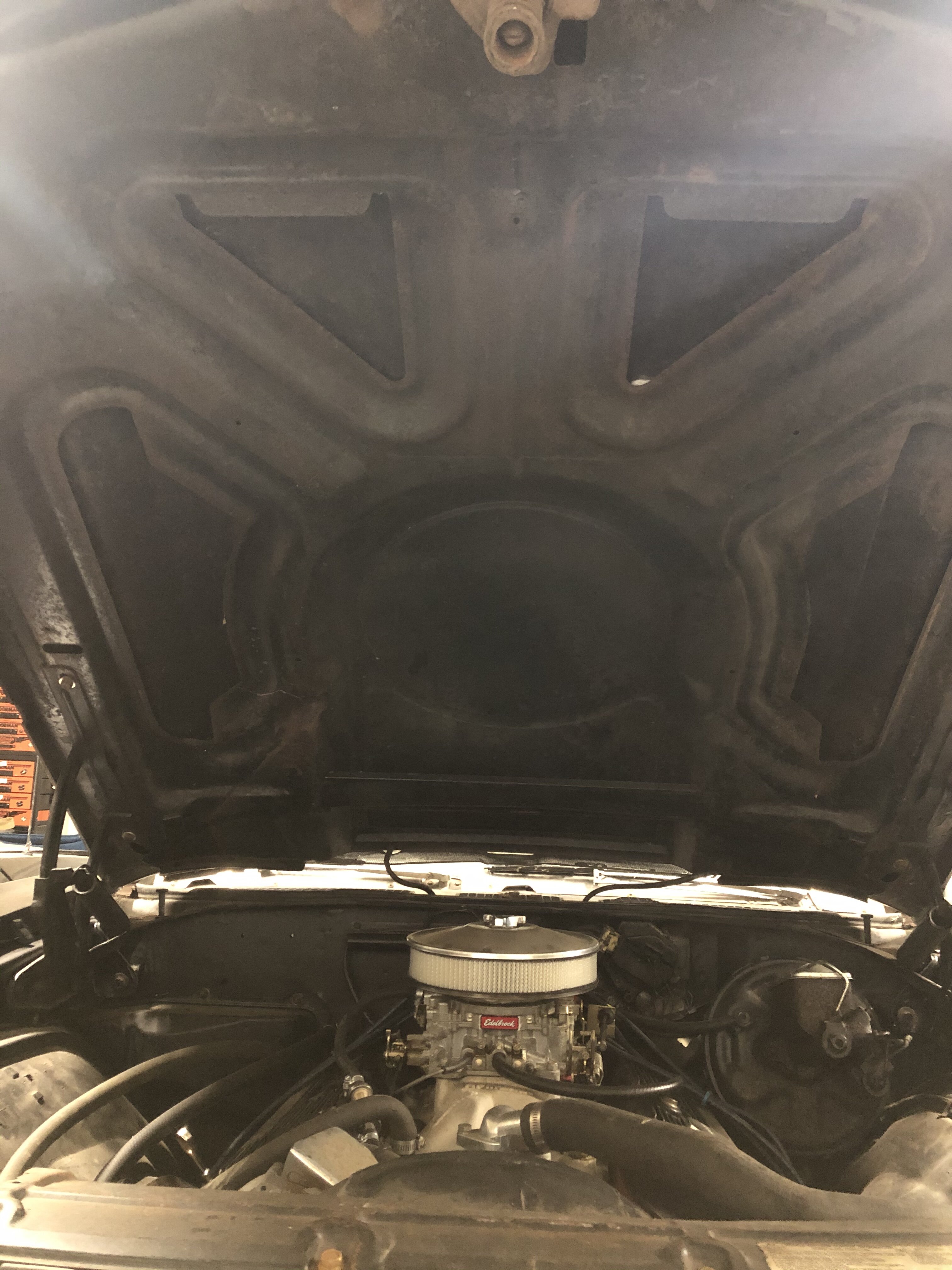

jft69z Posted November 21, 2021 Posted November 21, 2021 I probably wouldn't cut the braces either, that's a lonngggg hood. There's usually some type of adhesive under those ribs. That'll help stop the outer skin from 'oil canning'. Dennis, do you have a picture of the underside of the Chevelle cowl hood handy? Quote
cny first gen 71 Posted November 21, 2021 Author Posted November 21, 2021 55 minutes ago, jft69z said: I probably wouldn't cut the braces either, that's a lonngggg hood. There's usually some type of adhesive under those ribs. That'll help stop the outer skin from 'oil canning'. Dennis, do you have a picture of the underside of the Chevelle cowl hood handy? Yes Joe I'm going to use silicone between the skin and braces. I saw another car with that brace cut out and the guy said he never had a problem, that was a first gen camaro and it's just the short one to the rear, it dosen't seem to me like that would cause a problem, but I've been wrong before 😅 and probably will be again! Quote
cny first gen 71 Posted November 21, 2021 Author Posted November 21, 2021 Just this little one not the center or any of the others Quote
jft69z Posted November 21, 2021 Posted November 21, 2021 6 minutes ago, cny first gen 71 said: Yes Joe I'm going to use silicone between the skin and braces. I saw another car with that brace cut out and the guy said he never had a problem, that was a first gen camaro and it's just the short one to the rear, it dosen't seem to me like that would cause a problem, but I've been wrong before 😅 and probably will be again! The new cowl may stiffen it up a little too. They make structural adhesives that may work better than silicone, may want to look into that instead. Otherwise, looks good! 1 Quote
Dtret Posted November 21, 2021 Posted November 21, 2021 2 hours ago, jft69z said: I probably wouldn't cut the braces either, that's a lonngggg hood. There's usually some type of adhesive under those ribs. That'll help stop the outer skin from 'oil canning'. Dennis, do you have a picture of the underside of the Chevelle cowl hood handy? I didn’t but I do now. Lol. It’s a different design though. Quote
jft69z Posted November 21, 2021 Posted November 21, 2021 Thanks D. I figured the bracing would be centered around the air cleaner opening, but still provide enough structural support everywhere else. 1 Quote

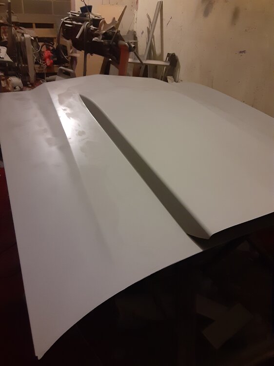

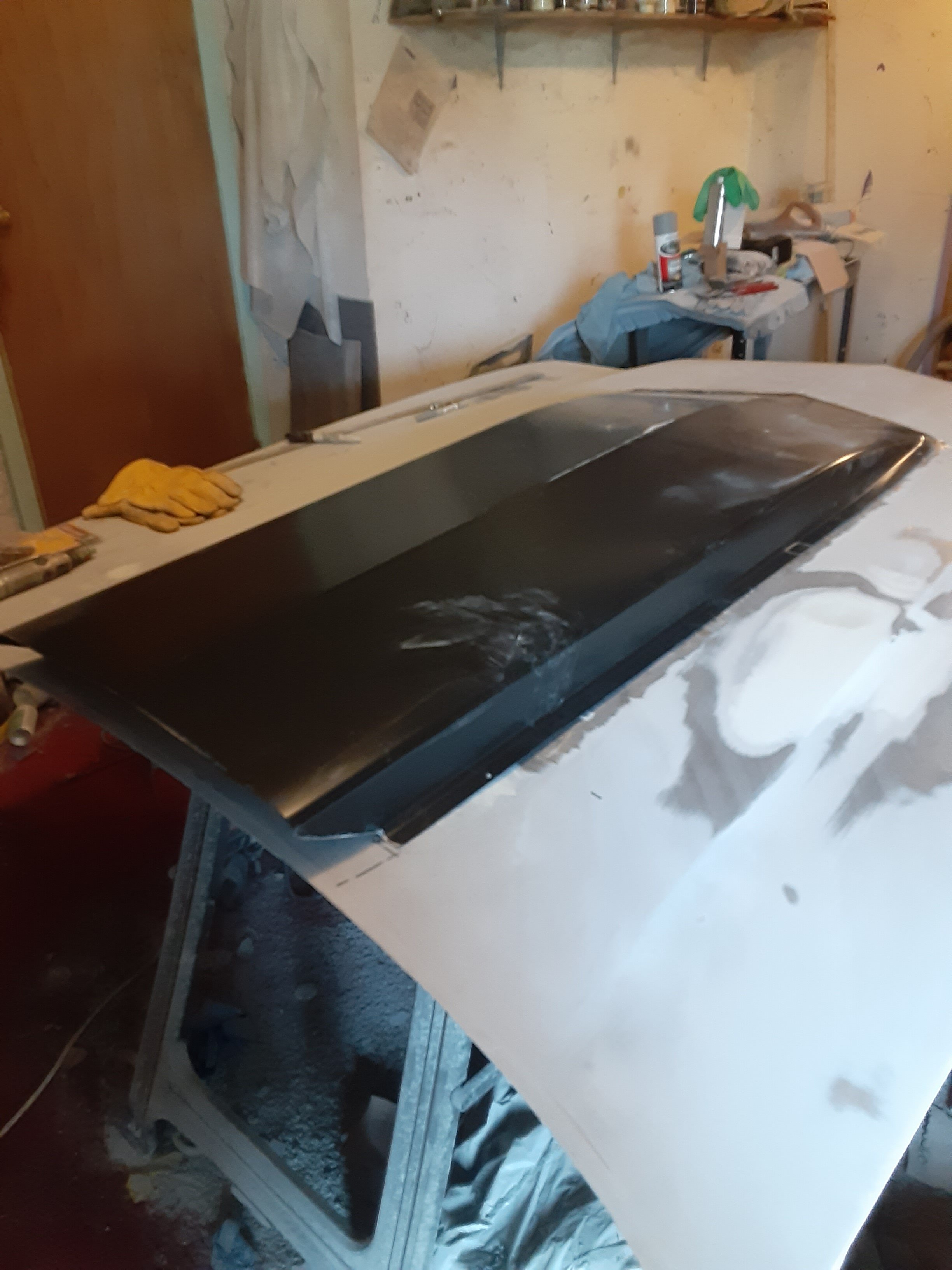

cny first gen 71 Posted November 26, 2021 Author Posted November 26, 2021 Well back at it today, I got the bottom side primed and painted and the hole cut. I didn't cut the bracing, got it completely mocked up now I just have to bond hood to bracing and bond the scoop in place. Of course while I was down. There working I tripped and took a tumble didn't hear any cracks but I'm sure I'll feel it tomorrow. I'm supposed to go to Albany (well actually Saratoga) tomorrow but the way the weather looks I may not. Now time for some pumpkin pie. 3 Quote

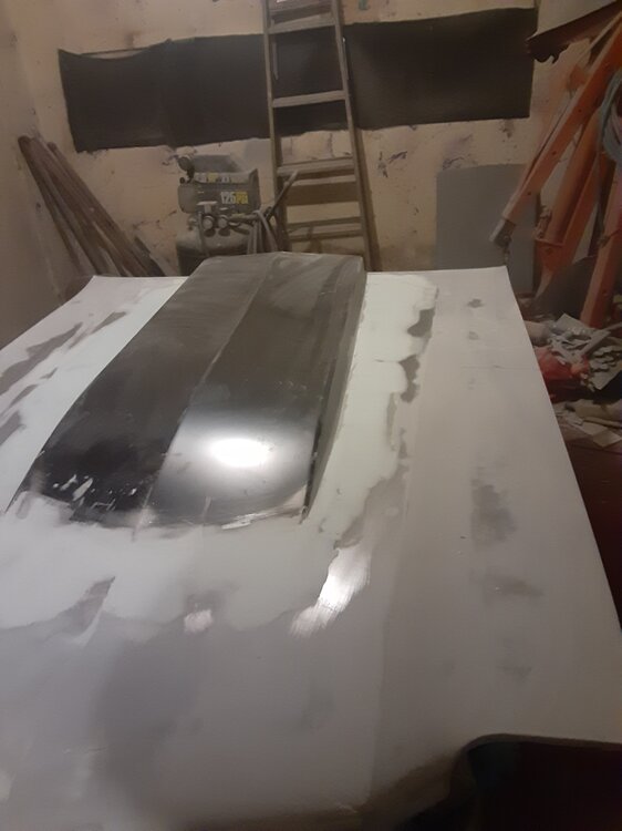

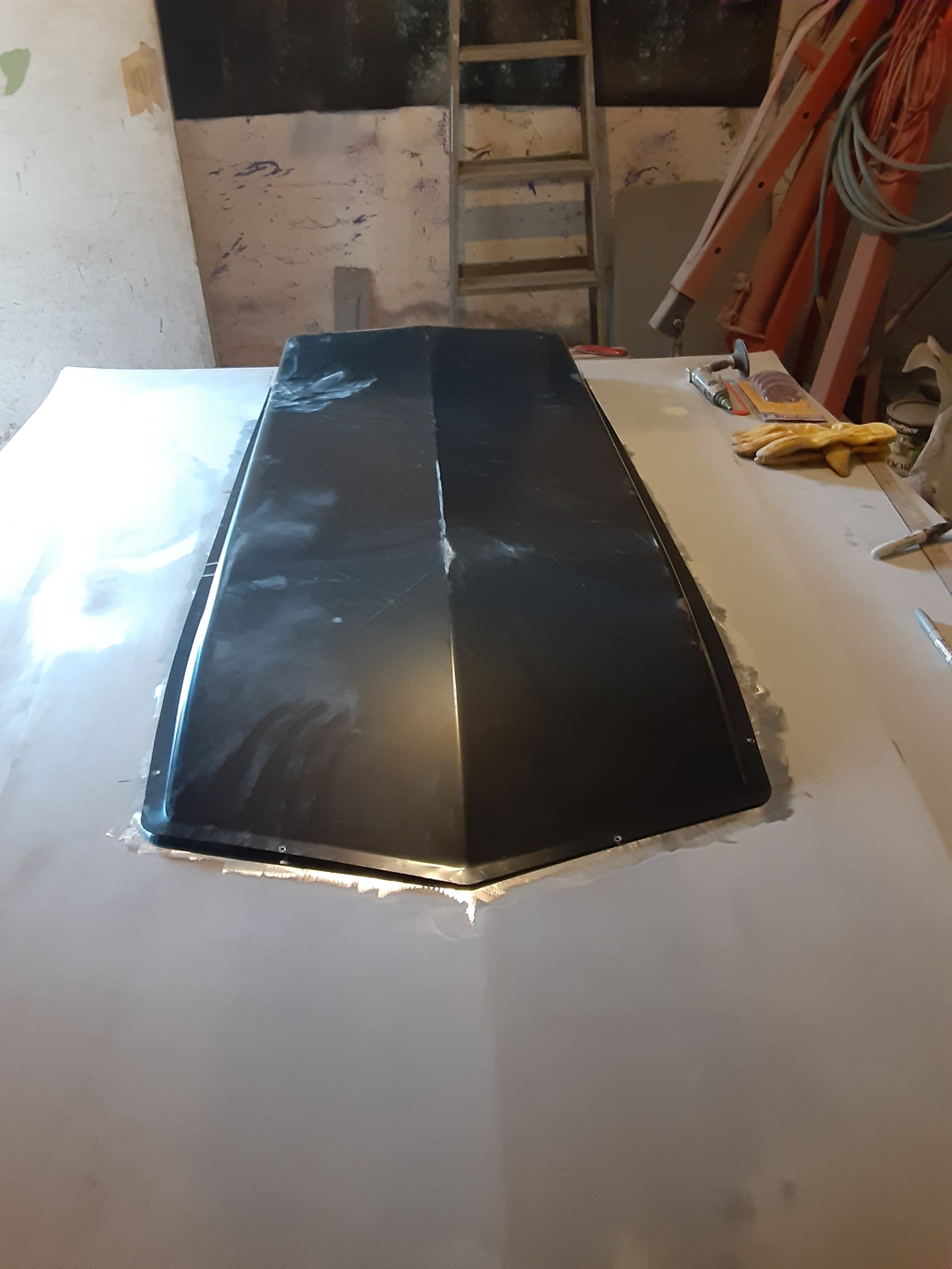

cny first gen 71 Posted December 6, 2021 Author Posted December 6, 2021 Well the hood and the scoop are now one piece, got it all bonded on and let it set for twice the normal time. It don't seem to be going anywhere ( I hope) got a layer of reinforced filler on it but ran out so got to pick up more tomorrow then the body work begins. I hate that part, because I'm not that good at it so it takes me twice as long to do it. 4 Quote
714024SPEED Posted December 7, 2021 Posted December 7, 2021 Looks great. Keep the updated pictures coming. Quote
cny first gen 71 Posted December 8, 2021 Author Posted December 8, 2021 Got a little more done, it's starting to look like it belongs there. Now to just finish up the low spots. Need to get more supplies. 2 Quote

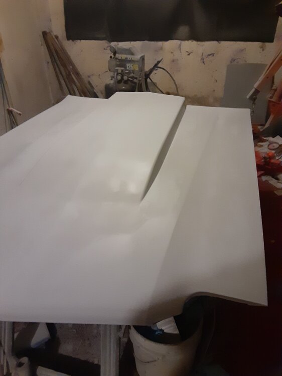

cny first gen 71 Posted February 21, 2022 Author Posted February 21, 2022 Well I finally got down to get some work on the hood done today, got some blocking done and figured I'd get some primer on and see how it looks. It's not to bad but I do have more to do on it. Sure wish I knew body work lol. 3 Quote
