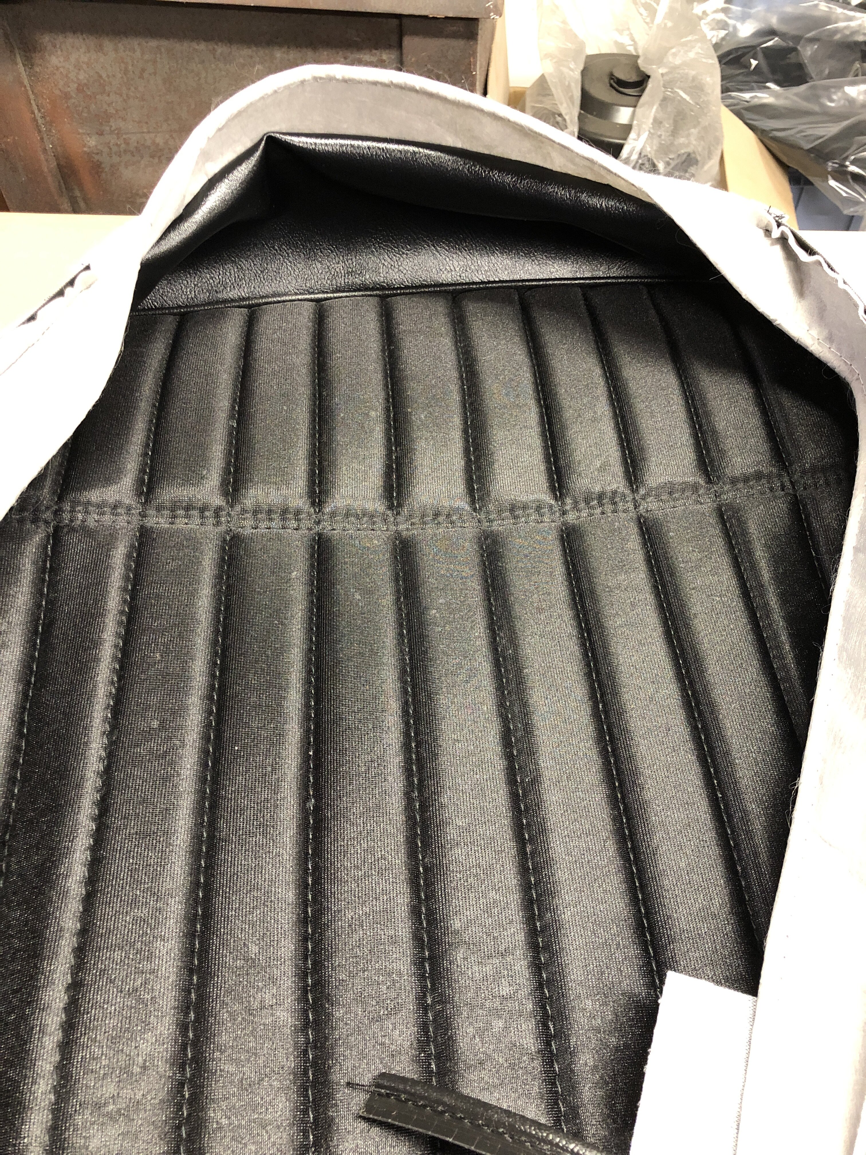

FrankOC Posted July 19, 2021 Posted July 19, 2021 I have new Legendary cloth seat covers. On the uppers there is a horizontal seam and on the back there is a pocket for a listing wire. my question to anyone that has installed new seat covers, does that seam get hog ringed to the springs? 1 Quote

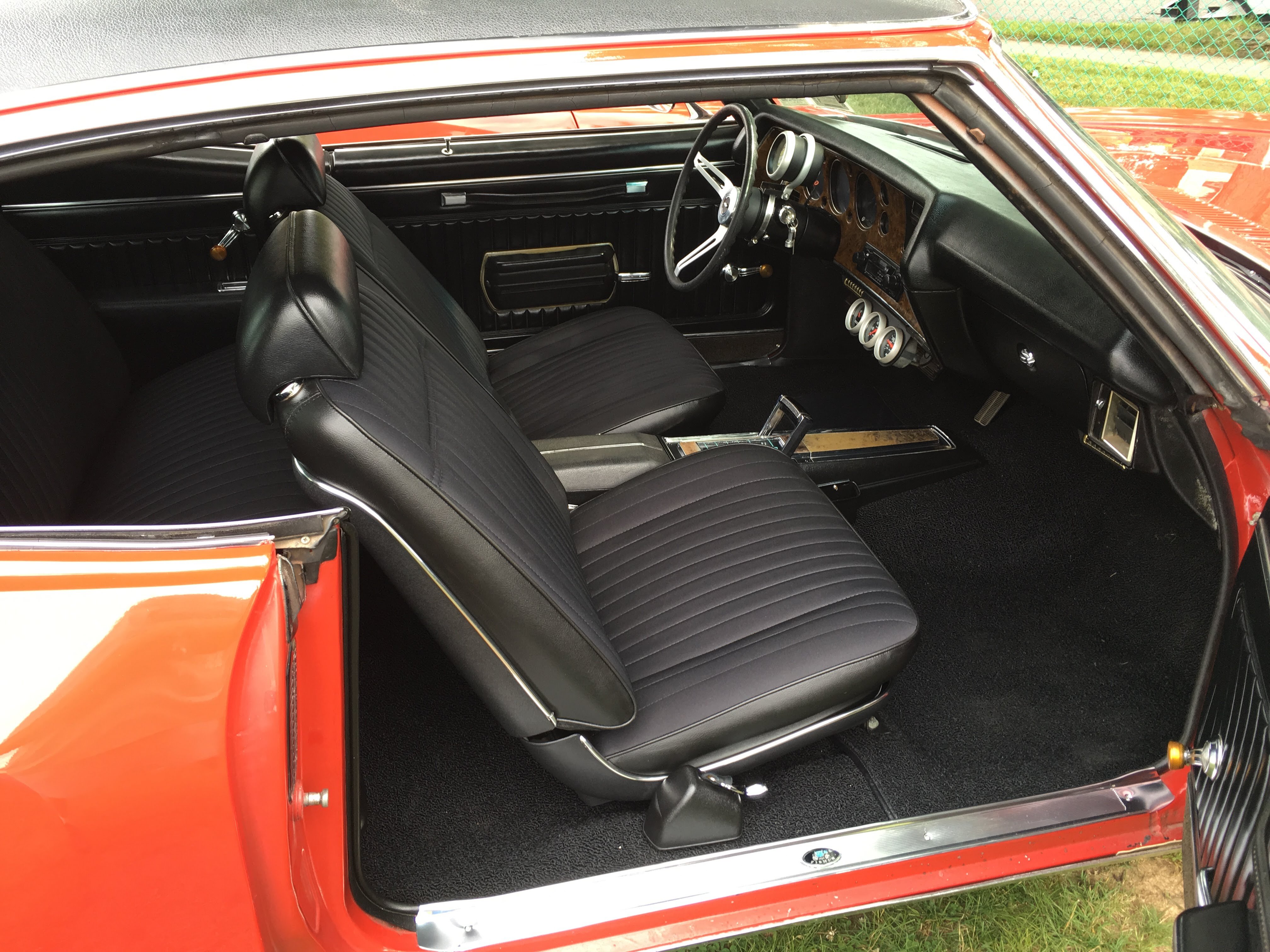

MC1of80 Posted July 20, 2021 Posted July 20, 2021 Idk. I have the same seat covers but had them professionally installed. Here is a pic, hope it helps... 1 Quote
Blackhawk Posted July 20, 2021 Posted July 20, 2021 When I tried looking this up before I believe the stock covers weren't tied down with the horizontal listing. However, it looks good to have it partially pulled down. I'm in the middle of doing upper 70 bucket covers and I just put tension on that seam using zip ties, they didn't need to be pulled as tight as the side seams. You would have to cut the foam for a channel. Quote
Mike Brichta Posted July 20, 2021 Posted July 20, 2021 If you ordered new foams from Legendary, they should have "groves" in them for pulling these pockets into. I agree that if you fasten them to the springs, that is too much. I use the heavy wire from coat hangers in the pockets and zip ties to pull them towards the seat springs for the tension that looks good to you. If I ever get my seat covers from Legendary, that's what I'll be doing. Hope that helps. Good luck!! Quote
Blackhawk Posted July 20, 2021 Posted July 20, 2021 The ACI foams only have the vertical channels for the bolsters, no horizontal channels. Quote
Mike Brichta Posted July 20, 2021 Posted July 20, 2021 I stand corrected. Cody is correct. ACI foams only have the vertical grooves. No horizontal ones. Sorry for the confusion. Thanks!! Quote
Gush's monte Posted July 20, 2021 Posted July 20, 2021 Frank, look at the Legendary video for the 69 Chevelle covers as it shows how to install the bolster listing wires. The video is really good at showing all the steps needed to install their covers on 68-70 bucket seat covers as they are very similar in design. The bolster listings need to be installed in the correct position on top of the burlap and hog ringed to the seat springs. Then when you hog ring the seat cover listing wire to the seat listing wire it will pull the seat cover down to give it the factory bolster look. I will need to do the same with my 1970 Chevelle covers but won’t be doing them until sometime in August as I just received the seat foam for them. Quote
