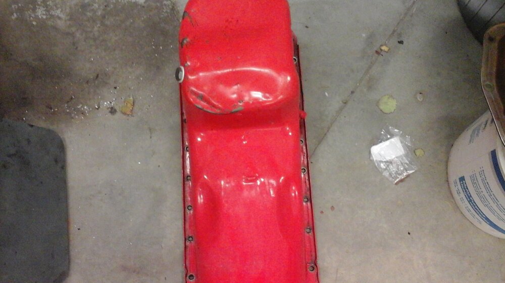

Grant MacPherson Posted September 22, 2021 Posted September 22, 2021 Has anyone done an R&R oil pan without pulling the engine? I had an argument with a rock and lost!. A quick look and it appears that if I pull the fan blade and distributer cap, I could lift the engine enough to get the pan off? thoughts? Quote

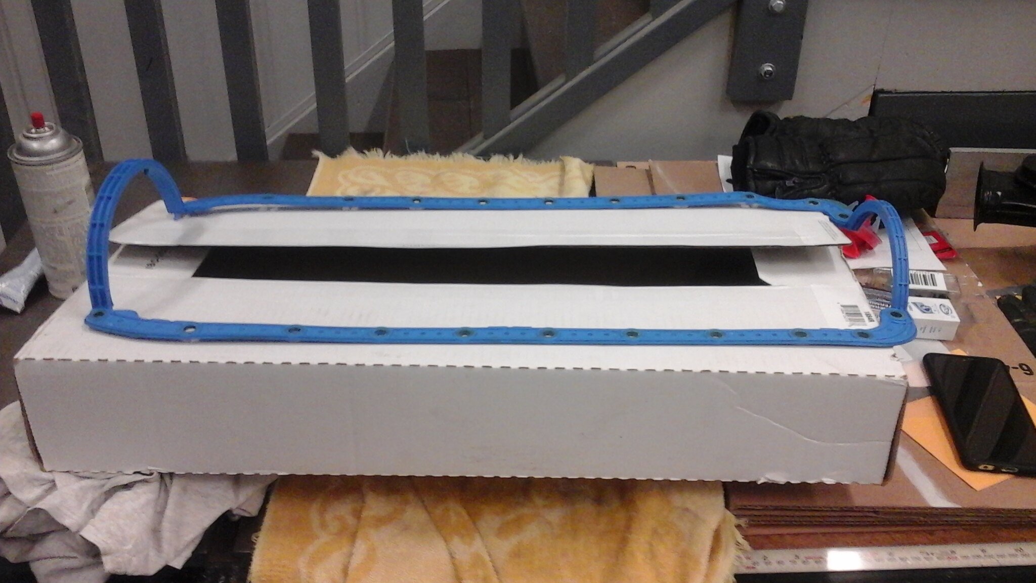

dejh22 Posted September 23, 2021 Posted September 23, 2021 I took my big block oil pan out twice one summer a few years ago. First I replaced the oil pan gasket. Then figured out later it was the rear main leaking. So I pulled it again to install a new seal. I'm try to remember but I think I used the cherry picker to lift the front of the engine after the motor mount bolts were taken out. I do not think I removed the valve covers. I did take the distributor cap off. For safety I did put a 2x4 between the motor mount and block when the engine was lifted. The oil pan did not just "fall" out, took a little maneuvering but it did come out. I used a one pc oil pan gasket. They make a plastic "stud" that screw into the block. They hold the gasket in place while you get the oil pan back in place. Then back one plastic holder out at a time and put the bolt back in. Quote

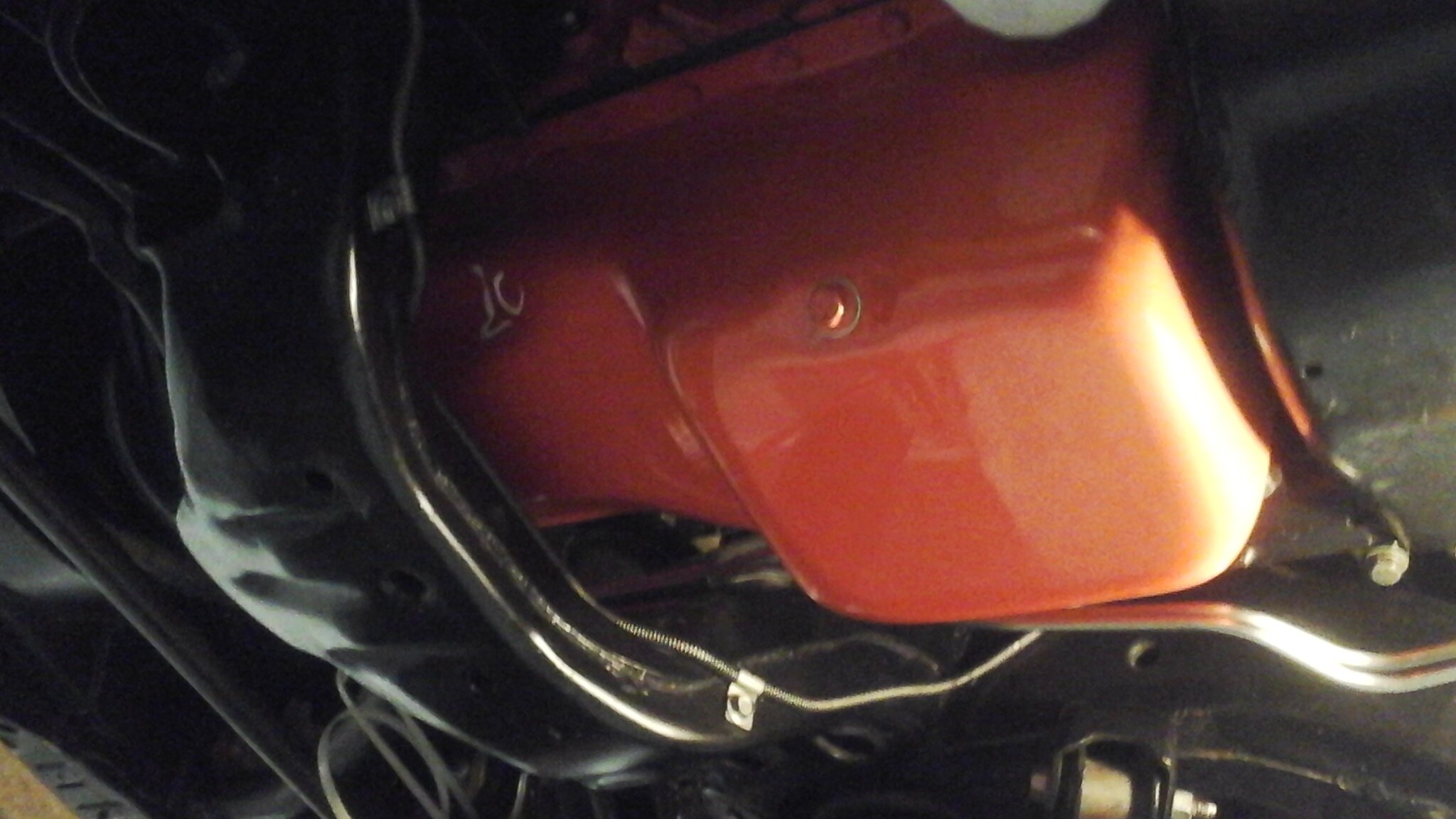

Grant MacPherson Posted November 23, 2021 Author Posted November 23, 2021 new oil pan is in !!!!!!! removed distributer cap and fan, lifed the engine and slid the old pan out. little tight but not bad. Checked bottom end and everything in on the tight end of specs. plasti gauged #8 rod and #3 main are still standard and look mint. High volume GM oil pump, doulble roller timming chain. I didn't have any info on the engine so happy with what I found. I used the 1 piece seal, went on nice hope it doesn't leak. Next up, pull drive shaft, trans rear housing and change speedo gears to match 3.42 diff. 2 Quote
MC1of80 Posted November 23, 2021 Posted November 23, 2021 Sweet! Ya gotta love it when a plan comes together! Nice job! That little smash is why you changed it? Lol. I'd hate to show you the sump on "Barn Find" Quote
Grant MacPherson Posted November 24, 2021 Author Posted November 24, 2021 If I had bought it that way it probably wouldn't have bothered me as much. It was a trailer queen before I got it, not anymore but I am trying to keep it as show presentable as possible. 2 years and 8000 miles, last owner had it for 10-11 years and put 3000 on it. He was surprised when I didn't show up with a trailer for the trip home. 2 Quote
