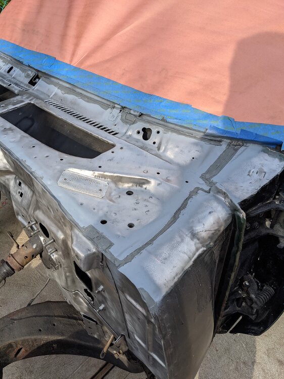

MC1of80 Posted November 21, 2021 Author Posted November 21, 2021 Hello all! This week's update: Kevin welded up all the "unknown, unneeded" holes in the firewall, we finished stripping down the paint on the underside of the chassis and managed to prime everything. I also have totally disassembled one of the tilt columns we have "in stock" to assess the internals and restore it for an Xmas gift to my son. Yes, he will be getting other things also. Lololol and he does know about it. Lol 3 Quote

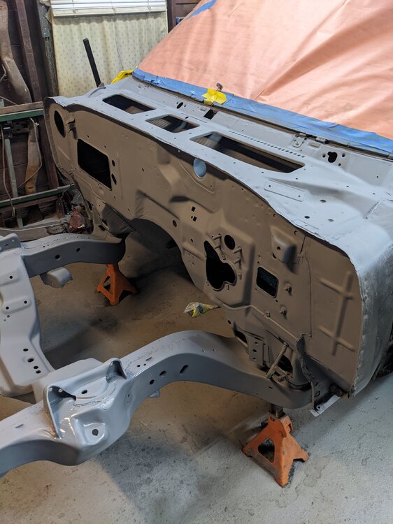

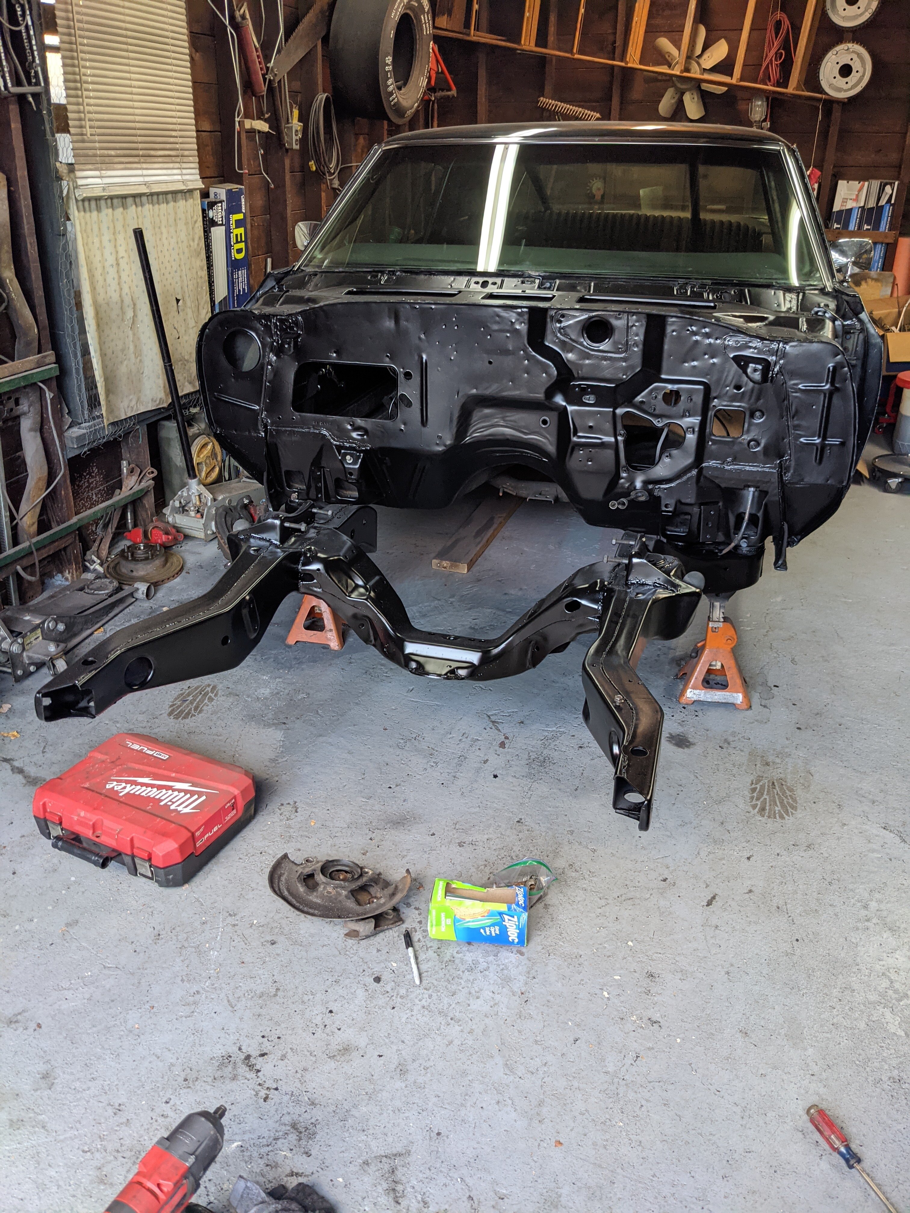

MC1of80 Posted November 27, 2021 Author Posted November 27, 2021 Hello, hello! This week's update! Chassis and firewall painted. Parts starting to go back on. Idler arm, manually steering box, coupler and center link. Spindles broken down, cleaned and painted. Tilt column parts all painted and getting ready to reassemble. Still waiting for a few parts to be delivered and have to order some more. Snowball affect! Lol 5 Quote

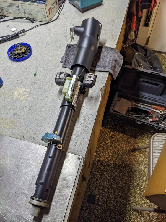

MC1of80 Posted November 28, 2021 Author Posted November 28, 2021 Today's project... The first 2 pics are of selector shafts. The long one is for a non tilt and the shorter a tilt column. The arm for the back drive was cut off the tilt shaft. Idk why, that's how I got it. Was going to try to swap the non tilt lower portion to the tilt and make it stock but to no avail. Removed what was left of the arm from the tilt column shaft and painted. We decided to do this anticipating the huge headers he is planning to use. That's our story with that. Lol Reassembled the tilt steering column as far as I could. No turn signal switch yet. Still waiting for it. Also disassembled the lower shaft, repacked the joint with grease and reassembled that also. So close, yet so far!!!! Normal! 4 Quote
willie Posted November 29, 2021 Posted November 29, 2021 Yes it looks really good Tom!!! Do you need to weld the arm back on the tilt shaft? 1 Quote
MC1of80 Posted November 29, 2021 Author Posted November 29, 2021 No Willie. The arm/lever is at the bottom of the steering column that is inside the engine compartment for the back drive. Quote

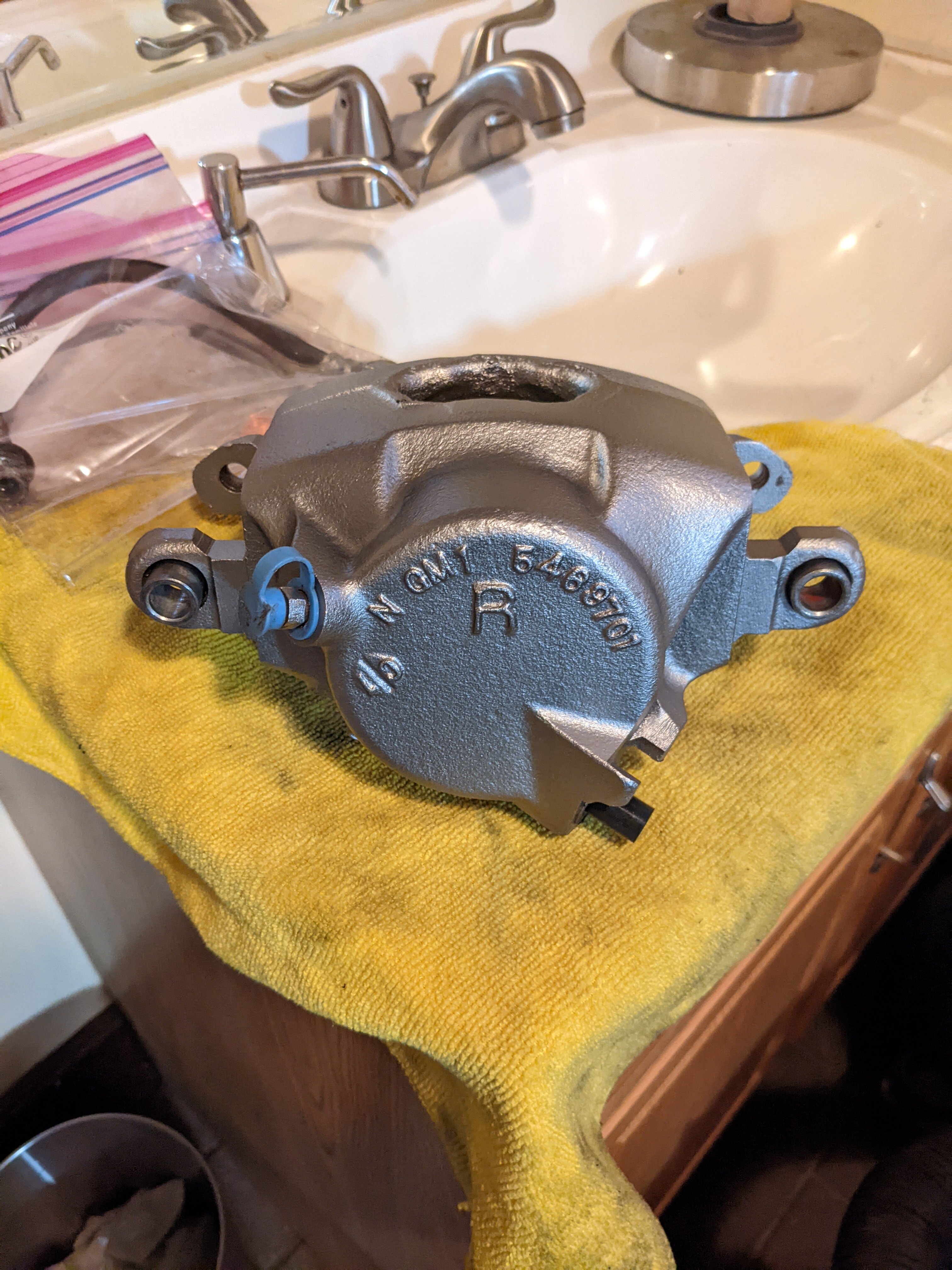

MC1of80 Posted December 5, 2021 Author Posted December 5, 2021 Sorry, not much progress this week. Who was working, parts still not here, a roof being done, etc. Lolol. We did get the restored steering column, upper and lower control arms, and restored windshield wiper motor installed. Inner and outer tie rods with sleeve assembled. Calipers painted and new sleeves with bushings installed. Backing plates and caliper brackets cleaned and painted. 4 Quote
