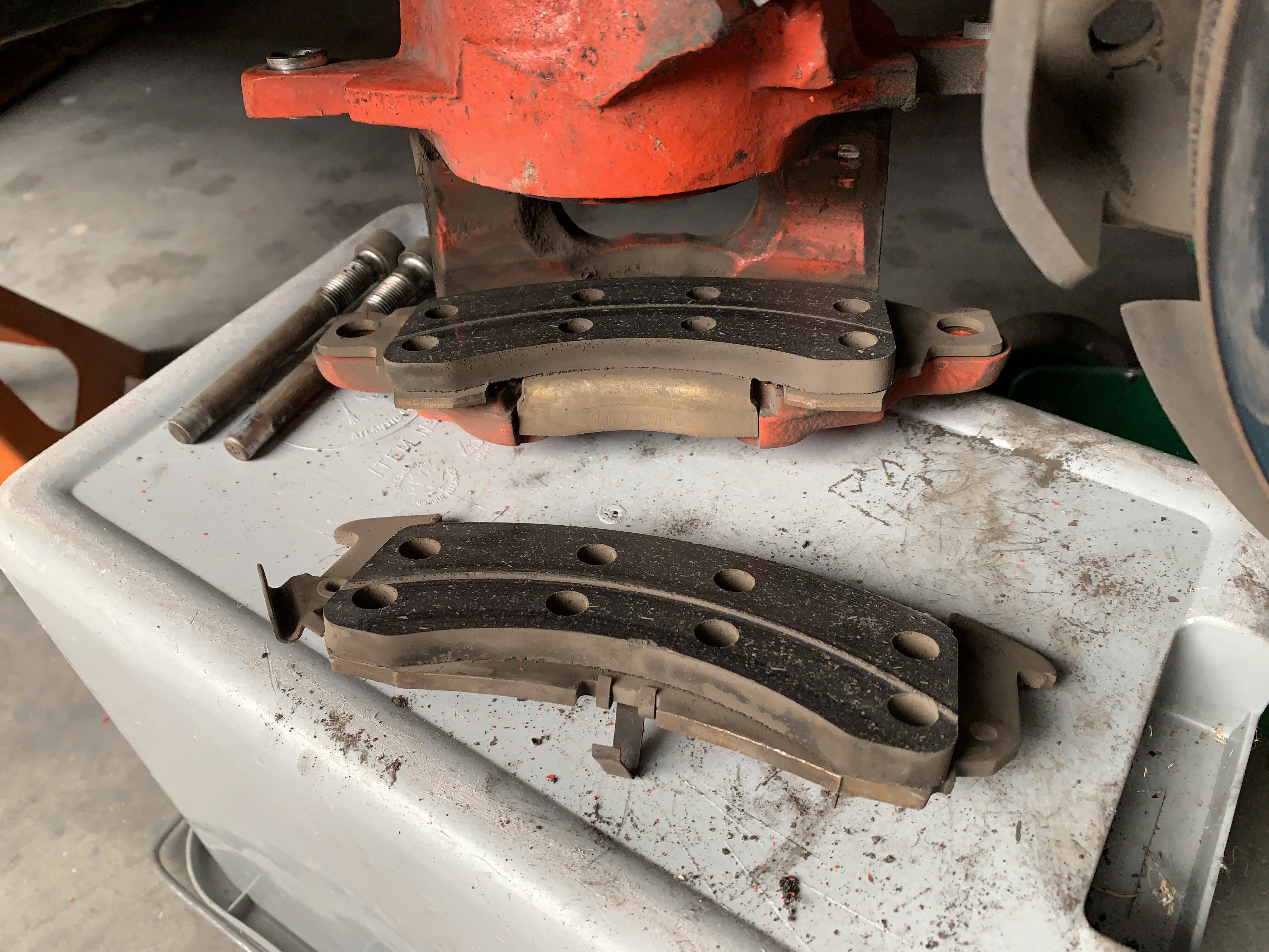

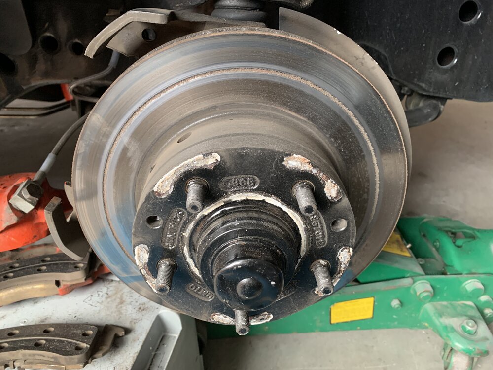

Canuck Posted November 7, 2021 Posted November 7, 2021 I have an intermittent brake squeak rolling at low speed (usually cruising the beach). Usually only when the brakes are warm/hot after some driving. If I touch the brakes the squeak goes away but returns when I let off the brake. I pulled a calliper off and I’ve got lots of pad left and appears to be wearing evenly between the 2 pads. These rotors do have a groove in them which I’ve never had on any of my previous Montes. Any thoughts? Quote
MCfan Posted November 7, 2021 Posted November 7, 2021 I've never seen a groove that wide in any rotor! Usually it is just a small V groove that would turn bright when the pads were nearing end of life. Your pads are wearing almost enough to polish the sides and bottom of that wide groove also. Seems to me you are giving up a lot (1/4 to 1/3) of your disc surface area that could be used effectively for braking. Are you sure the squeaking is coming from the front? 2 Quote
MC1of80 Posted November 7, 2021 Posted November 7, 2021 That's a factory rotor. As far as the squeaking, the pads look glazed, shiny. Try scuffing the pads with some 80 grit sandpaper and reinstalling. 3 Quote
jft69z Posted November 7, 2021 Posted November 7, 2021 I pulled rotors like that off my car, no issues with squeaks at the time. Make sure the tabs with the arrows are crimped tight to the caliper. A large set of channel-locs work good here. There's a little step on the bottom of the pad for one of the jaws. This helps the pad from vibrating & causing the squeal. Hard to see from the pics if your pads have that tab, looks like standard D52 brakes though. I usually use some type of spray on 'Disc Brake Quiet' stuff on the back of the pad too. Permatex, NAPA, etc, they all have it. 3 Quote
Dtret Posted November 7, 2021 Posted November 7, 2021 You do a lot of soft braking I’ll bet. A few good 50 mph hard stops will help keep the pads from glazing in the future. I agree with the sandpaper on the pads. Hit the rotors too. 1 Quote
cny first gen 71 Posted November 7, 2021 Posted November 7, 2021 Yea probably oe rotor they used to have that groove in them. A squeal is a pad vibration, like Joe said make sure the pads are tight in the calipers and the clip on inner pad is tight. The ceramic pads I used on mine with the drilled and slotted rotors have shims on them too. Make sure everything is lubbed up good In The proper places. 1 Quote
Rob Peters Posted November 7, 2021 Posted November 7, 2021 That is a factory stock rotor. They are the same as what is on my70 Monte. rob 1 Quote

MC1of80 Posted November 7, 2021 Posted November 7, 2021 Aaron, there is also a spray on coating of sorts. You spray it on the metal part of the pads, install the pads, bend the tabs tight as Joe stated. All should be good. It goes by many names but "disc brake quiet" I believe is one of them. 1 Quote
bob 71 Posted November 9, 2021 Posted November 9, 2021 hi aaron how is the clip on the back side of the inboard pad? i use a pink brake lube on the metal sides of pads befoer i put pads into calipers. on my car and at my shop Quote

MC1of80 Posted November 9, 2021 Posted November 9, 2021 With everything installed I pump the brakes, tap a screwdriver between the bottom of the pad and the rotor, where the rim seats. Then with a chisel I "whack" the tabs down till they are snug/tight on the caliper. 2 Quote

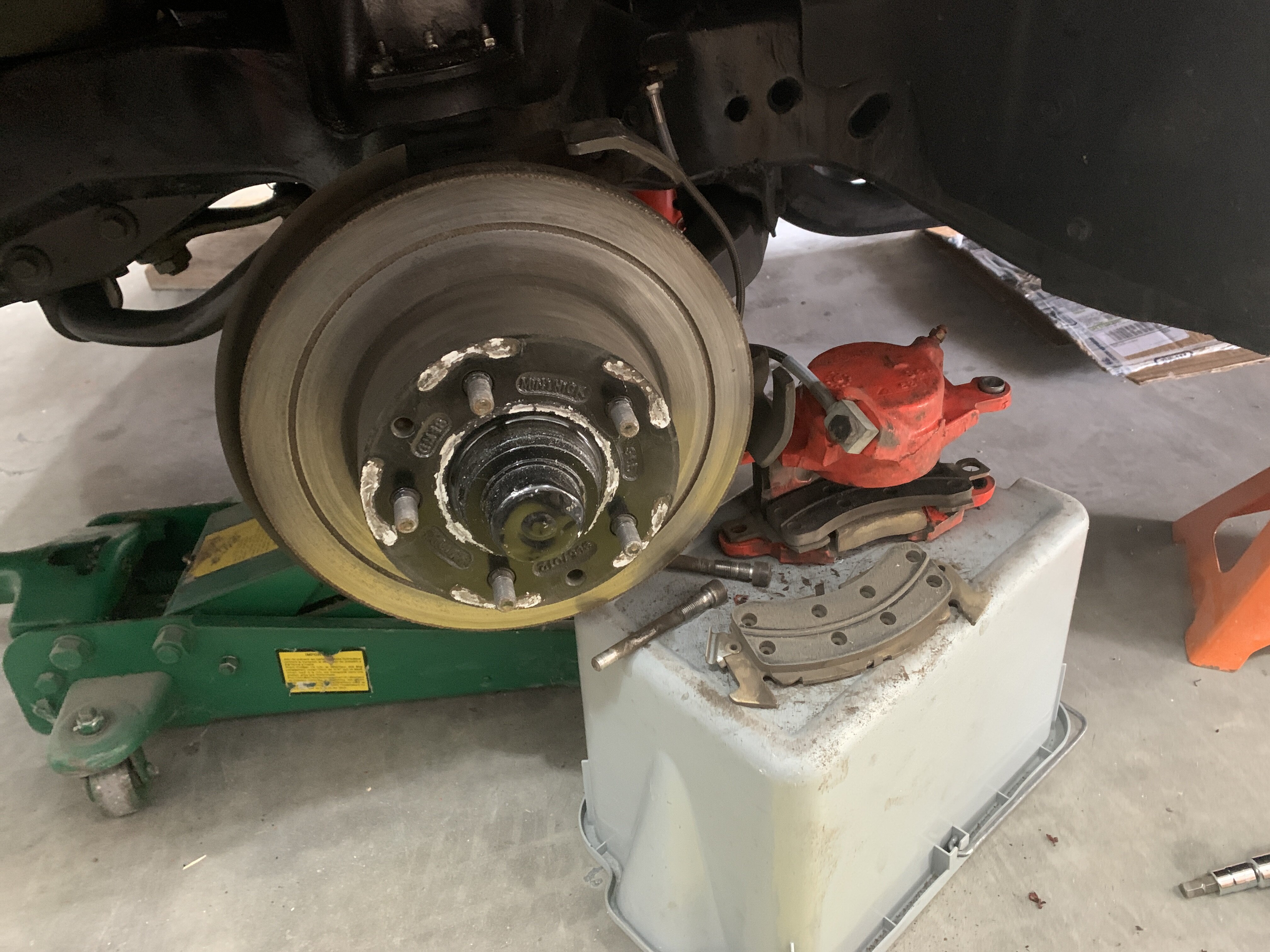

Canuck Posted June 12, 2022 Author Posted June 12, 2022 Yesterday I finally got around to pulling the calipers. I sanded the pads, sanded the rotors, bent the clip for the inner pad slightly so it holds the pad nice and tight, used disc brake quiet, bent the tabs on the outer pad so they are tight to the caliper and lubed up the caliper pins. I still have the squeak. For all the pads Ive changed over the past 25 years on multiple Montes I’ve never had this issue. I believe these pads are 15-20 years old if that makes a difference. The person that put these pads on used RTV where the pad meets the caliper likely to fix this squeak. I scraped all that off to see if that helped but didn’t make a difference. The sound certainly sounds like the front brakes but I’ll pull the drums off to inspect those just in case. Meanwhile, when I cruise the beach… eeek, eeek, eeek, eeek, eeek…. LOL My 12-year-old daughter was interested in what I was doing today. She learned how disc brakes work. 2 Quote
cny first gen 71 Posted June 12, 2022 Posted June 12, 2022 It's probably the rust ridige causing your problems, I probably would have resurfaced the rotors (if they are thick enough) and put a new set of organic pads on at this time. 1 Quote

Dtret Posted June 12, 2022 Posted June 12, 2022 Based on the look of the rotor you’re not getting full pad contact. See the dark glazing near the hub. I know the groove is original to the rotor but clean that out really good and put a new set of pads on. Or sand it down. Also the rivits if worn will make the pad move ever so slightly, causing noise. 3 Quote
cny first gen 71 Posted June 12, 2022 Posted June 12, 2022 I assume you have it all back together now but another thing you can try is spin the rotor around by hand and use a die grinder and grind the rust ridge off the inside and outside edges and put a non directional pattern on the rotors. 1 Quote
