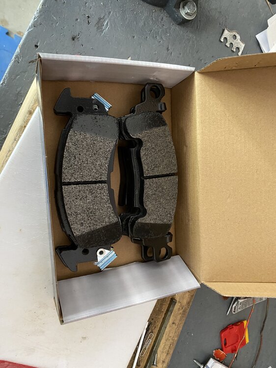

Canuck Posted July 21, 2022 Author Posted July 21, 2022 I had the pads out a few times trying everything above but still ended up with the squeak. In the end I think it came down to bad design of the pad. There are rivets on the back side of the pad so it doesn’t sit flush against the caliper. I installed new pads that are flat on the back and so far no squeaking but time will tell. 1 Quote

cny first gen 71 Posted July 22, 2022 Posted July 22, 2022 Ya know another thing we used to do I grind the sharp front edge off the pad at about a 45 degree angle it seems to help sometimes. 1 Quote
Canuck Posted July 22, 2022 Author Posted July 22, 2022 3 hours ago, cny first gen 71 said: Ya know another thing we used to do I grind the sharp front edge off the pad at about a 45 degree angle it seems to help sometimes. The new pads I got already have the edges on an angle. Nice feature. Quote
Dtret Posted July 22, 2022 Posted July 22, 2022 Something I learned from a brake manufacturer about chamfered edges. I asked why they started doing that. He says do you want the story we tell the public or the truth?  Truth is we chamfer to cut down the noise long enough to get the pad out of warranty, when the chamfer is worn down your right back to the normal flat pad. But people don’t worry about buying again a couple years down the road. I probably should not have asked. Lol. 1 Quote
cny first gen 71 Posted July 22, 2022 Posted July 22, 2022 1 hour ago, Dtret said: Something I learned from a brake manufacturer about chamfered edges. I asked why they started doing that. He says do you want the story we tell the public or the truth?  Truth is we chamfer to cut down the noise long enough to get the pad out of warranty, when the chamfer is worn down your right back to the normal flat pad. But people don’t worry about buying again a couple years down the road. I probably should not have asked. Lol. There is a lot of truth to that, I worked in a brake shop for a bunch of years and was called a brake expert but in my opinion I was far from an expert but could do brakes with the best of them. Was also ASE certified in brakes and suspension but there's still lots I don't know. Quote
