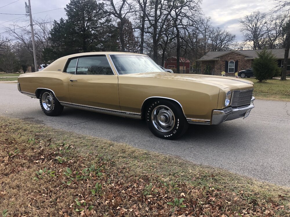

TXSteve33 Posted December 23, 2021 Author Posted December 23, 2021 The car I was hoping to authenticate didn’t pan out BUT I was after a big block 70 and I found one So now a new question Am I able to verify if my car is a factory 4 speed? I know it is not a real SS (it is badged as one) 4 Quote
1970mcss Posted December 23, 2021 Posted December 23, 2021 Good looking Monte. Build sheet, or if it has the original motor check the code on the engine block. Also check the resources page below https://www.firstgenmc.com/forums/index.php?/resources/decodingengine/ Quote
MC1of80 Posted December 23, 2021 Posted December 23, 2021 Check the numbers stamped on the transmission. Do they match your partial Vin? Date code within 6 months of your build date? Is there a bracket by the front control arm, driver's side with the clutch return spring attached to it? Of course the build sheet is a definite way. P.S. nice purchase! Tell us more about it and more pics!!! Quote
Canuck Posted December 23, 2021 Posted December 23, 2021 Nice find! Good timing, I just finished this transmission page on the weekend. https://www.firstgenmc.com/forums/index.php?/resources/decodingtransmission/ The engine page Paul posted I also finished just a few weeks ago. Quote

Glen Posted December 24, 2021 Posted December 24, 2021 Welcome to the group. Great looking ride and I love the color. Like the others have chimed in, the build sheet is the ultimate authority on exactly what you have. Absent that, start compiling numbers from the motor, tranny, rear end, cowl tag etc and get to decipherin’. “Chevrolet By the Numbers” is damn near the Bible to authenticate every part of that drive train. And Aaron has put together very helpful information which he’s provided links to above. And you can always send pictures here and I’m sure you’ll get answers…tons of knowledge here Happy hunting Quote
