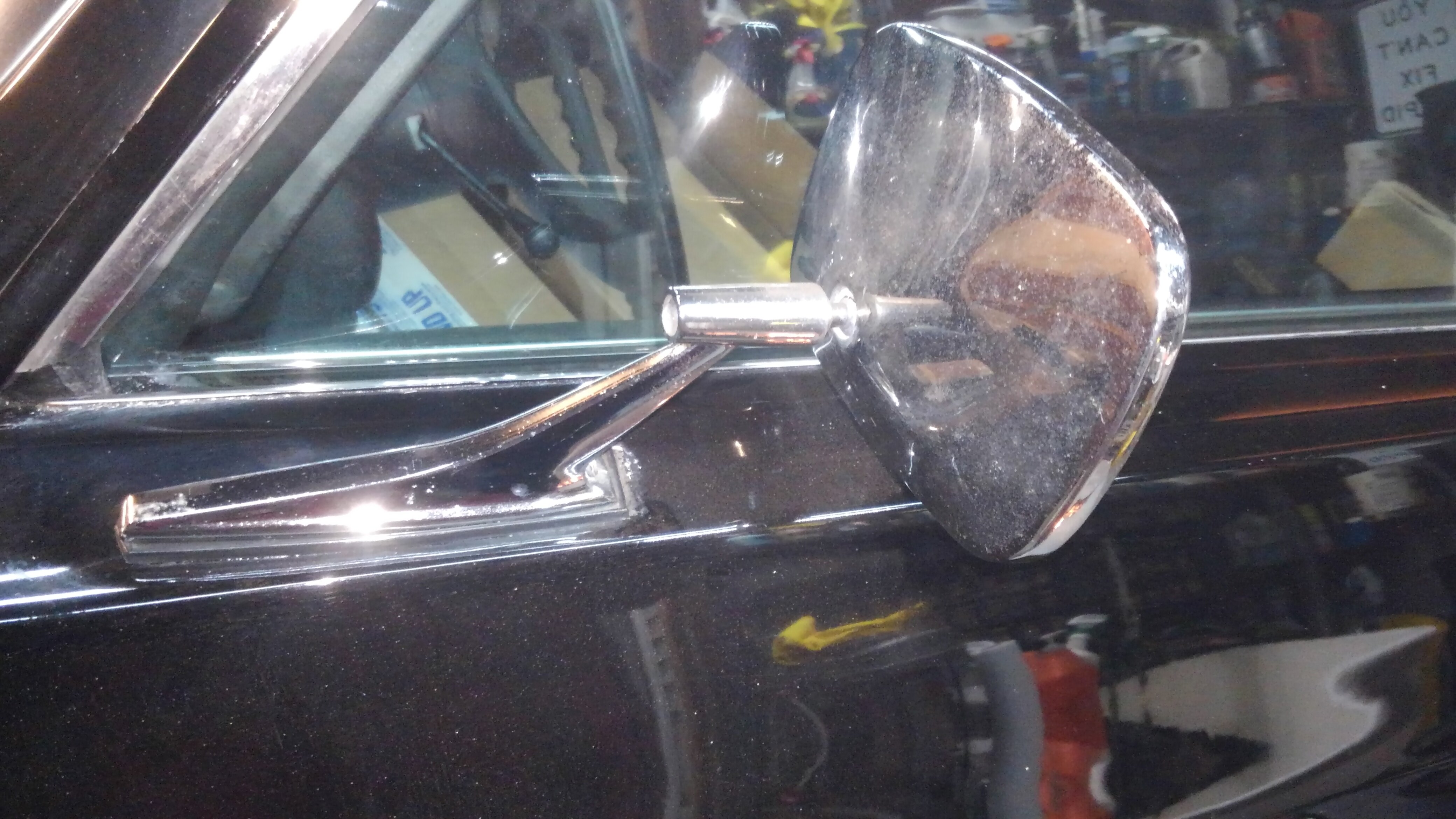

714024SPEED Posted December 8, 2021 Posted December 8, 2021 Here is a standard mirror on on of our 70 Monte's. The mounting screws for the bracket is 2 1/8" center of screws.hope this helps 1 Quote
drdave69 Posted December 8, 2021 Author Posted December 8, 2021 Thanks for the photo and measurement. It looks like that bracket has a mounting hole added on the right end. It appears that the mounting holes on the door are the same as mine (although I measured 2 inches). Did you by chance measure the overall length of the bracket? Quote
drdave69 Posted December 9, 2021 Author Posted December 9, 2021 Thanks again Kevin. It looks like your bracket is the same length as the new bracket I ordered with an extra hole drilled for the 2" spread of the mounting holes. I'll monkey with it again soon. Quote
