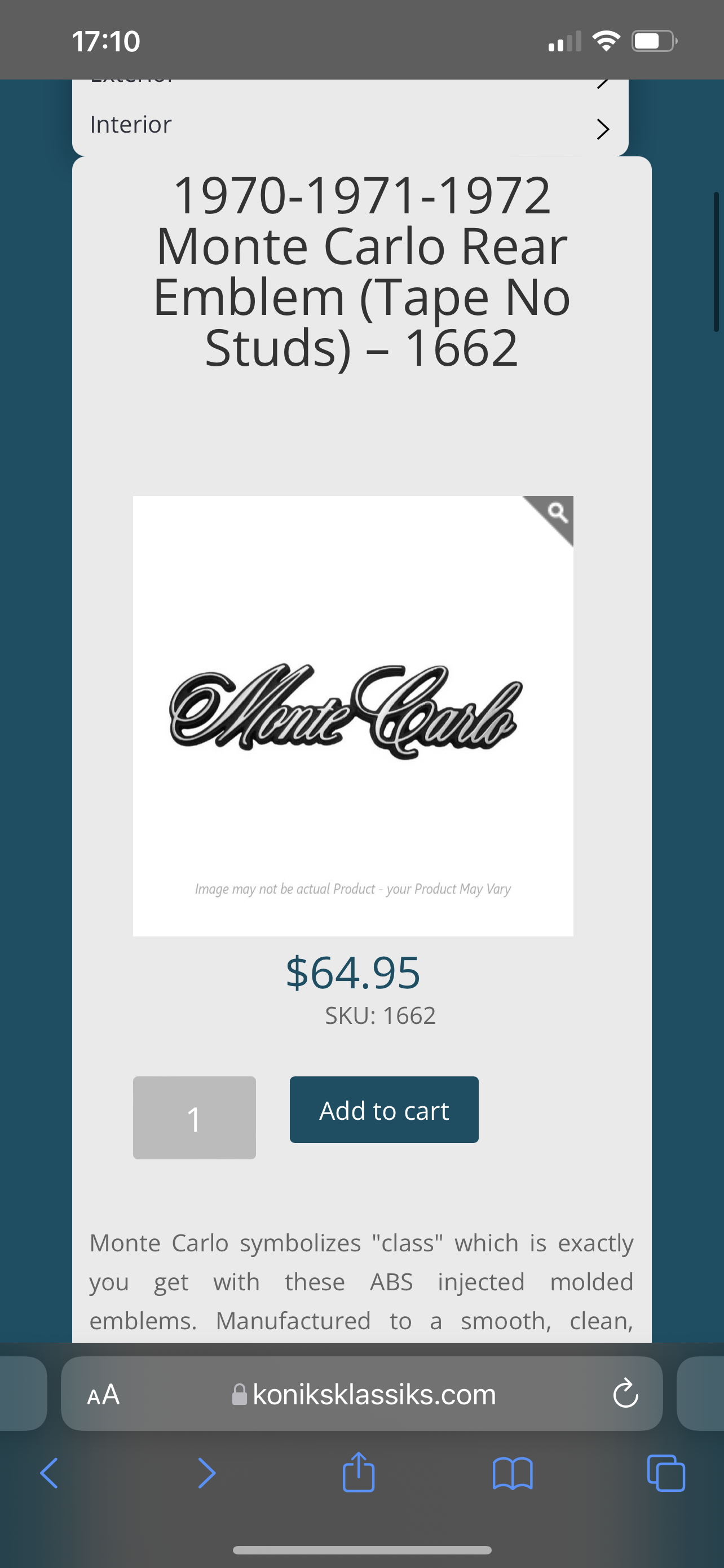

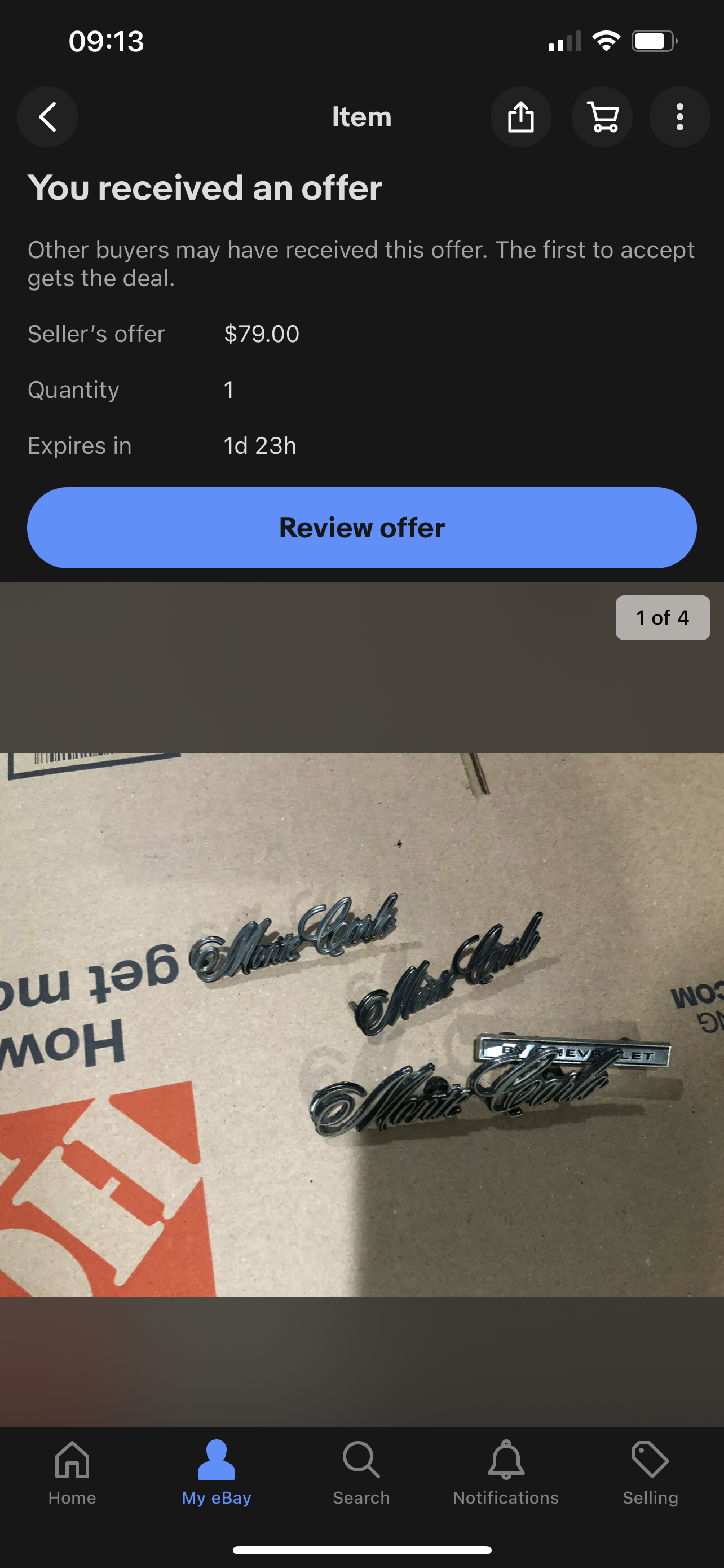

jft69z Posted January 18, 2022 Posted January 18, 2022 12 minutes ago, MrDavie said: She’s def a keeper!! I was Security Forces, Intel, and Administration… Interesting jobs, I like it! I was a PMEL tech, (calibration of electronic & physical/dimensional test equipment). As far as the badging, the rear of a '72 does NOT have the 'by Chevrolet' emblem. Just a 'Monte Carlo' on the right side, attached to the '72 only aluminum trim piece below the trunk lid. As far as the sail panel holes, make sure to get 'M/C' emblems specifically for the 70-72 sail panel, as there are a few different sized emblems out there. Quote
MrDavie Posted January 18, 2022 Author Posted January 18, 2022 33 minutes ago, jft69z said: Interesting jobs, I like it! I was a PMEL tech, (calibration of electronic & physical/dimensional test equipment). As far as the badging, the rear of a '72 does NOT have the 'by Chevrolet' emblem. Just a 'Monte Carlo' on the right side, attached to the '72 only aluminum trim piece below the trunk lid. As far as the sail panel holes, make sure to get 'M/C' emblems specifically for the 70-72 sail panel, as there are a few different sized emblems out there. Got it, so do you know where I can find the Monte Carlo for the aluminum trim below the trunk lid? How does it attach? How do the sail panel emblems attach to the vinyl? I get the car in a couple of weeks, I hope the holes were labeled when they attached the vinyl. Do you know where to find the sail panel emblems? My best friend was PMEL!! Quote
jft69z Posted January 18, 2022 Posted January 18, 2022 1 minute ago, MrDavie said: Got it, so do you know where I can find the Monte Carlo for the aluminum trim below the trunk lid? How does it attach? How do the sail panel emblems attach to the vinyl? I get the car in a couple of weeks, I hope the holes were labeled when they attached the vinyl. Do you know where to find the sail panel emblems? My best friend was PMEL!! The 'Parts Place' is where I think I got the sail panel emblems for my car. They usually attach with barrel nuts that fit into the sheet metal itself & the emblem 'pops' in. You may have to remove the interior sail panel trim to look and see what's in there from the back side, plus that'll let you know if the holes are already there, or if someone filled them up. The rear panel M/C is physically attached to the trim, with the posts peened over. To replace it, you have to carefully drill the head off the back side. Do you have any pics of the back of the car? I'm wondering what's back there & if you should maybe wait until you get the car, before spending money on parts you may not need. I had my rear aluminum trim re-anodized a couple of years ago (not cheap) and they re-chromed the M/C emblem at the time. Those aren't readily available, but I did find a NOS (New Old Stock - GM) one on ebay at the time, plus I think I ordered another one from someplace that was a close fit if I needed it. The thought at the time was to just replace it vs. paying to have my original chromed (cost to re-chrome vs. new one). In the end, he did the emblem for free due to delays, so I have the others in stock if you really need one. Quote
MrDavie Posted January 18, 2022 Author Posted January 18, 2022 2 minutes ago, jft69z said: The 'Parts Place' is where I think I got the sail panel emblems for my car. They usually attach with barrel nuts that fit into the sheet metal itself & the emblem 'pops' in. You may have to remove the interior sail panel trim to look and see what's in there from the back side, plus that'll let you know if the holes are already there, or if someone filled them up. The rear panel M/C is physically attached to the trim, with the posts peened over. To replace it, you have to carefully drill the head off the back side. Do you have any pics of the back of the car? I'm wondering what's back there & if you should maybe wait until you get the car, before spending money on parts you may not need. I had my rear aluminum trim re-anodized a couple of years ago (not cheap) and they re-chromed the M/C emblem at the time. Those aren't readily available, but I did find a NOS (New Old Stock - GM) one on ebay at the time, plus I think I ordered another one from someplace that was a close fit if I needed it. The thought at the time was to just replace it vs. paying to have my original chromed (cost to re-chrome vs. new one). In the end, he did the emblem for free due to delays, so I have the others in stock if you really need one. Understood, thx for the detailed response and assistance. I’ll wait until the car arrives (shipping from FL). Here is the link to the car (only change is I added the vinyl top): https://www.survivor-cars.com/vehicles/411/1972-chevrolet-monte-carlo# Quote
jft69z Posted January 18, 2022 Posted January 18, 2022 On 1/18/2022 at 10:22 AM, MrDavie said: Understood, thx for the detailed response and assistance. I’ll wait until the car arrives (shipping from FL). Here is the link to the car (only change is I added the vinyl top): https://www.survivor-cars.com/vehicles/411/1972-chevrolet-monte-carlo# That's right, I did see those pics. In that case, you have a few options I guess in regards to the rear panel. Leave it as is & get a M/C emblem like you initially though. Being a '72, I doubt I'd put the 'by Chevrolet' emblem on there, it wasn't there on that year. Or, you could tear a fistful of $100 bills in half and get the actual '72 trim piece (3 pieces actually). They show up on ebay occasionally, and a couple of the forum vendors here have them available, sometimes already restored (you'd have to call them to check availability). The only problem would be attaching them to the car. They're very specific metal & plastic clips and fasteners that aren't reproduced. Nothing to date that I've been able to cross match that would work either. To me though, that trim piece is an integral part of a 72 (I've had 3 of them, maybe I'm a little biased, lol). When the time gets closer, I'll dig thru my paperwork and get you some links to specific parts. In the mean time, here are a few places I've had good luck with in regards to parts. The Parts Place, SS396 (Ground UP), Summit, Year One (occasionally), Leo Konik (forum vendor), & Jared Richey (member). Other members will chime in with what works for them. OPGI seems like a good idea at first, until you realize they screw you on shipping, long delivery times and forever back ordered parts. I have gotten parts from them, not my first choice. Usually the last...well besides 'Inline Tube' now. Poor customer service, though they sometimes are the only supplier for very specific parts. Quote

MrDavie Posted January 18, 2022 Author Posted January 18, 2022 1 hour ago, jft69z said: That's right, I did see those pics. In that case, you have a few options I guess in regards to the rear panel. Leave it as is & get a M/C emblem like you initially though. Being a '72, I doubt I'd put the 'by Chevrolet' emblem on there, it wasn't there on that year. Or, you could tear a fistful of $100 bills in half and get the actual '72 trim piece (3 pieces actually). They show up on ebay occasionally, and a couple of the forum vendors here have them available, sometimes already restored (you'd have to call them to check availability). The only problem would be attaching them to the car. They're very specific metal & plastic clips and fasteners that aren't reproduced. Nothing to date that I've been able to cross match that would work either. To me though, that trim piece is an integral part of a 72 (I've had 3 of them, maybe I'm a little biased, lol). When the time gets closer, I'll dig thru my paperwork and get you some links to specific parts. In the mean time, here are a few places I've had good luck with in regards to parts. The Parts Place, SS396 (Ground UP), Summit, Year One (occasionally), Leo Konik (forum vendor), & Jared Ritchie (member). Other members will chime in with what works for them. OPGI seems like a good idea at first, until you realize they screw you on shipping, long delivery times and forever back ordered parts. I have gotten parts from them, not my first choice. Usually the last...well besides 'Inline Tube' now. Poor customer service, though they sometimes are the only supplier for very specific parts. Thanks!! I’ll “inspect” the car when it arrives and get back to you. Last question, for the Trunk Bezel, how is this installed? Through the sheet medal as well?? Quote

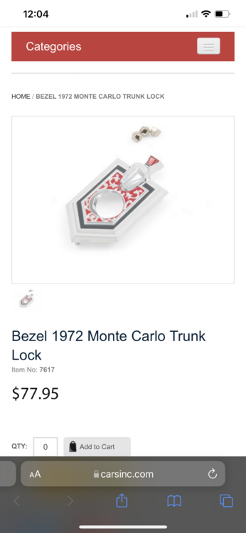

jft69z Posted January 18, 2022 Posted January 18, 2022 1 hour ago, MrDavie said: Last question, for the Trunk Bezel, how is this installed? Through the sheet medal as well?? Yes, there should be a few holes in the trunk lid for the bezel. Quote
MrDavie Posted January 18, 2022 Author Posted January 18, 2022 Team, 5 hours ago, MrDavie said: Thanks!! I’ll “inspect” the car when it arrives and get back to you. Last question, for the Trunk Bezel, how is this installed? Through the sheet medal as well?? To alleviate having to purchase the 3-part option, what are your thoughts about getting the “sticker” in the interim until I can get this done? And if there aren’t any holes for the sail panel emblems, shoulD I just take to an auto paint and body for install? What are the exact measurements for exactly where the sail panel emblems go? Quote
