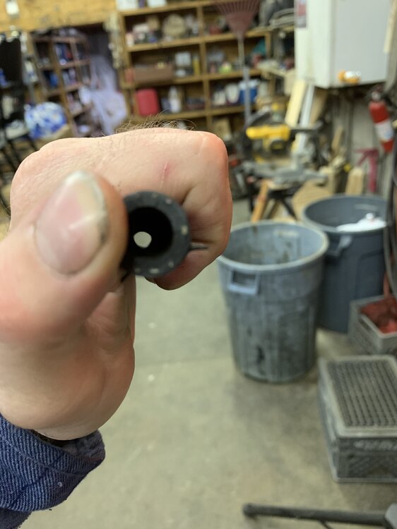

RazzNdazz Posted January 31, 2022 Author Posted January 31, 2022 Tube is clear of obstruction, check valve is working, I tested it separately. I took the compression nut off of the tube and cleaned the Teflon off. Then cleaned the adapter. Started car without the line hooked up and the carb is drawing a massive amount of air. Sounds like a jet! Reassembled without Teflon (because it’s a compression fitting) and so I believe it’s all sealed and connected properly. Calipers look new, pads and shoes are good. Rotors and drums are good. The brakes do grab and stop the car, it’s just very hard. I picture my great grandma driving this car as she had one in the 70’s. And there’s no way she would be able to stop this car. I can stop it because I’m strong enough to push the pedal hard. Quote

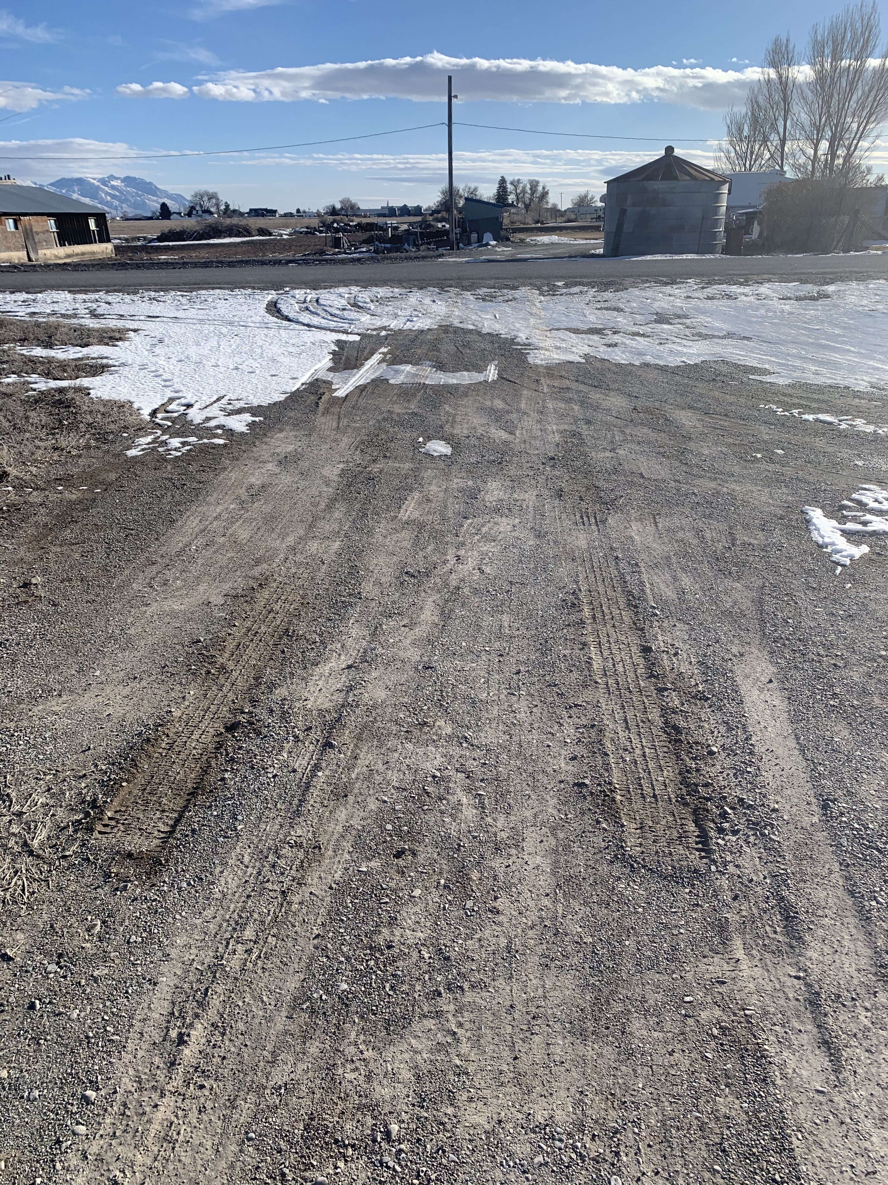

Rob Peters Posted January 31, 2022 Posted January 31, 2022 There are a lot of good ideas here. Just because all of the parts look new does not always equal that they are good, it just looks like they are new. If the booster is new the finish looks odd, usually they are plated rather than black. The booster would be my first pick. Scott mentions the push rod which is a possibility but I thought if it was the wrong length I would think it may different symptoms. I would also not rule out proper bleeding of the brakes. I thought air in the line would create spongy pedal. I was wondering if maybe collapsed or clogged lines. Have you taken it out onto a road that is gravel covered and done some braking and look at the skid marks to see if all 4 tires are locking/dragging gravel. If you have brakes not locking it may indicate bad brake line pressure or bad calipers etc. Bottom line, don't trust things that look new. We all know that nobody has ever received a bad part or two... or even three rob 1 Quote
RazzNdazz Posted January 31, 2022 Author Posted January 31, 2022 Thanks Rob! I haven’t done the gravel test but I sure can try that. There are oodles of gravel roads where I live! Also, I sent you an email several days ago. I’d like to pay my dues. Aaron D. told me to get hold of you. I’m in Utah and I’d like to attend the Western Meet in OR this year. Quote

Scott S. Posted January 31, 2022 Posted January 31, 2022 1 hour ago, Rob Peters said: There are a lot of good ideas here. Just because all of the parts look new does not always equal that they are good, it just looks like they are new. If the booster is new the finish looks odd, usually they are plated rather than black. The booster would be my first pick. Scott mentions the push rod which is a possibility but I thought if it was the wrong length I would think it may different symptoms. I would also not rule out proper bleeding of the brakes. I thought air in the line would create spongy pedal. I was wondering if maybe collapsed or clogged lines. Have you taken it out onto a road that is gravel covered and done some braking and look at the skid marks to see if all 4 tires are locking/dragging gravel. If you have brakes not locking it may indicate bad brake line pressure or bad calipers etc. Bottom line, don't trust things that look new. We all know that nobody has ever received a bad part or two... or even three rob Hey Rob, When I first swapped the booster, I didn't set the rod long enough, and the pedal hit bottom before the piston was fully engaged in the booster. Gave it that really stiff feel while not fully pressurizing the lines. Quote
Rob Peters Posted January 31, 2022 Posted January 31, 2022 4 minutes ago, Scott S. said: Hey Rob, When I first swapped the booster, I didn't set the rod long enough, and the pedal hit bottom before the piston was fully engaged in the booster. Gave it that really stiff feel while not fully pressurizing the lines. Good Deal!! rob 1 Quote
RazzNdazz Posted January 31, 2022 Author Posted January 31, 2022 Looks to me like all four are indeed locking up. Quote
MC1of80 Posted January 31, 2022 Posted January 31, 2022 Get, borrow, steal a vacuum gauge and see what vacuum the engine is producing. Is the first usage of the brakes normal then hard on the 2nd, 3rd etc uses? Or hard all the time? If hard all the time, not knowing the vacuum your engine is producing I would say the booster is bad. You could also let the car run for a little while, to build up vacuum in the booster, shut the car off and remove the check valve from the booster and listen for the vacuum/air exchange. If none, check that the check valve is working or installed in the correct direction. If that's all good, again the booster is most likely bad. 1 Quote
RazzNdazz Posted February 1, 2022 Author Posted February 1, 2022 I just picked up a gauge from my local parts store. Going to check it tomorrow. I did those very tests you’re speaking of last night and the pedal behaved as if the booster was not leaking. It’s a hard pedal every time; 1st, 2nd, etc. My dad was searching for available boosters for the car online and said there was 2 different ones that fit it. One has less boost than the other. But apparently they have the same bolt pattern and look the same from the outside. They have different diaphragms. We are thinking maybe this car has the weaker one. Like the booster is operating but perhaps not generating enough assist. Not certain but we think that may be what’s going on. Quote
MC1of80 Posted February 1, 2022 Posted February 1, 2022 If the pedal is hard all the time, the booster is leaking internally. Bad booster. If you had a normal pedal the first application, then a hard pedal after that, I would say the engine is not making enough vacuum. 1 Quote
