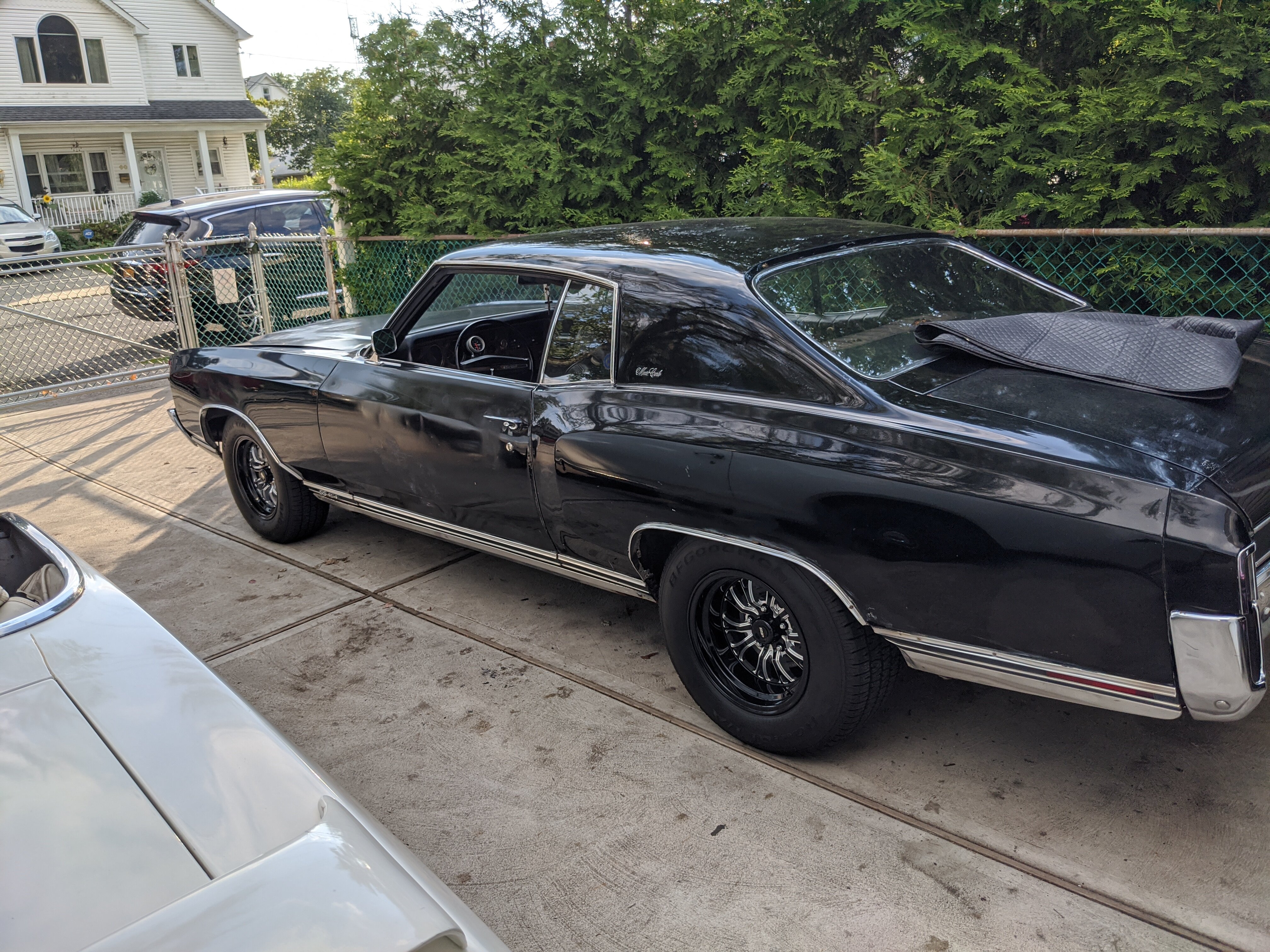

A 275/60 r15 with no issues. This is the "Covid" 71 Monte with 15x10 wheels with 5.5 backspacing and 275/60r15 tires.

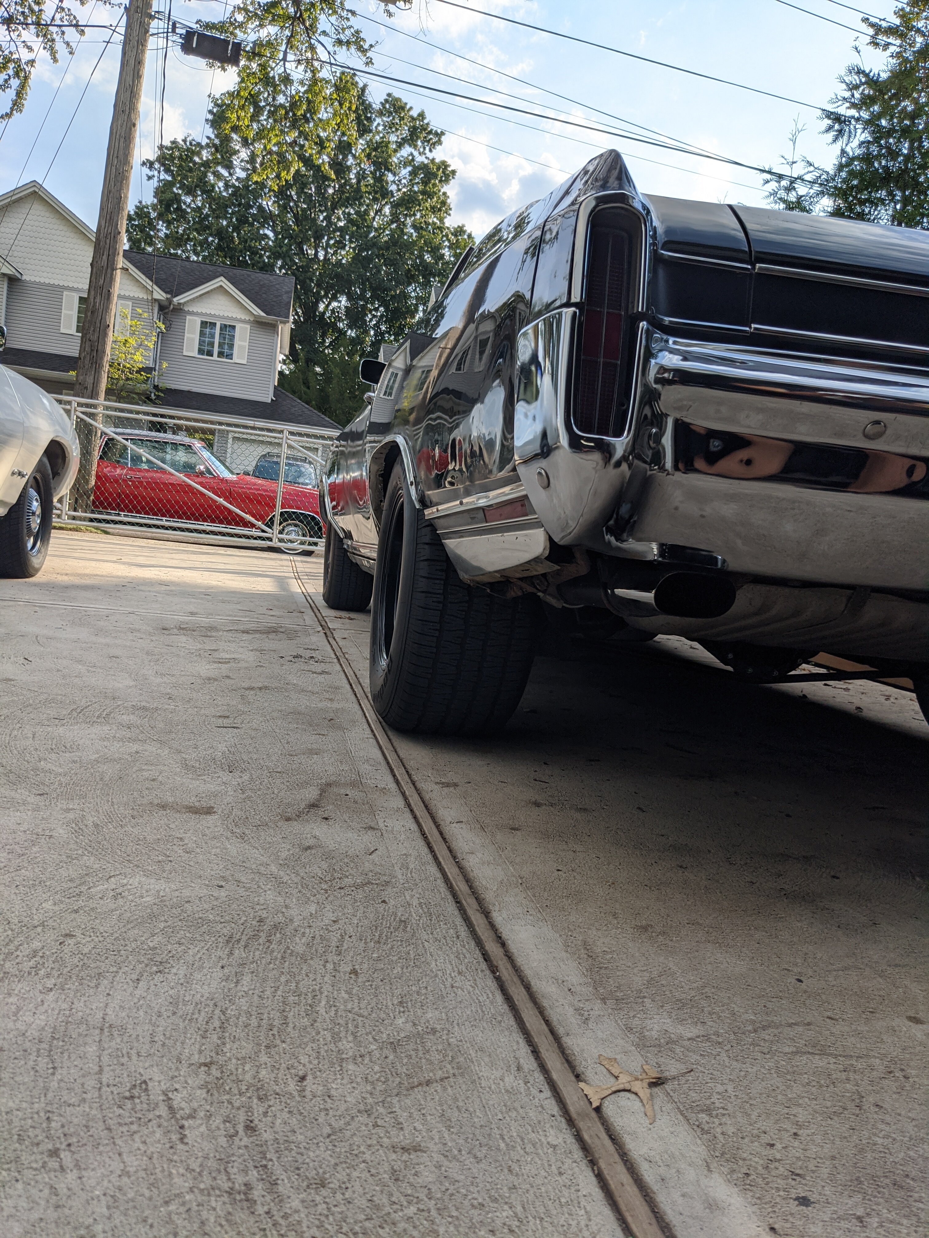

I was able to fit 295/50/15  WITH  15 X 10  5.5  in the rear only because I had installed the "Viking Coil over Shocks" in the rear. The rear shocks reposition the bottom of the shock inward towards the center of the dif about 1.5 inches.  I did also trim the wheel well about an 1/8 inch too.
295:50:15 side.jpg
295:50:15  rear view.jpg
  • Like 8
Thanks for the replies guys! Not a lot of tire options for 295-50r15s would it be possible to fit the taller 295-55r15s with the coil overs? Lip rolling is okay in my book.
