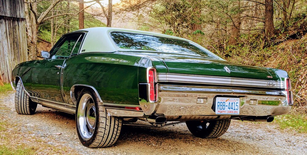

JP_AstroMan Posted February 6, 2022 Posted February 6, 2022 So I would really like my '72 Monte, that has wide tires all around and soon to have gobs of 460ci power, to handle as well as it looks. I live in some pretty extreme mountainous (nicely paved) roads. It would be AWESOME to drive this car powering through corners. Has anyone upgraded to a sporty suspension? I'd like to lower the center of gravity by an inch or two as well. 1 Quote
