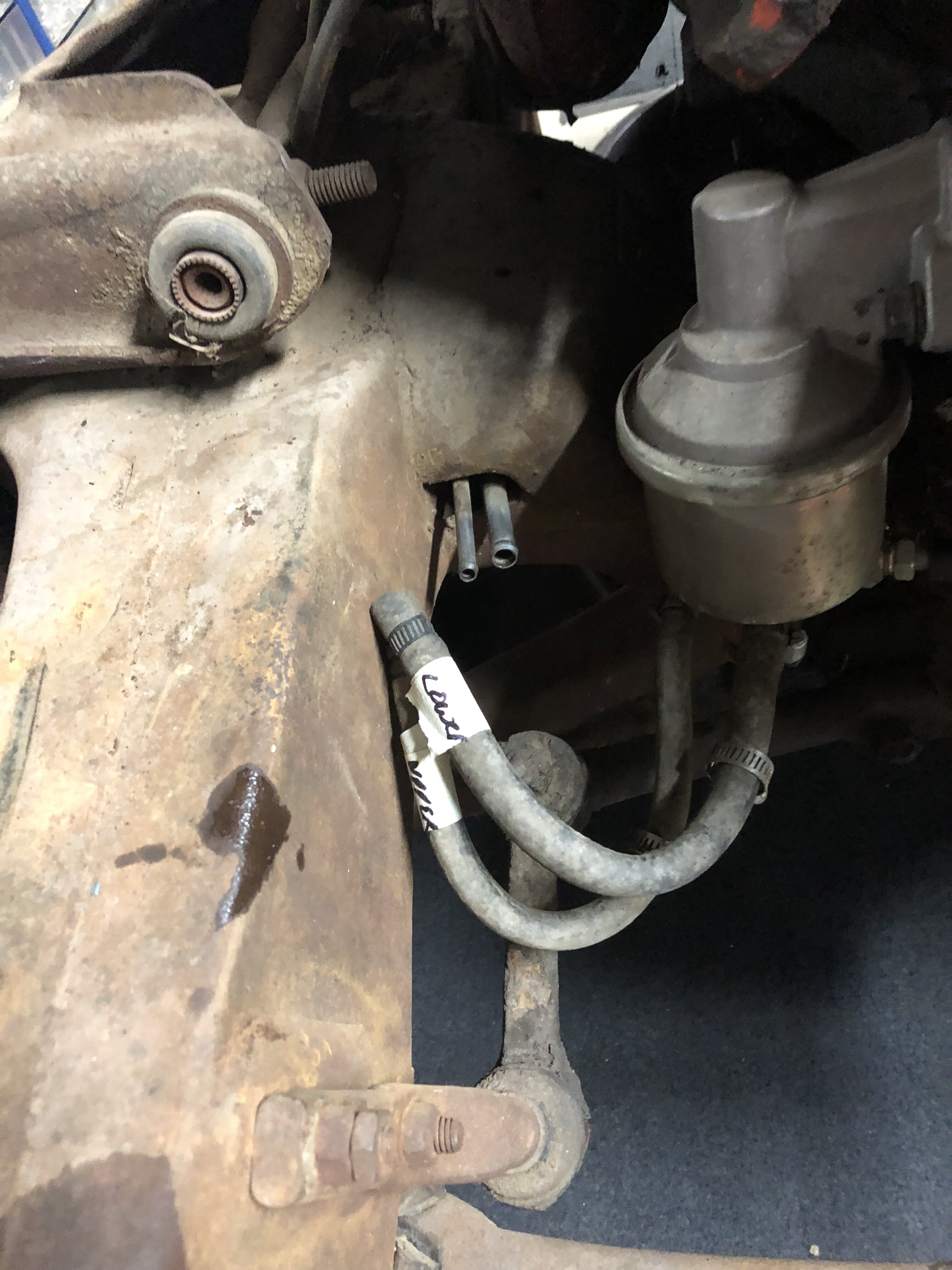

My car has (I believe) Prothane bushings in the control arms. But I’m missing the front bushing on the passenger side. Not only that, I’m missing the cap, lock washer, and bolt too! The other three bolts/bushings were loose. I will tighten those ones. My problem is Prothane only sells the bushings in kits that include all the bushings for the control arms. But the assistant from Prothane couldn’t seem to tell me if the kit includes the cap. I can get a bolt and lock washer from any hardware or parts store, but I need the cap. The assistant said “the kit includes shells.” Are the shells the “caps” I’m referring too? 2D3608A7-3D0C-4871-B8F1-0FF55A296626.thumb.jpeg.5e625bcfcaaa84db46f5870664500023.jpeg6E4C73FC-74A8-41E6-BDAC-7A0366F47A5A.thumb.jpeg.0c6c1558cfad585d2ff72ac255722cbb.jpeg
Go to a scrap yard and get one off a junk car. You can buy new ones but you’re going to get four. I think gm used that “cap” for a lot of years.
Yea they don't appear to come with bushings anywhere but they are available at several places, opg says they have them in stock but I'd call first to be sure. Like Dennis said check scrap yards probably find something.
I remember this story. It happened to me. Mine was missing one from the factory ( I’m guessing)
So, I talked to my parts guy. He’s ordered me a stock bushing. We’ll see if it fits. Better than no bushing lol. I got a couple wrecking yards in my area too, so if the stock bushing doesn’t come with a cap or if my Chevy dealer can’t get me one, I’ll definitely go scrap-yard hunting! You guys are awesome, and I greatly appreciate you helping steer me in the right direction! 👍🏼
You will have to remove the empty shell from the control arm for the stock one to fit and it does not come with the outer washer, lock washer or bolt. Sorry. 😞
