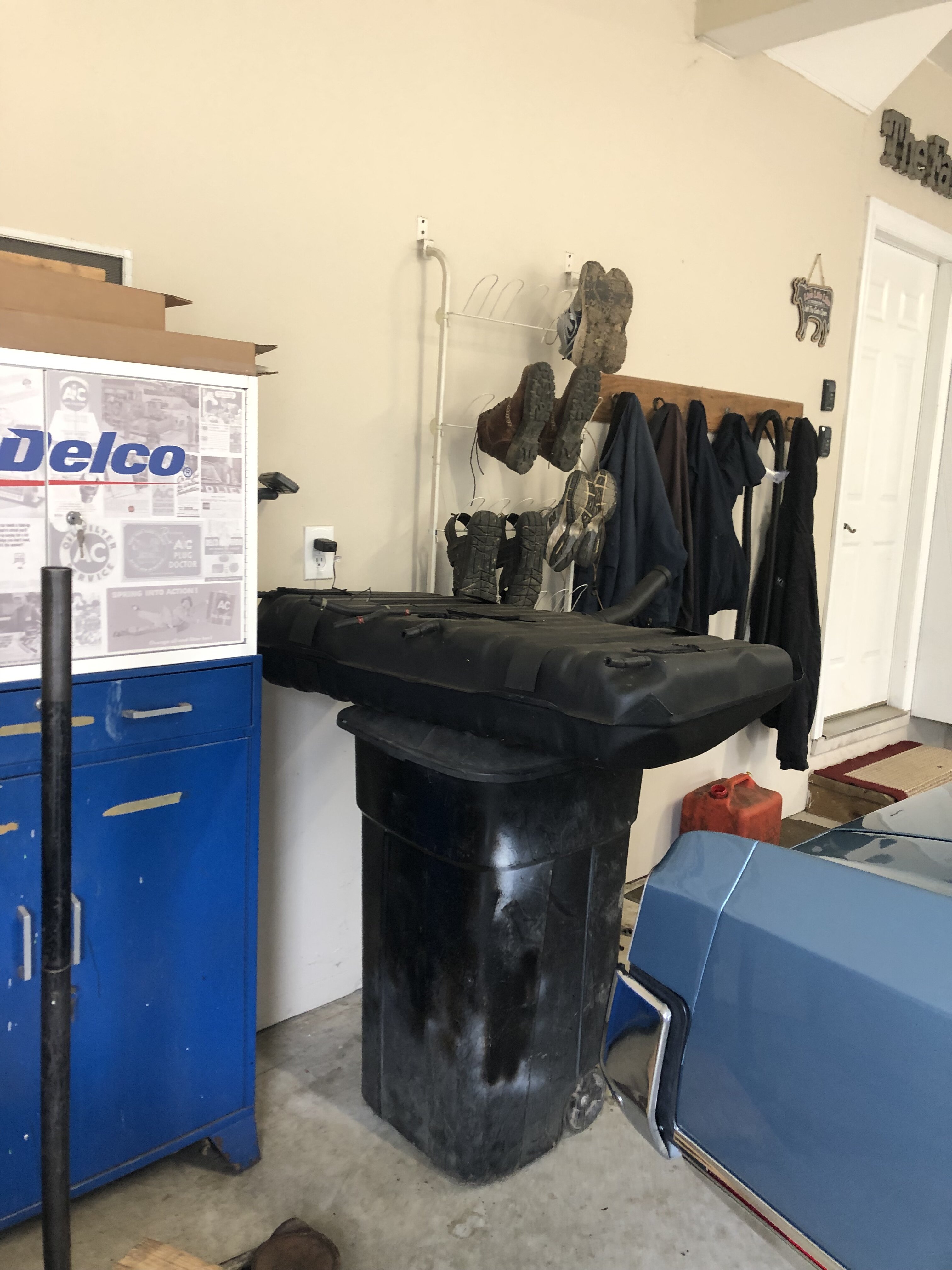

IMG_20220313_091641625.thumb.jpg.395abec4b3a76e58f57bb7a3d2f7c0f5.jpgI just assumed that the fuel lines were routed on a Monte just like they were on a Chevelle. Then I came across four lines at the front of the gas tank that look like they're routed way different than a Chevelle.
Why 4 lines??
Behind the back seat the is an emission vapor tank (?).probably not one of gm’s better ideas. lol  The two main lines off the sender are just like the chevelle.
I think the 2 middle go to the fuel gauge in the tank and the 2 ends are connected to the nipples at the ends of the tank. If i remember correctly there are 2 nipples one on each side of the tank itself and then the other 2 are connected to the fuel gauge. But not sure, i will check my manual later tonight for you. Maybe someone else will chime in that has a better memory than I.
Not the best picture ( not taken for this reason.  You can see all the lines on the tank. Blow it up. Not literally, there is fuel in there. Lol.
Good pic Dennis!     Thank You   See and i thought my memory is slipping!!   Ohh it is!!   LOL
And Welcome to the Club Lou if i havent said so before!!!
This must be on a'72? Mine has the 4 lines. You do have the canister filter up front,correct? 2 lines each end of tank( go to expansion tank behind seat) .then main line and a return line. Replaced all my lines with Inline tube stainless in 2004. Hope this helps you. I'm thinking '71 the same.They also have a center fuel cap. Should have no pressure built up when removing gas cap.post-259-0-06116300-1484180397_thumb.jpg

Thanks for the answers.
