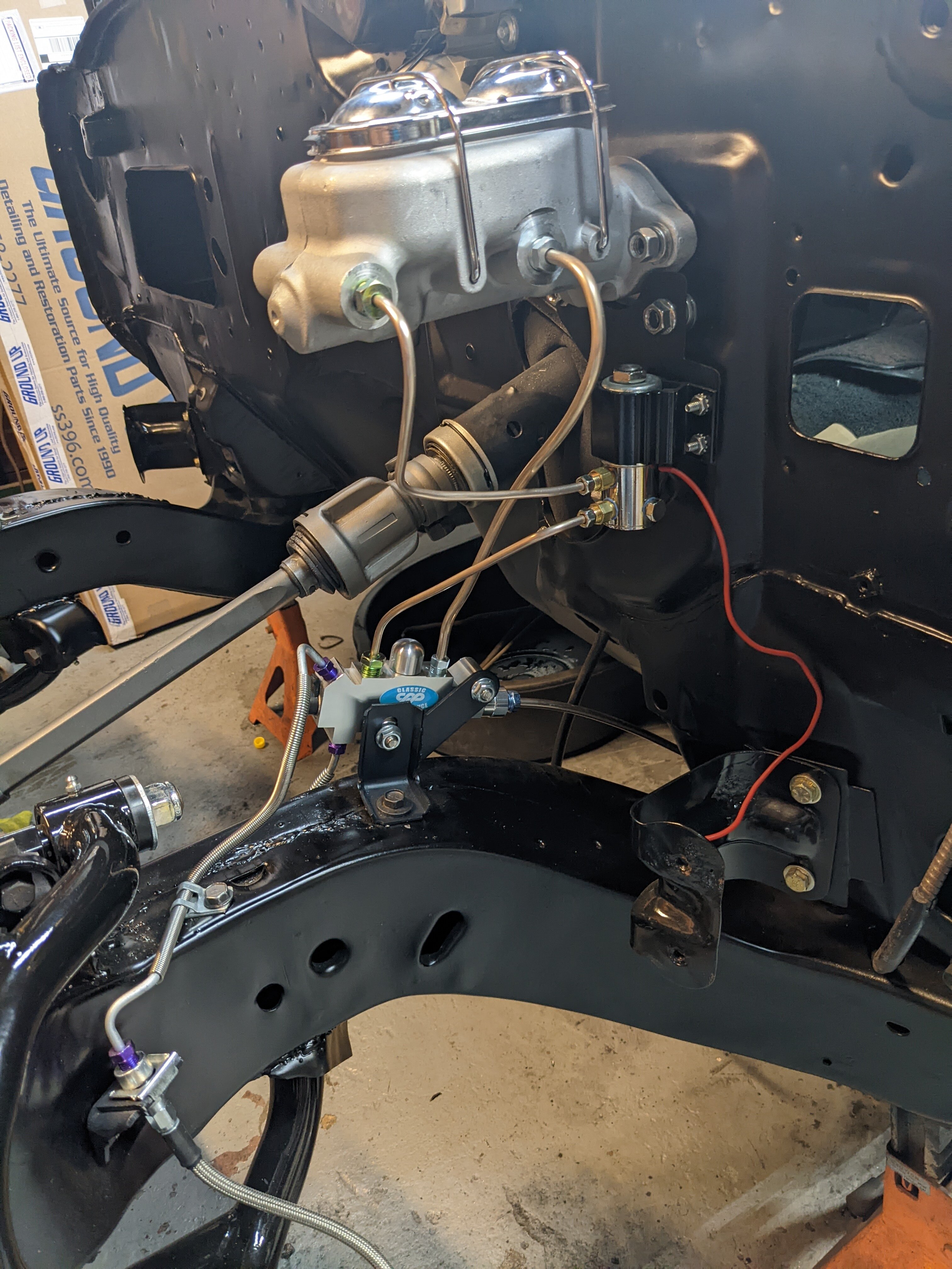

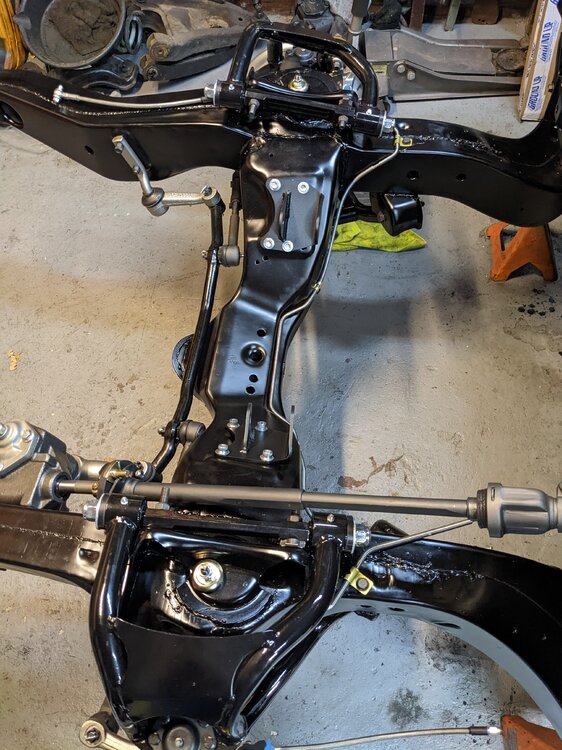

MC1of80 Posted April 6, 2022 Posted April 6, 2022 On my son's pro street 70 Monte we used a combo of inline pre bent brake lines and we made a few. I used this kit from Amazon. Double flaired with no issues. Quote
jft69z Posted April 7, 2022 Posted April 7, 2022 1 hour ago, Lou said: I've read a lot about some of the alloys being so soft they're hard to get a good flare. Especially 3/16th. I've made lines out of stainless, steel, copper, copper-nickel, monel, etc. All sizes, single flare, double flare, 37 degree, 45 degree, etc., never had problems. Don't let what you read scare you, who knows what that person did wrong, or what type of experience/equipment they had. Just like some of the reviews you see on amazon, home depot, etc....some people don't have a clue what they're doing, then post negative reviews about the product/tool. If you decide to do it yourself, you should order the stainless spring coil to slip over the tubing, makes it look OEM and offers some protection as well. 1 Quote

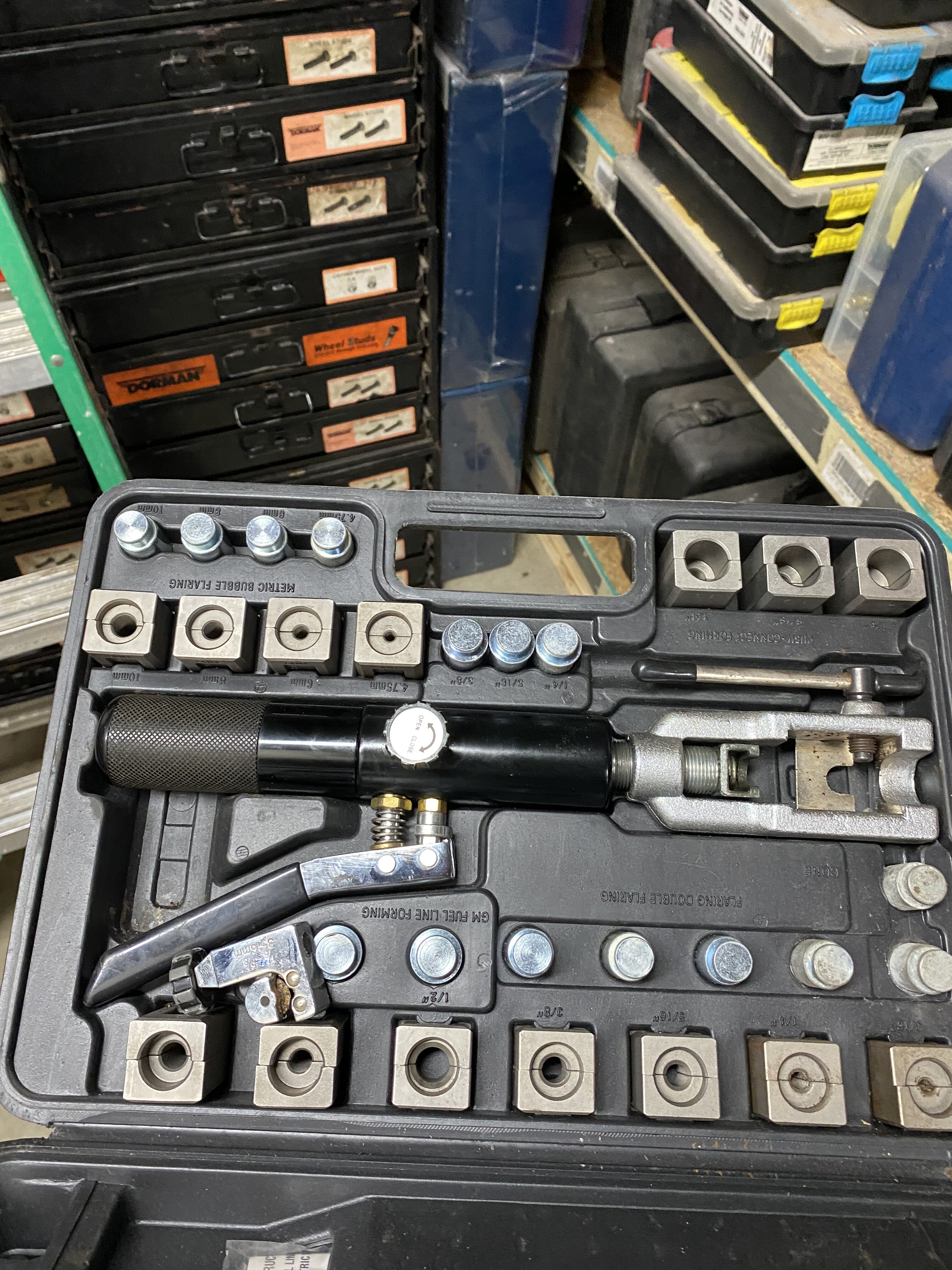

Dtret Posted April 7, 2022 Posted April 7, 2022 I agree with what was said. Quality tools and materials are key if you decide to do it yourself. These are the products that I have used with great results. I got lucky on my 71 and didn’t have to use them ( originals were all perfect, love California cars). The 37 degree flares don’t come in the kit, I purchased separately, but you probably won’t need them. 1 Quote
jft69z Posted April 7, 2022 Posted April 7, 2022 52 minutes ago, Dtret said: I agree with what was said. Quality tools and materials are key if you decide to do it yourself. These are the products that I have used with great results. I got lucky on my 71 and didn’t have to use them ( originals were all perfect, love California cars). The 37 degree flares don’t come in the kit, I purchased separately, but you probably won’t need them. Yep, quality tools are key. I have the same Mastercool set, plus picked up the 37 degree dies as well. SUR&R makes a real nice flaring tool as well that clamps in a vice, even easier than the Mastercool tool, I got the 37 degree dies for that one too. I'm at work, this is an internet pic of the SUR&R tool: Quote
