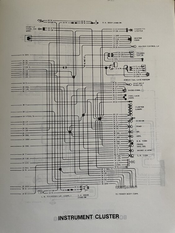

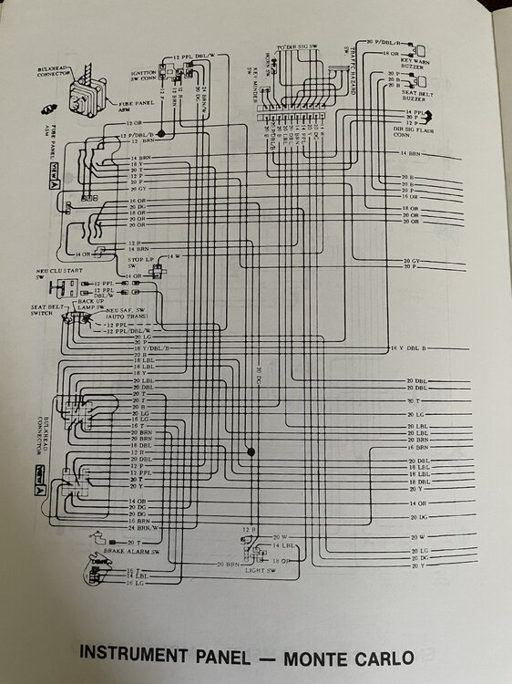

1970mcss Posted April 23, 2022 Posted April 23, 2022 A wiring diagram would be a good place to start. I believe the yellow black and grey are foe the radio. The green and black maybe speakers. Should have nothing to do with the dash lights. Did you check the ground at the dash? Did the dash light ever work? 1 Quote
Lou Posted April 23, 2022 Author Posted April 23, 2022 I did not check for ground at dash. I have wiring diagrams but thy might as well be in Portuguese. I guess it's about time to learn a new language.😒 Quote
