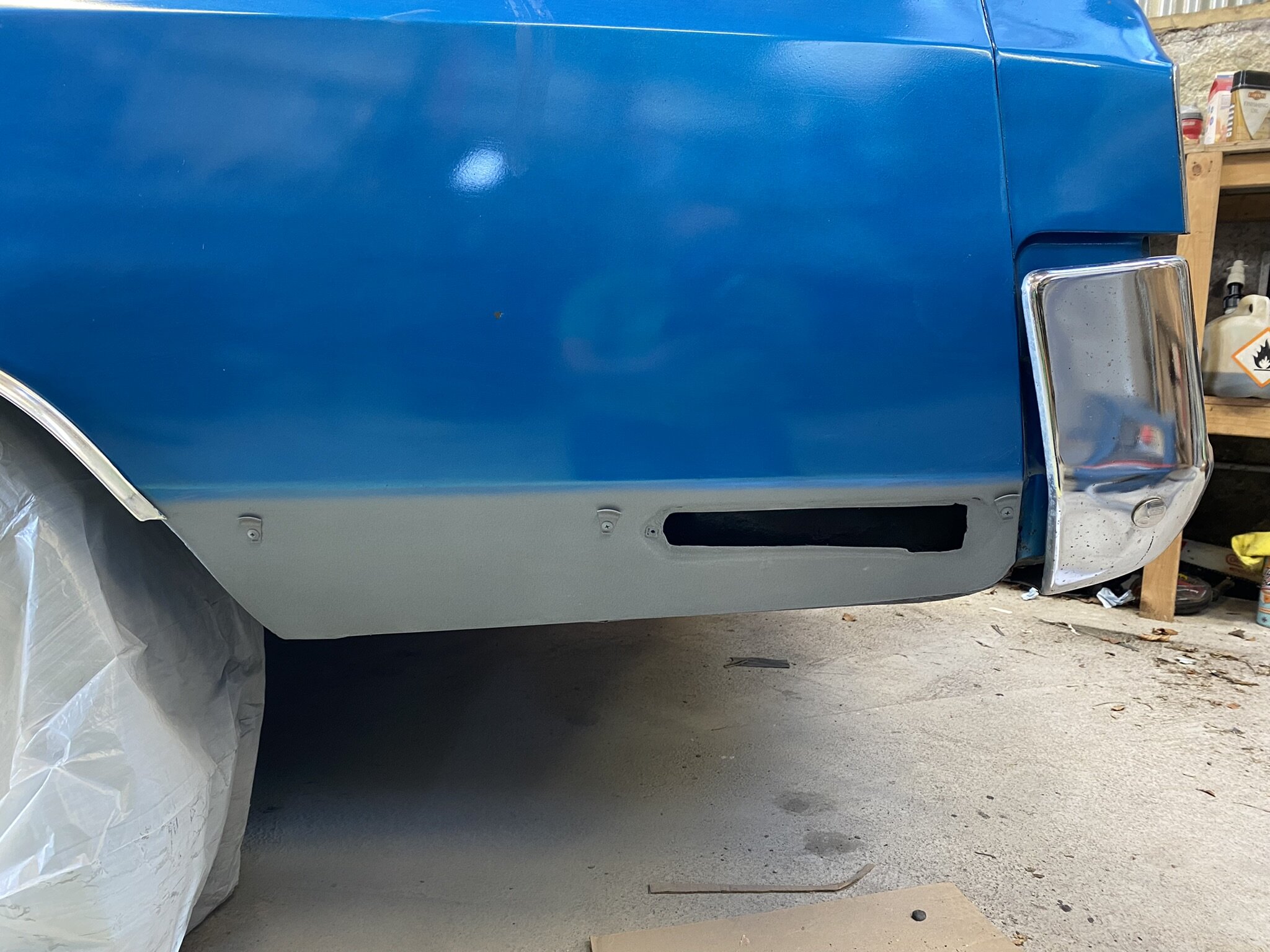

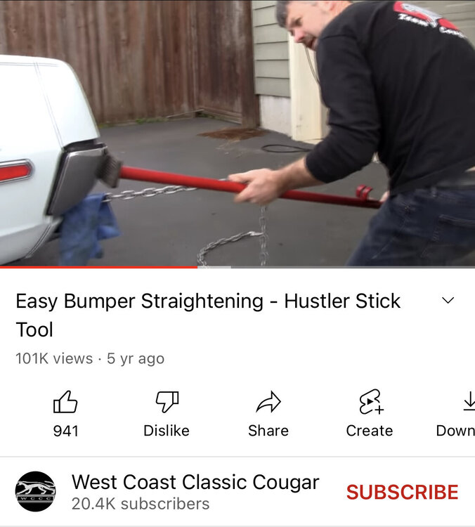

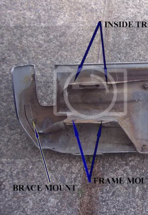

Crom Cruach Posted May 1, 2022 Posted May 1, 2022 Hi Folks, I’m getting a new dual exhaust system fit to the manifold next week, so I want to straighten my rear bumper before they are fit. From searching the forum I think I need to loosen the very edge bolt and then just use force to twist it correct. Bit nervous about the twisting part! Is it the brace mount that needs to be loosened (as per photo)? Are you guys using a ‘hustler stick’ to move the bumper, or a DIY tool, or what? Quote
Dtret Posted May 1, 2022 Posted May 1, 2022 I’m assuming the other side is the way you want it ? That doesn’t look like a big problem. Try loosening the 4 bolts and that side and see if it will twist. For as big as them bumpers are they are pretty flexible. 2 Quote
Crom Cruach Posted May 1, 2022 Author Posted May 1, 2022 sorry no Dennis the other side is the same. I will try that Quote
Dtret Posted May 1, 2022 Posted May 1, 2022 That’s actually a good thing. That hopefully means the bumper is not bent or twisted. You should be able to adjust that to where you want it. Quote
jft69z Posted May 1, 2022 Posted May 1, 2022 Those corner end pieces can be moved around a little by yanking on them, if you run out of adjustments with the mounting bolt holes. Seems a lot of times someone bumped into something along the way & bent them in, etc. Don't be alarmed if you need to give it a pull to get the final straightening, they move around pretty easy. Quote
Crom Cruach Posted May 1, 2022 Author Posted May 1, 2022 Thanks guys. Are y’all using proper tools for this or just a chain attached to some 2x4? Or possibly reversing slowly into something not too scrapy? 😨 Quote
Scott S. Posted May 1, 2022 Posted May 1, 2022 I went through the same problem on the same corner.... Must be a blind spot on the left rear ? It was still bent after I got it back from the body shop. What I used was a 24" pipe wrench and wrapped the jaws with lots of rags and tape. You have to be VERY careful how you position the wrench, and do your adjusting in small increments to make sure you don't go to far. 2 Quote

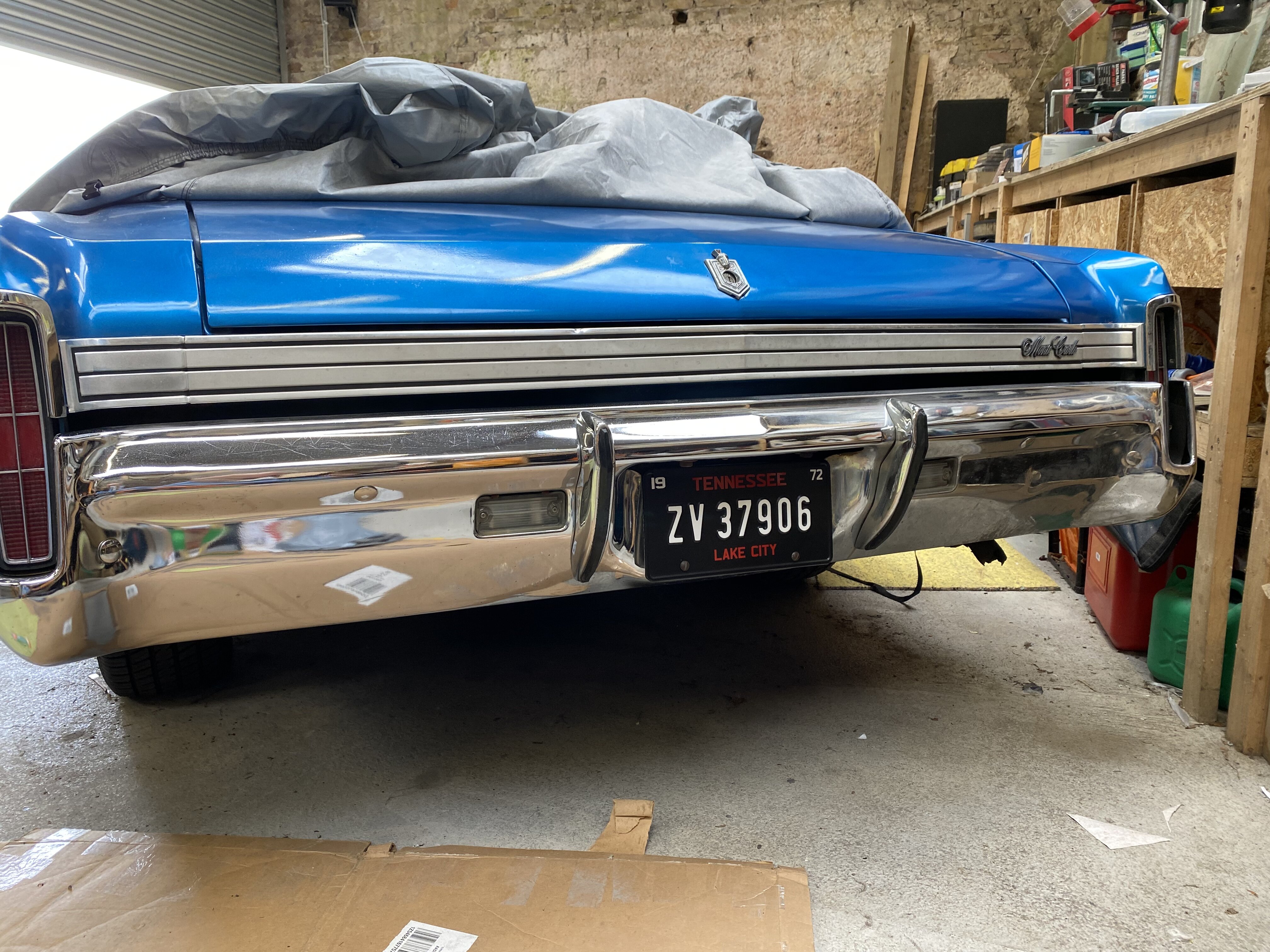

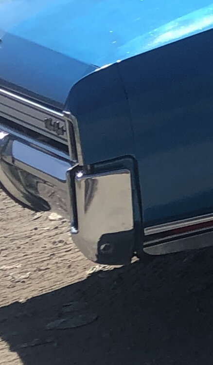

Crom Cruach Posted May 2, 2022 Author Posted May 2, 2022 3 hours ago, jft69z said: I just tugged on the rear corners by hand, it bent pretty easy. I was thinking of moving the whole bumper to tighten up the gap across the whole length of the trunk lid, how does the gap look… Quote
jft69z Posted May 2, 2022 Posted May 2, 2022 2 hours ago, Crom Cruach said: I was thinking of moving the whole bumper to tighten up the gap across the whole length of the trunk lid, how does the gap look… Yes, as stated earlier, adjust the bumper to the best position allowed by the available range of all the mounting bracket bolt holes, then if the ends/corners look a little off, give them a tug if necessary. Sometimes they were pushed in too close to the body, or whacked while someone backed into something so that the vertical leading edge isn't parallel to the quarter panel body line, as in your earlier pictures. Adjust first, bend second if needed. 1 Quote
Scott S. Posted May 2, 2022 Posted May 2, 2022 Keep in mind that raising the bumper will effect the spacing around the tail lights...... might throw off the vertical balance a bit. Quote
